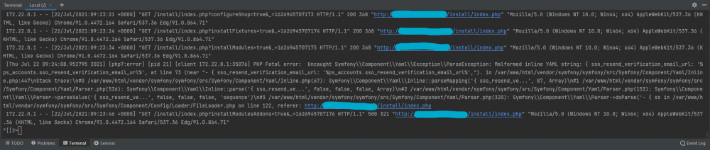

Erwan Martin Posted July 22, 2021 Share Posted July 22, 2021 Hello, i'm trying to install Prestashop on a custom docker container, but every time i try, i get a 500 error during addon module install, my docker image looks like this : FROM php:7.1.33-apache RUN docker-php-ext-install mysqli pdo_mysql RUN apt-get update \ && apt-get install -y libzip-dev \ && apt-get install -y zlib1g-dev \ && rm -rf /var/lib/apt/lists/* \ && docker-php-ext-install zip \ && docker-php-ext-install opcache RUN apt-get update && apt-get install -y libpng-dev RUN apt-get install -y \ libwebp-dev \ libjpeg62-turbo-dev \ libpng-dev libxpm-dev \ libfreetype6-dev RUN docker-php-ext-configure gd \ --with-gd \ --with-webp-dir \ --with-jpeg-dir \ --with-png-dir \ --with-zlib-dir \ --with-xpm-dir \ --with-freetype-dir \ --enable-gd-native-ttf RUN apt-get -y update \ && apt-get install -y libicu-dev \ && docker-php-ext-configure intl \ && docker-php-ext-install intl RUN docker-php-ext-install gd RUN sed -i 's/www-data:x:33:33/www-data:x:1000:1000/' /etc/passwd RUN a2enmod rewrite COPY ./php-custom.ini /usr/local/etc/php/conf.d/docker-php-memlimit.ini I can't change my php version for some reasons. I'm running docker on windows with wsl2 integration. I've tried to change the permissions of install dir and index to 755, i've also tried the same installation on wamp, and get the same error 500. (the screenshot bellow). I don't think that's a database issue because the connection work (on docker or wamp) and the database is created and filled. the access log of the errors are bellow : I've tried with this archive https://github.com/PrestaShop/PrestaShop/releases/download/1.7.3.0/prestashop_1.7.3.0.zip . (I also tried with the source code from github but i get a composer error that says that composer.json doesn't match json regex) Thanks for reading me, and sorry for my bad english, i hope you understand ! Link to comment Share on other sites More sharing options...
ComGrafPL Posted July 23, 2021 Share Posted July 23, 2021 Check the folders and files permissions. Set 775 / 644. Link to comment Share on other sites More sharing options...
Erwan Martin Posted July 23, 2021 Author Share Posted July 23, 2021 57 minutes ago, ComGrafPL said: Check the folders and files permissions. Set 775 / 644. I've already checked file / folder permissions, and i still have the same 500 error find . -type d -exec chmod 0755 {} \; find . -type f -exec chmod 0644 {} \; 1 Link to comment Share on other sites More sharing options...
TobikSoft Posted September 14, 2021 Share Posted September 14, 2021 Definitely something with permissions Try to overwrite the owner to www-data (add following at the end) RUN chown -R www-data:www-data /var/www/html or use the official Prestashop docker images https://hub.docker.com/r/prestashop/prestashop Link to comment Share on other sites More sharing options...
ComGrafPL Posted September 14, 2021 Share Posted September 14, 2021 Try 775 on folders not 0755 Link to comment Share on other sites More sharing options...
