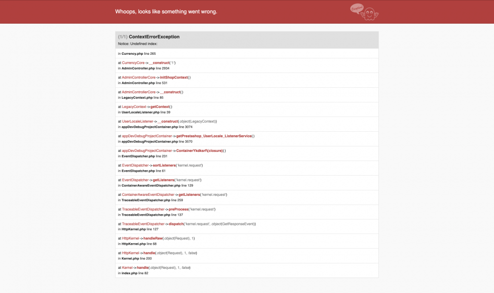

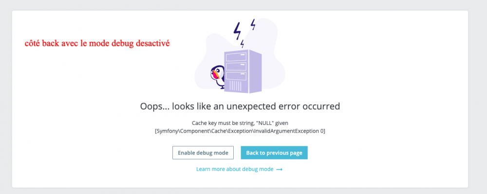

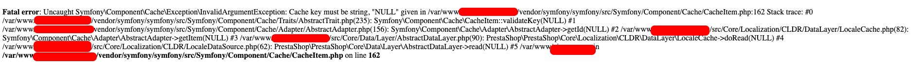

JoJo! Posted July 22, 2021 Share Posted July 22, 2021 Good morning all, I end up with a symfony error in front and back without changes, nor module installation. Is this a server error? I dry a bit .. I tried to empty the var / cache folder, but nothing helps .. We are on a Prestashop 1.7.7 - PHP 7.2 - Apache 2 - Ubuntu Thank you all in advance ! Link to comment Share on other sites More sharing options...
SmartDataSoft Posted July 22, 2021 Share Posted July 22, 2021 Hello, You can check your cache folder permission is the permission is ok? secondly, try to force compile the template file from performance. It seemed that cache key is null here. you can change the php version to upper which version 1.7.7 work thank you Link to comment Share on other sites More sharing options...
JoJo! Posted July 22, 2021 Author Share Posted July 22, 2021 Hello Cache folder permission : 777 "try to force compile the template file from performance": I do not have access to the back office How can I do otherwise? In php 7.3; do not change anything Thanks for your answer Link to comment Share on other sites More sharing options...

SmartDataSoft Posted July 22, 2021 Share Posted July 22, 2021 The error indicate that it comes from Currency.php 265 no line. Is your site any currency was enable or some how accidental that value is removed from database. can you check Thank you Link to comment Share on other sites More sharing options...
