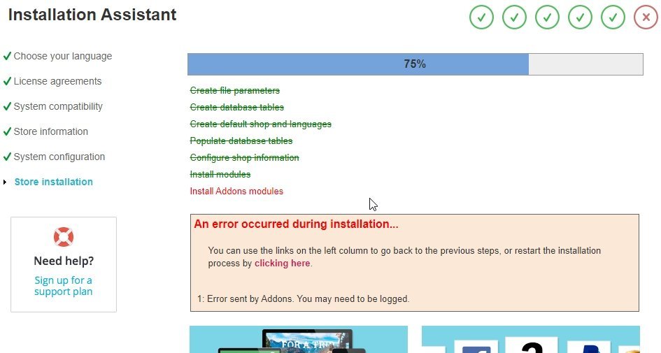

jerico.bd Posted July 21, 2021 Share Posted July 21, 2021 I want to install prestashop 1.7.7.5 in my local host But every time I can't do that. I got following error massage . How can I solve it ?? Link to comment Share on other sites More sharing options...
SmartDataSoft Posted July 21, 2021 Share Posted July 21, 2021 @jerico.bd This is a strange issue. occure at the time of PrestaShop installation. You will notice if you go front end the full installation is done. At this stage it failed to install addons from PrestaShop addons that is why it made a error. Thank you Link to comment Share on other sites More sharing options...
ComGrafPL Posted July 21, 2021 Share Posted July 21, 2021 1 hour ago, jerico.bd said: I want to install prestashop 1.7.7.5 in my local host But every time I can't do that. I got following error massage . How can I solve it ?? You could check folders / files permissions and set it to: Folders: 775 / files: 644 Link to comment Share on other sites More sharing options...
Danny Posted July 23, 2021 Share Posted July 23, 2021 Check if you did this: - Download the version you want to install - Uncompress the archive on your pc - Do not uploaded the Zip file directly to your web server. - Check inside (configuration) FileZilla FTP how files will be considered/transfered (Automatic mode/binary mode and that file beginning with "." (dot like .htaccess) considered as ASCII then check if it could be a SSL problem... change both the parameters in the SQL database to 1 PS_SSL_ENABLED PS_SSL_ENABLED_EVERYWHERE OR eventually decrease your php version (lower than 7.2) and try again. Hope could help someone. Danny Hope could help someone. Danny Link to comment Share on other sites More sharing options...
