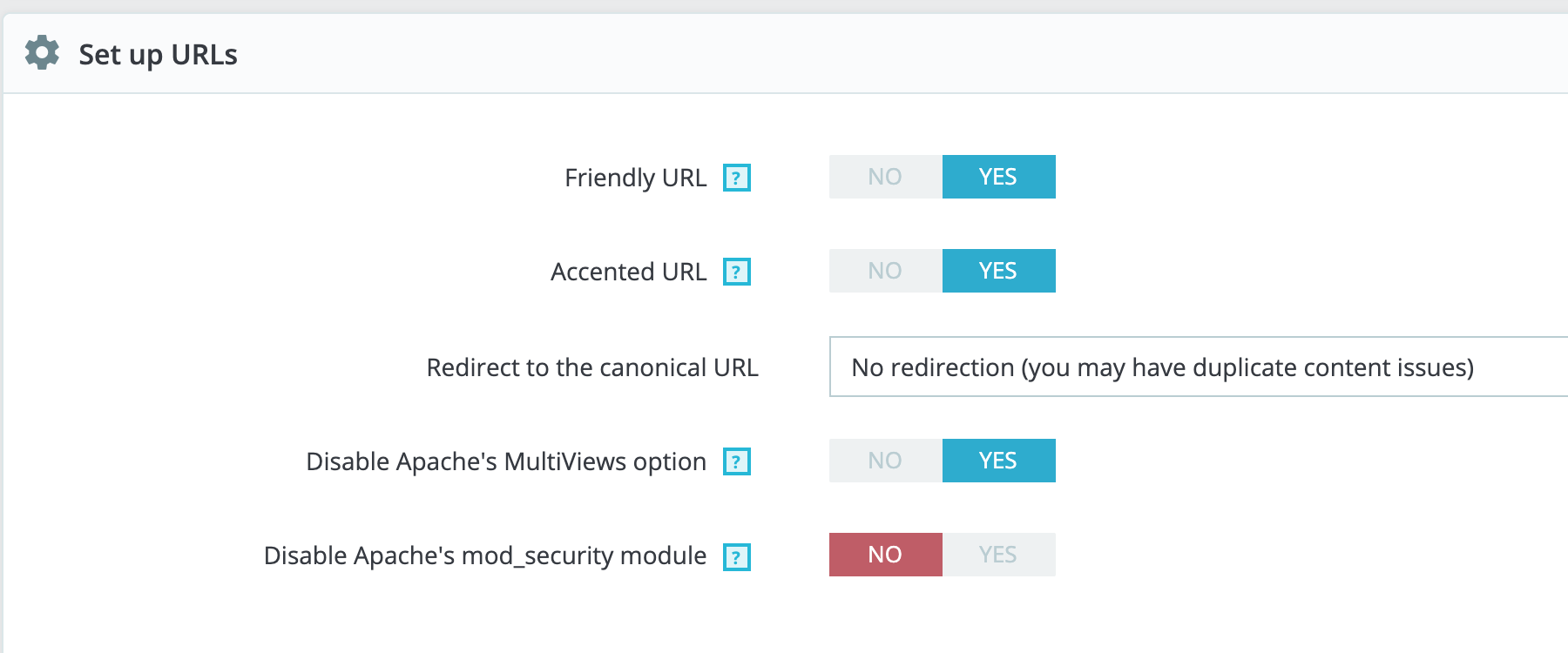

J.Andrade Posted July 9, 2021 Share Posted July 9, 2021 Hi, I have a problem. I installed a copy of prestashop from the previous site in a different folder. I changed the URL to the new domain in Traffic and SEO, then I went to test it and when I click on my store it resets to the old site. I went straight to the Database to verify this is all correct. I already cleaned the cash and nothing. Link to comment Share on other sites More sharing options...
J.Andrade Posted July 10, 2021 Author Share Posted July 10, 2021 Thank you so much for trying to help me. I did the procedure as you mentioned, but it didn't work. so I took a look at SEO and URLs with great patience. Setting URLs /Redirect to canonical URL I changed to: no redirect and it worked. Even so, I'm very grateful for trying to help. He left this information here for anyone who has a similar case. Thank you very much. Link to comment Share on other sites More sharing options...
J.Andrade Posted July 10, 2021 Author Share Posted July 10, 2021 6 horas atrás, Crezzur disse: Delete the .htaccess and regenerate it by disabel and enable your friendly url. or Modify your .htaccess so it uses the correct urls from your new shop. Use CTRL+F5 to clear your browser cookies our visit your site in incognito modus. Thank you so much for trying to help me. I did the procedure as you mentioned, but it didn't work. so I took a look at SEO and URLs with great patience. Setting URLs /Redirect to canonical URL I changed to: no redirect and it worked. Even so, I'm very grateful for trying to help. He left this information here for anyone who has a similar case. Thank you very much. Link to comment Share on other sites More sharing options...
J.Andrade Posted July 10, 2021 Author Share Posted July 10, 2021 6 horas atrás, Crezzur disse: Exclua o .htaccess e gere-o novamente desmarcando e habilitando seu url amigável. ou Modifique seu .htaccess para que ele use os urls corretos de sua nova loja. Use CTRL + F5 para limpar os cookies do seu navegador ou visite seu site em modo anônimo. 6 horas atrás, Crezzur disse: Exclua o .htaccess e gere-o novamente desmarcando e habilitando seu url amigável. ou Modifique seu .htaccess para que ele use os urls corretos de sua nova loja. Use CTRL + F5 para limpar os cookies do seu navegador ou visite seu site em modo anônimo. Hi, I think I was too quick. I did the previous procedure and it seemed resolved, but it works only when you enter the first page, when clicking on the product, it continues redirecting to the old site. Can you tell me how I generate this .htaccess file? I did the procedure renaming the file and creating a new one, but I don't know what codes I can add. Link to comment Share on other sites More sharing options...
