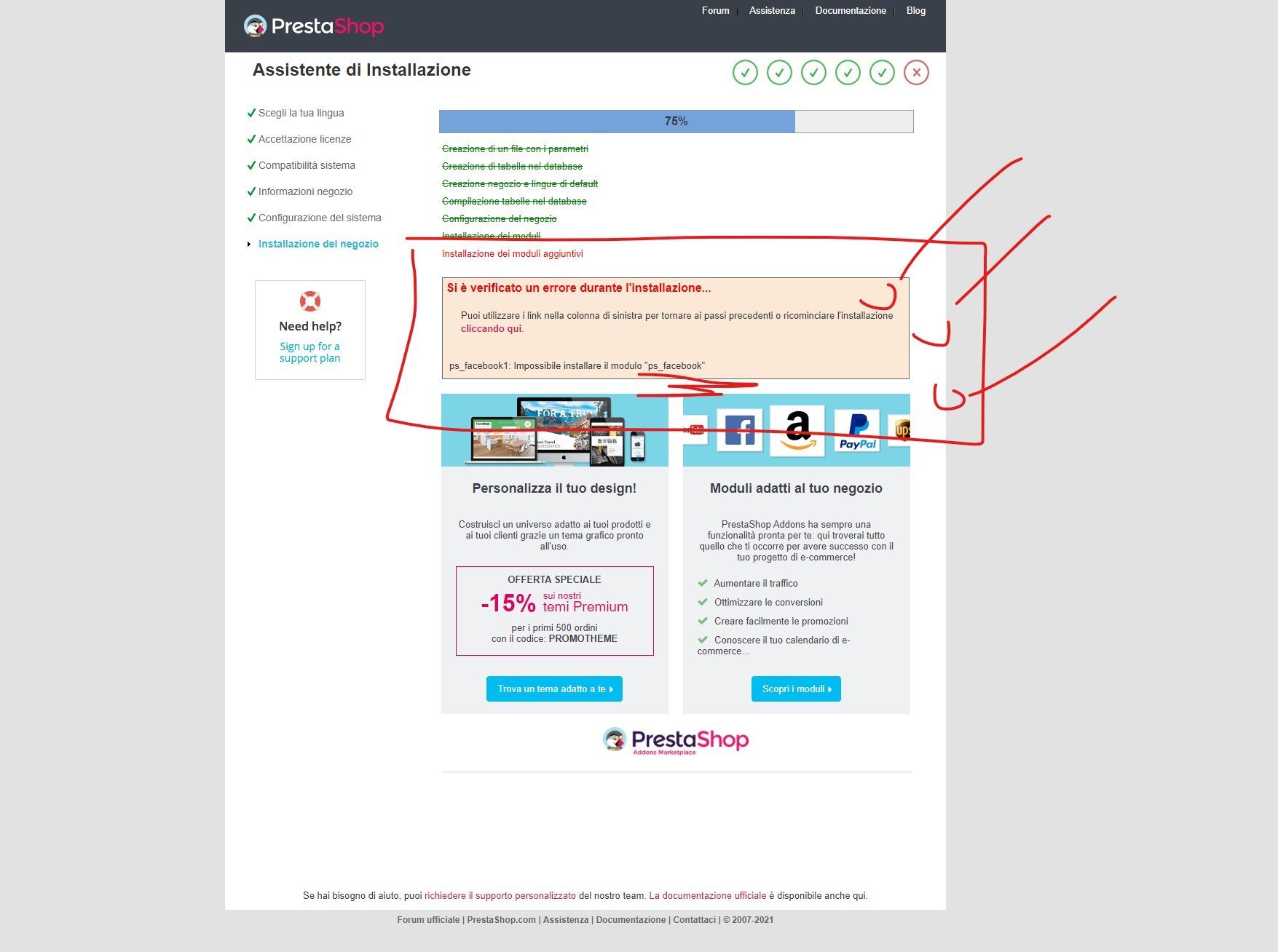

LeandroCMH Posted July 2, 2021 Share Posted July 2, 2021 Good morning, i am a developer and i also have the same problem since yesterday There seems to be some problem during the installation phase of the facebook add-on We have installed many prestashop e-commerce stores and such a thing has never happened Even installing previous versions of prestashop you get the same problem You should contact the developer of the facebook module to report the bug with the new version of the plugin otherwise all new installations are blocked Or you should remove this module from the installation phase which for me is useless !!!! Link to comment Share on other sites More sharing options...
LeandroCMH Posted July 2, 2021 Share Posted July 2, 2021 Attached is a screenshot of the problem Link to comment Share on other sites More sharing options...
