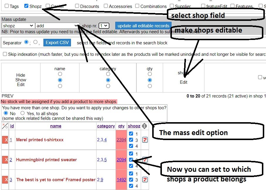

musicmaster Posted June 18, 2021 Share Posted June 18, 2021 The folder should preferably be under the admin directory. Elsewhere works too - except that you cannot use the mini-module in the backoffice. It is not clear to me what you understood. Here is a scheme: Link to comment Share on other sites More sharing options...

musicmaster Posted June 19, 2021 Share Posted June 19, 2021 2 hours ago, solopedro said: Hi, thanks a lot, I managed to reach to editable shops., however I have around 1500 records!! How can I select the three shops for all products? That is the mass edit/mass update function that was in the picture too. You choose Add with shop id 2 and all records on the page get shop 2 added. Standard there are 100 products on the page. But you can easily increase that to 500. At the end you need to click the "Submit all" button to get the changes implemented. Note that this is a paid function. So you need to buy a plugin. Link to comment Share on other sites More sharing options...

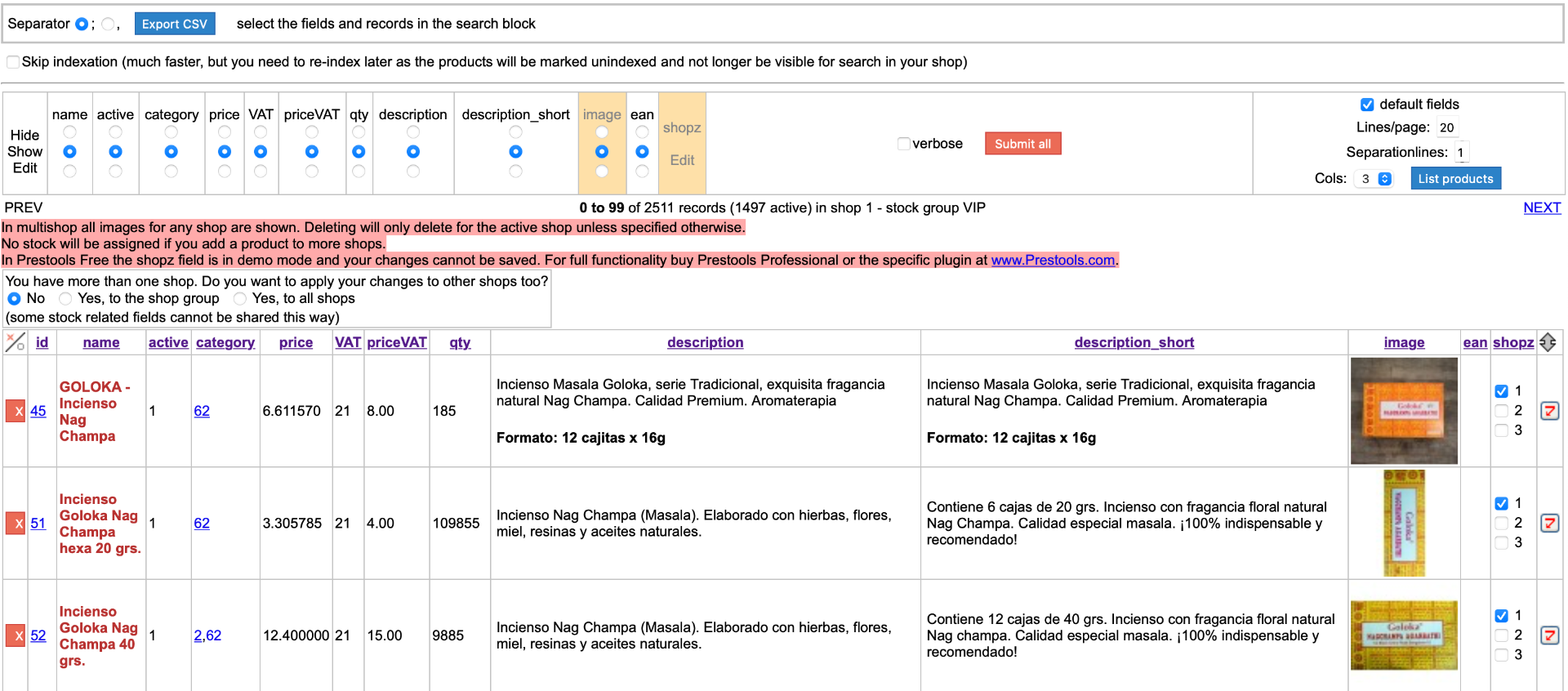

solopedro Posted June 20, 2021 Author Share Posted June 20, 2021 14 hours ago, musicmaster said: That is the mass edit/mass update function that was in the picture too. You choose Add with shop id 2 and all records on the page get shop 2 added. Standard there are 100 products on the page. But you can easily increase that to 500. At the end you need to click the "Submit all" button to get the changes implemented. Note that this is a paid function. So you need to buy a plugin. Hi Again IS this one the one I need for this task? https://www.prestools.com/prestools-suite-plugins/prestools-multishop-plugin Prestools Multishop Plugin Change which shops your Prestashop or Thirty Bees products are assigned to with this mass edit software. This is a plugin for Prestools Suite, the free tool suite for mass editing and more for Prestashop and Thirty Bees Thanks Link to comment Share on other sites More sharing options...
musicmaster Posted June 20, 2021 Share Posted June 20, 2021 24 minutes ago, solopedro said: Hi Again IS this one the one I need for this task? https://www.prestools.com/prestools-suite-plugins/prestools-multishop-plugin Prestools Multishop Plugin Change which shops your Prestashop or Thirty Bees products are assigned to with this mass edit software. This is a plugin for Prestools Suite, the free tool suite for mass editing and more for Prestashop and Thirty Bees Thanks Yes, that is the one. Link to comment Share on other sites More sharing options...
