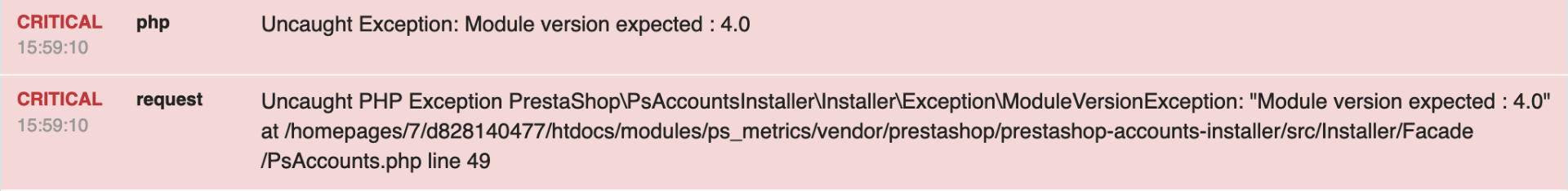

qcoupat Posted June 9, 2021 Share Posted June 9, 2021 Hello all, I have a problem regarding the backoffice on my website. On debug mode I have the below error after I enter my login and pswd to access the BO. The front is still working even though i cannot access the back. Did anyone have a similar issue regarding the PsAccounts module ? I run on ps 1.7.6.5 on php version of 7.2 Many thanks, Link to comment Share on other sites More sharing options...

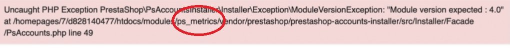

musicmaster Posted June 11, 2021 Share Posted June 11, 2021 If you look around on the forum you will see many posts about trouble with the ps_metrics module. You might consider looking for an older version or deleting it. 1 Link to comment Share on other sites More sharing options...
qcoupat Posted June 11, 2021 Author Share Posted June 11, 2021 All right - that's perfect ! thank you very much Link to comment Share on other sites More sharing options...

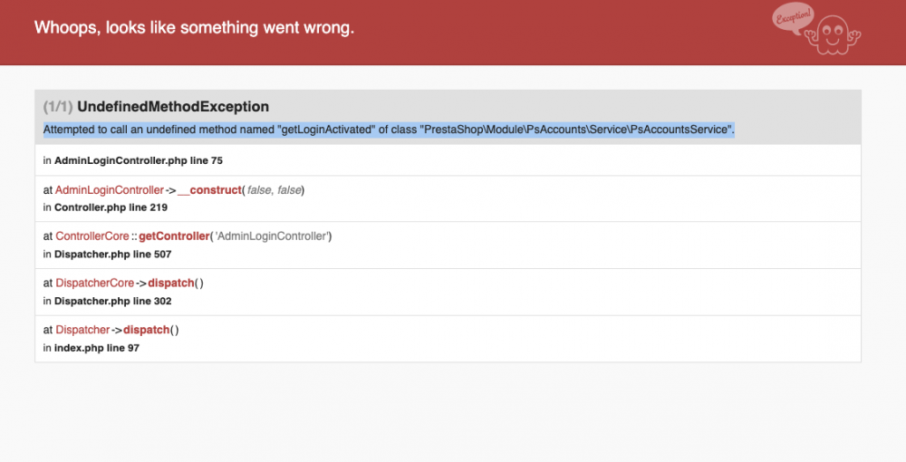

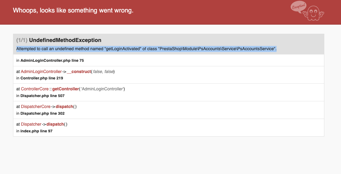

five Posted May 5, 2023 Share Posted May 5, 2023 Hello, if I can't even enter the backOffice because of ps_accounts ? I have version v5.3.6-ps_accounts with PS 1.7.6.5 and when I can't enter I don't know how to uninstall it, the error gives me: Attempted to call an undefined method named "getLoginActivated" of class "PrestaShop\Module\PsAccounts\Service\PsAccountsService". in AdminLoginController.php line 75 I tried to go to the ps_tab table that was already disabled and I try to rename the ps_accounts folder to ps_accounts_ but nothing Do you know how I can solve? Thank you Link to comment Share on other sites More sharing options...
musicmaster Posted May 5, 2023 Share Posted May 5, 2023 32 minutes ago, five said: Hello, if I can't even enter the backOffice because of ps_accounts ? I have version v5.3.6-ps_accounts with PS 1.7.6.5 and when I can't enter I don't know how to uninstall it, the error gives me: Attempted to call an undefined method named "getLoginActivated" of class "PrestaShop\Module\PsAccounts\Service\PsAccountsService". in AdminLoginController.php line 75 I tried to go to the ps_tab table that was already disabled and I try to rename the ps_accounts folder to ps_accounts_ but nothing Do you know how I can solve? Thank you You don't delete a module by manipulating the database. You delete it by physically deleting its directory under the modules directory. Link to comment Share on other sites More sharing options...
five Posted May 17, 2023 Share Posted May 17, 2023 Thank you!! Link to comment Share on other sites More sharing options...
