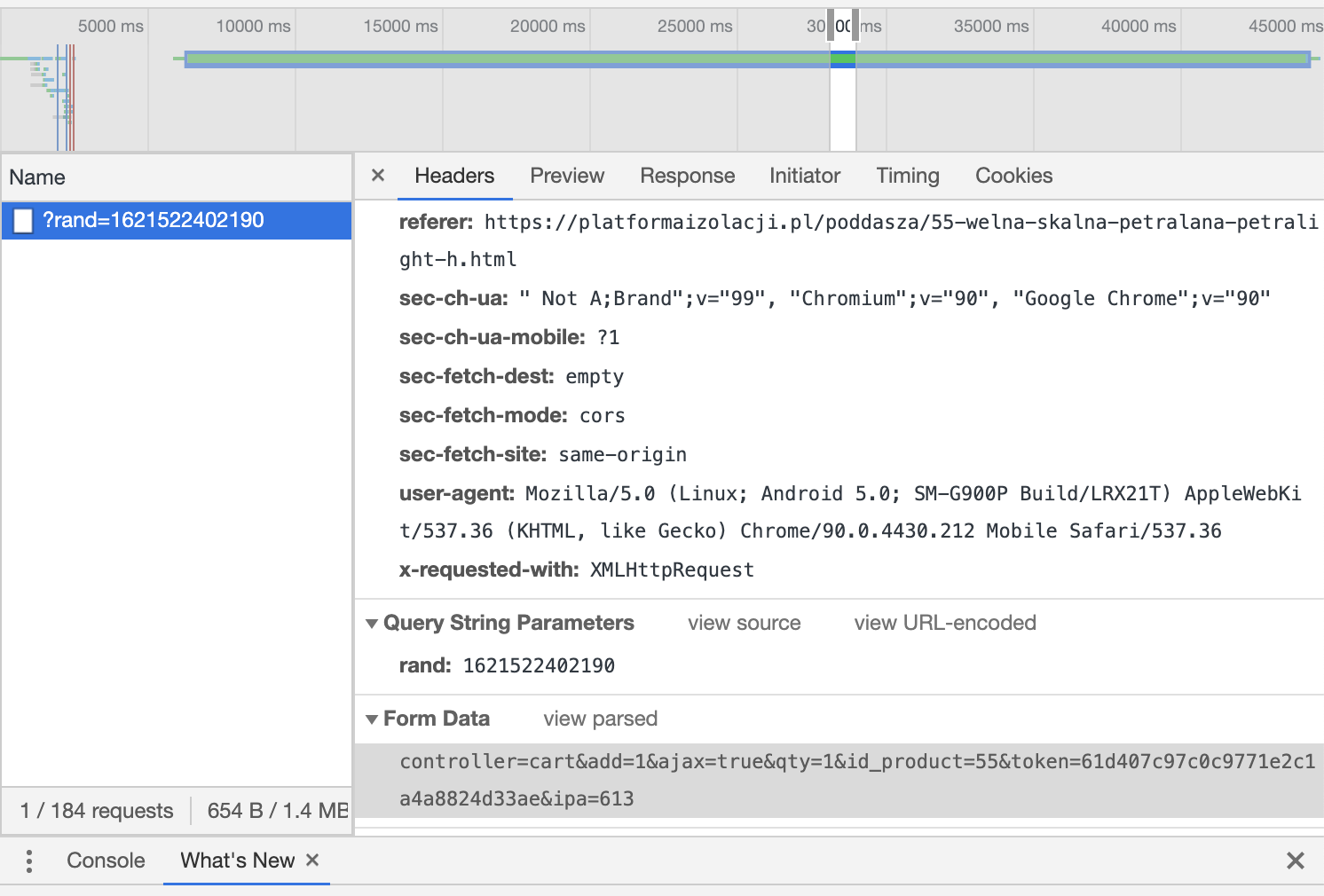

I am struggling with the problem of very long time to add a product to the cart - sometimes 1 minute.
Entering any product (example - https://platformaizolacji.pl/elewacje-wentylowane/71-welna-skalna-petralana-petravent-wv.html) and clicking "Add to cart" - the script loads very long.
I noticed in the Chrome Console it is a question of jquery question and query related files: controller:
cart add: 1
Ajax: true
qty: 1
id_product: 71
token: 61d407c97c0c9771e2c1a4a8824d33ae
ipa: 1792

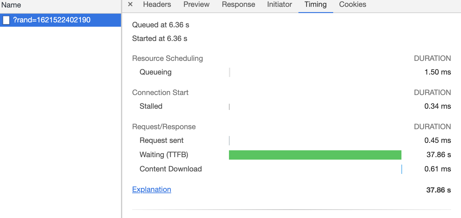

I also see that sending the query itself takes a short time (about 0.3 ms), but the reply from the TTFB server is almost 40 seconds. And here's the problem.
Has anyone encountered such a case? I would like to add that in the past, when there were a bit less products and orders in the store, it was much faster.

Please enable profiling in config/defines.inc.php. That results in all the queries show at the bottom of each page with the time they take (at the right side; you may need to scroll).
If it is the query time that causes this problem this will tell you where to look.
