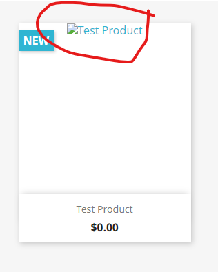

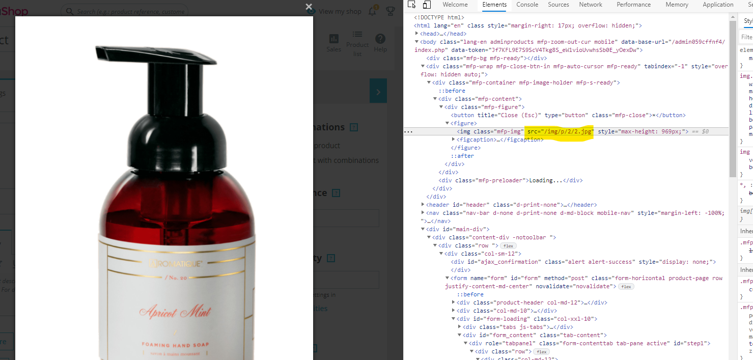

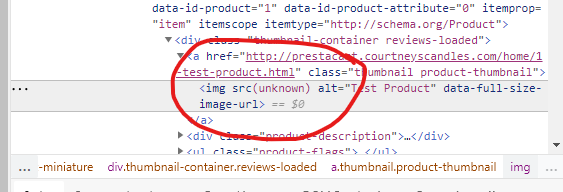

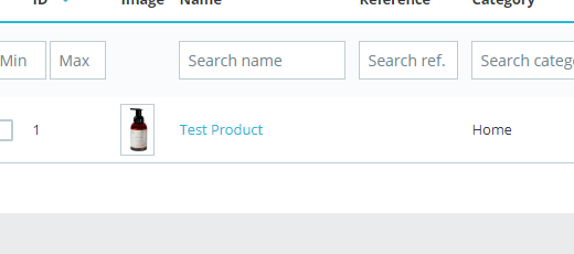

adamwall Posted May 6, 2021 Share Posted May 6, 2021 Alright, so I have been working through several posts on this and none of the answers have worked for me. I am going to share screenshots of the missing images and the inspection panel of the issue. The issue occurs in all of the customer side of the store, but in some places of the admin page it does work. This is the page the customer sees before adding to the cart, it says image source is unknown. It's the same thing for views like categories and such. All on the customer side. However, on the Admin side it is a bit different, This shows that the image from the /tmp/ directory works. This shows the 'Zoom' from the products setup and it uses the raw .jpg file that was originally added. But in the admin view when working with the description and such it shows a file name that doesn't exist. Link to comment Share on other sites More sharing options...

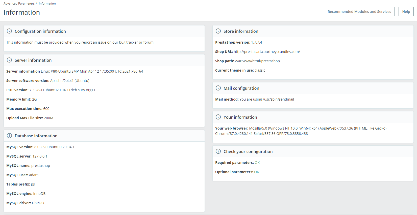

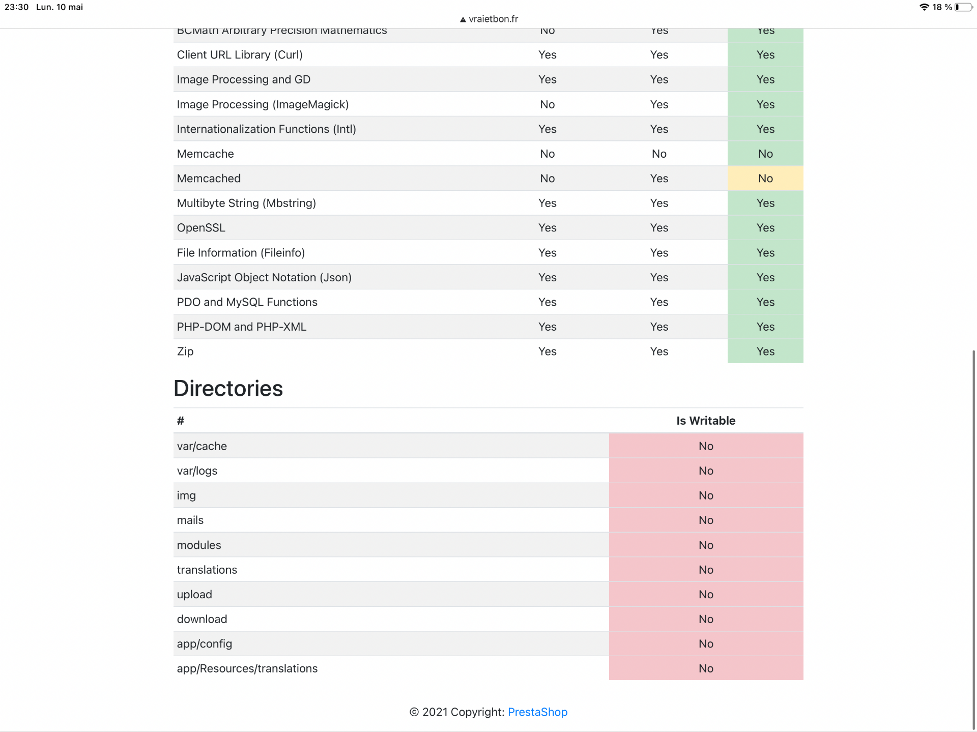

adamwall Posted May 10, 2021 Author Share Posted May 10, 2021 Is this what you are needing? Link to comment Share on other sites More sharing options...
Nickz Posted May 10, 2021 Share Posted May 10, 2021 Here you can see for you need. https://devdocs.prestashop.com/1.7/basics/installation/system-requirements/ Link to comment Share on other sites More sharing options...
adamwall Posted May 10, 2021 Author Share Posted May 10, 2021 4 hours ago, Nickz said: Here you can see for you need. https://devdocs.prestashop.com/1.7/basics/installation/system-requirements/ Thank you, after using this I was able to reinstall the product and it works as it should. 1 Link to comment Share on other sites More sharing options...

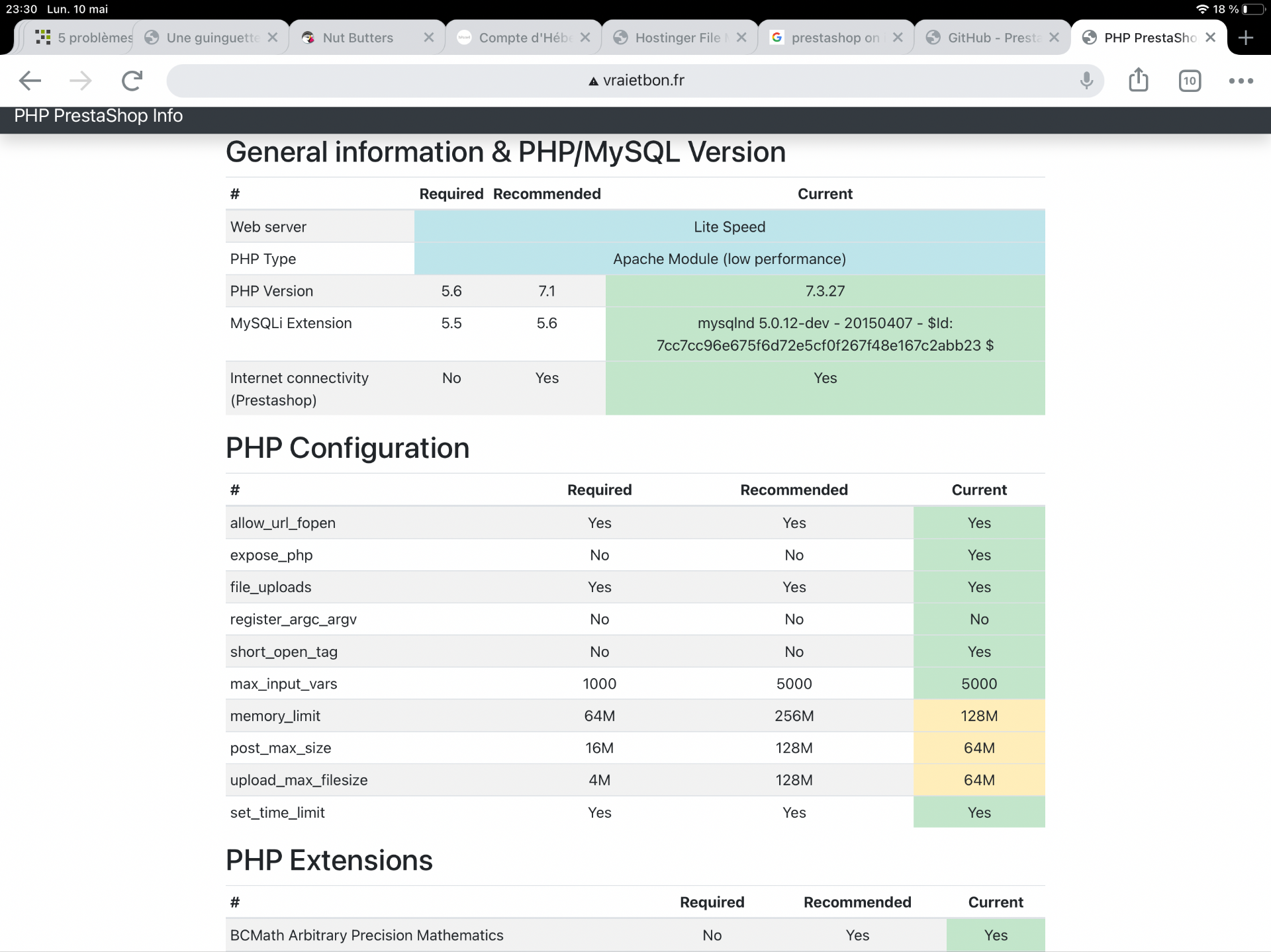

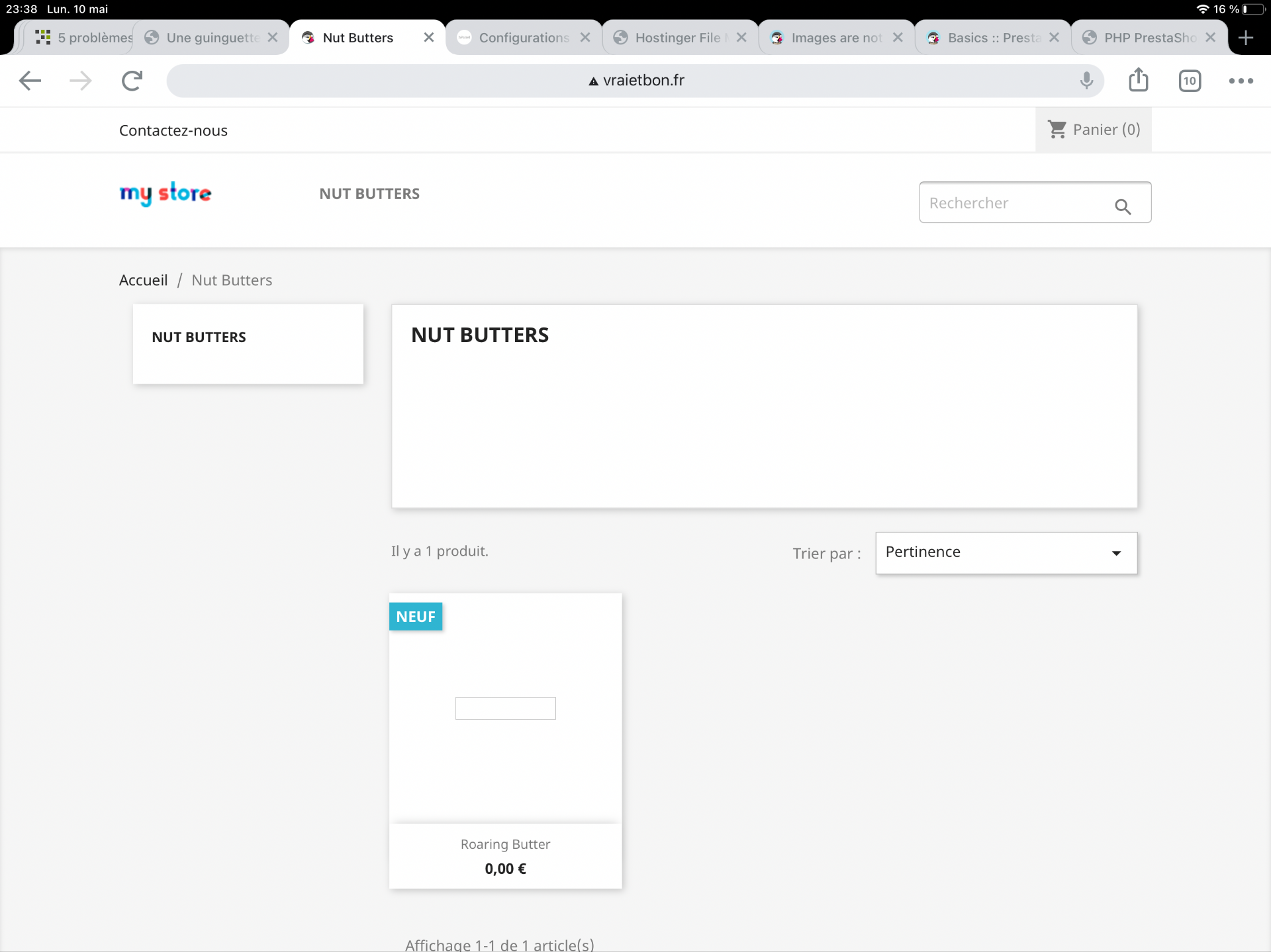

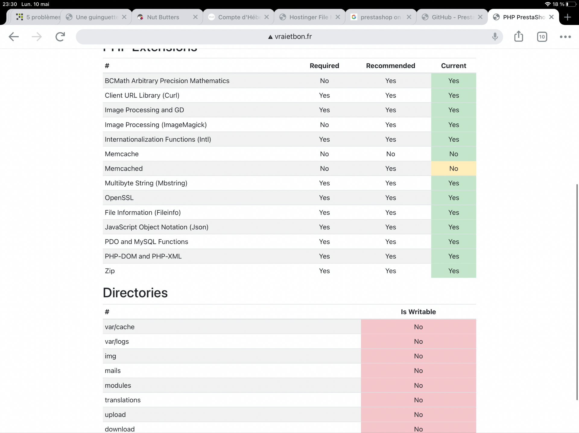

FraInBO Posted May 10, 2021 Share Posted May 10, 2021 I’m in the same pickle. Why don’t the images (product and category) ^appear ? PrestaShop 1.7.7.3. Hostinger Server. Version PHP 7.3. Link to comment Share on other sites More sharing options...
adamwall Posted May 11, 2021 Author Share Posted May 11, 2021 15 hours ago, FraInBO said: I’m in the same pickle. Why don’t the images (product and category) ^appear ? PrestaShop 1.7.7.3. Hostinger Server. Version PHP 7.3. You need to make sure that your folders are writeable and install the memcached for php. I also had to do a fresh install after everything was green to get it to work. Link to comment Share on other sites More sharing options...
