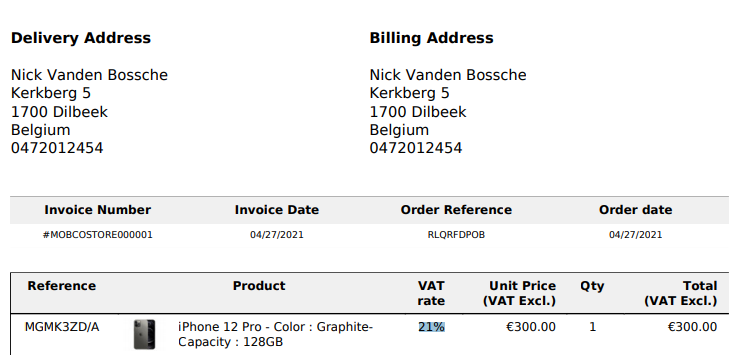

Solution:
My solution isn't best practice but it actually works. Maybe someone with more knowledge can elaborate on this.
In following file: classes/pdf/HTMLTemplateInvoice.php
Go to line 180:
// Set tax_code
            $taxes = OrderDetail::getTaxListStatic($id);
            $tax_temp = array();
            foreach ($taxes as $tax) {
                $obj = new Tax($tax['id_tax']);
                $translator = Context::getContext()->getTranslator();
                $tax_temp[] = $translator->trans(
                    '%taxrate%%space%%',
                    array(
                        '%taxrate%' => ($obj->rate + 0),
                        '%space%' => ' ',
                    'Shop.Pdf'
And replace this with:
// Set tax_code
                    '%taxrate%%nothing%%',
                    array(
                        '%nothing%' => '',
                    'Shop.Pdf'
The issue was that it translated the following variable: '%taxrate%%space%%' into '%Vatrate%%space%%'
But the translated variable doesn't exist, thus in the invoice pdf it didn't show the value it's supposed to.
With my "ugly" fix it now shows the actual vat rate %
