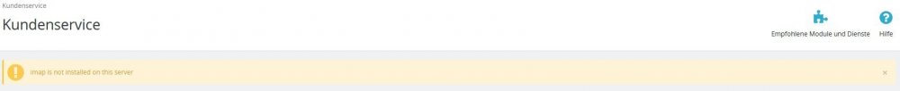

Isolif Posted April 21, 2021 Share Posted April 21, 2021 (edited) Prestashop 1.7.7.1 in an docker instance with an additional apache webserver up front. I've tried all kinds of configurations already and also on the mail server side imap is enabled. Nevertheless i always get the error 'imap is not installed on this server' when setting up the configuration and when trying to sync. Not to mention that the synching does not work. Is that a common issue? Has it something to do with the docker installation? Regards, Edited April 21, 2021 by Isolif (see edit history) Link to comment Share on other sites More sharing options...
wimotek Posted February 16 Share Posted February 16 i have the same problem . 8.1.3 version. php has installed imap extension. Link to comment Share on other sites More sharing options...
wimotek Posted February 16 Share Posted February 16 (edited) i finally found . it is ok that removing from disable function of imap_open from the php.ini Edited February 16 by wimotek (see edit history) Link to comment Share on other sites More sharing options...
