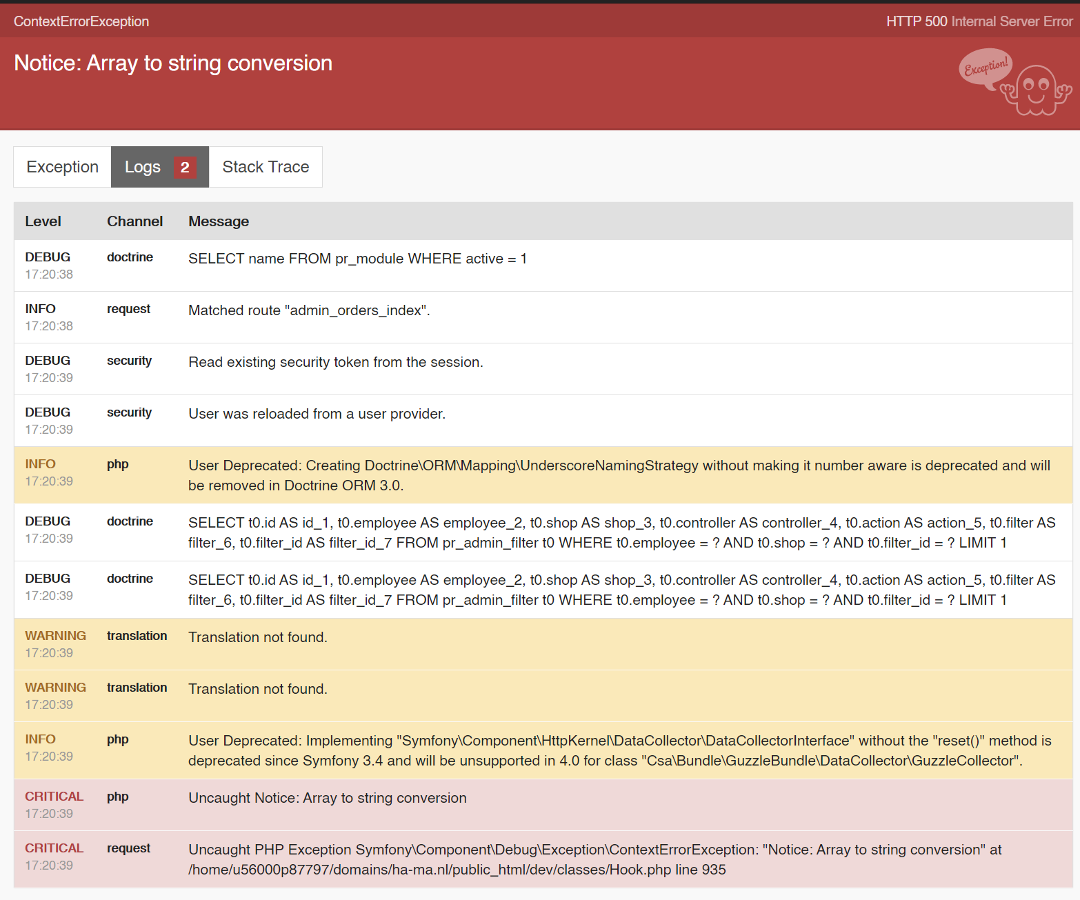

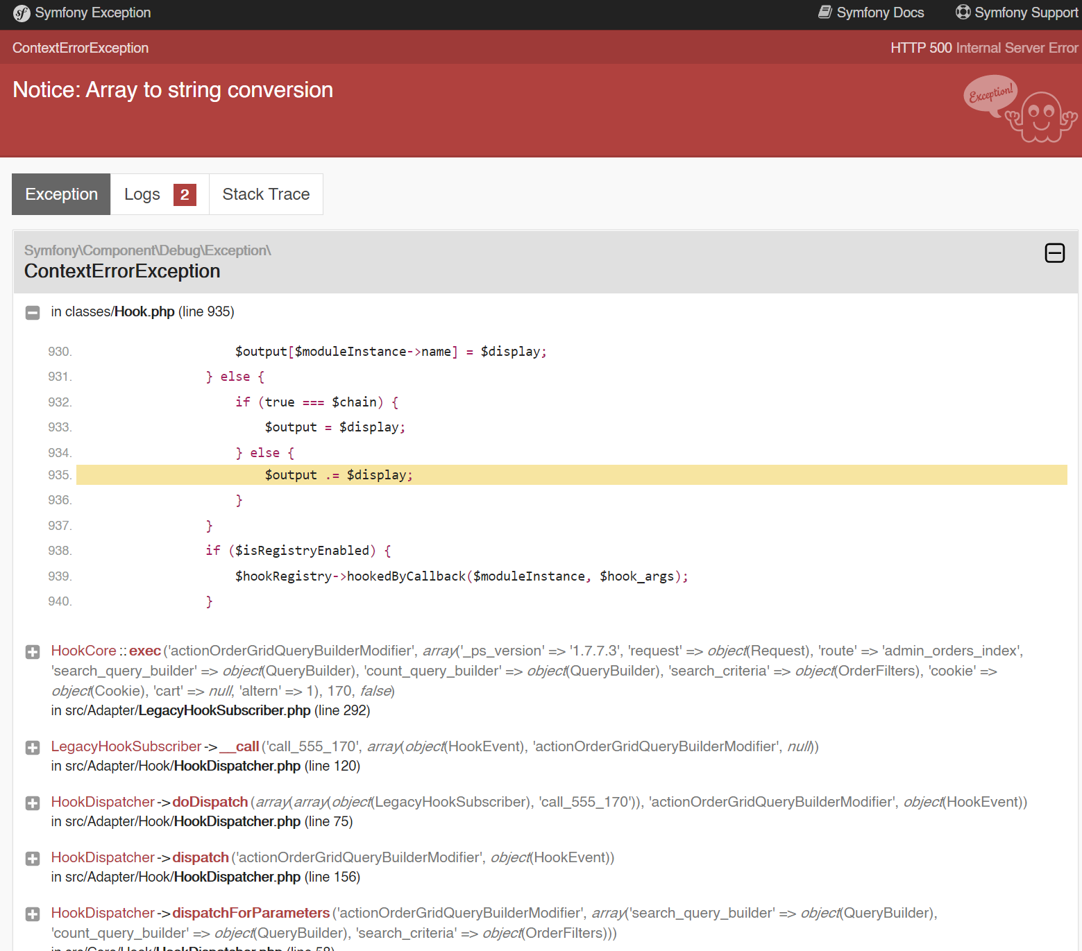

wzzly Posted April 14, 2021 Author Share Posted April 14, 2021 BTW I noticed that when I enable debug mode, I get the following error on any BO page. Could that haev anything to do with it? Link to comment Share on other sites More sharing options...

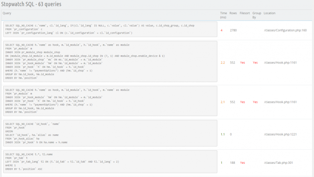

musicmaster Posted April 14, 2021 Share Posted April 14, 2021 If you have enabled the profiler, why don't you mention the slowest queries? That could be more enlightening. My impression is that the "array to string conversion" is caused by some module. Link to comment Share on other sites More sharing options...
wzzly Posted April 14, 2021 Author Share Posted April 14, 2021 @musicmaster thanks for your reply. Here is a screenshot of the slowest queries: Link to comment Share on other sites More sharing options...
musicmaster Posted April 15, 2021 Share Posted April 15, 2021 12 hours ago, wzzly said: @musicmaster thanks for your reply. Here is a screenshot of the slowest queries: I miss the frequency: how often these queries are called. But the numbers of milliseconds are very low. So maybe it is not queries that take up the time. Link to comment Share on other sites More sharing options...

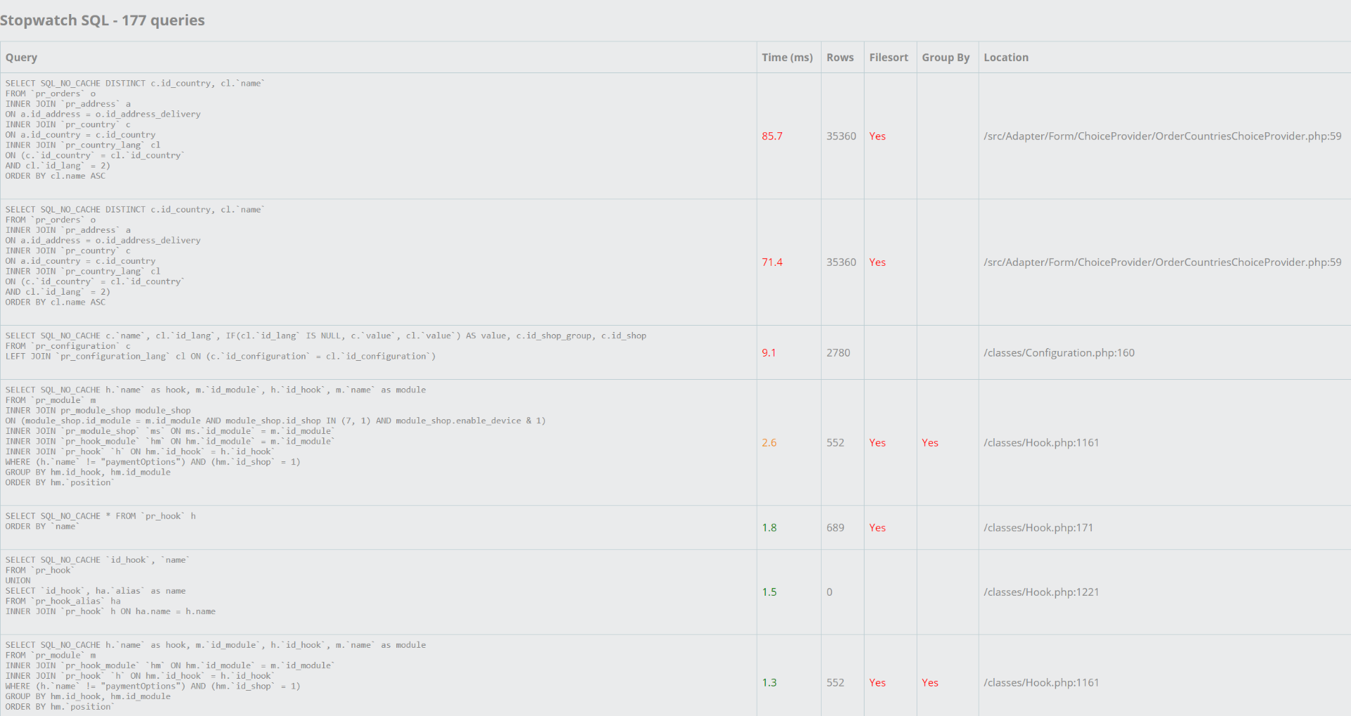

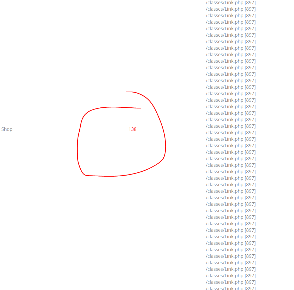

wzzly Posted April 15, 2021 Author Share Posted April 15, 2021 I do see in de ObjectModel instances section that /classes/Link.php [897] is called 138 times? Is that OK? Is Link to comment Share on other sites More sharing options...

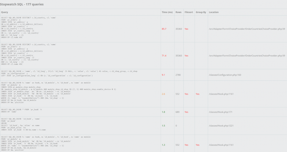

wzzly Posted April 15, 2021 Author Share Posted April 15, 2021 @musicmasterwhen opening the orders page, I do get slow queries? Link to comment Share on other sites More sharing options...
wzzly Posted April 15, 2021 Author Share Posted April 15, 2021 This is the line (897) from the /classes/Link.php //Use the matching shop if present, or fallback on the default one if (null !== $idShop) { $shop = new Shop($idShop); } else { $shop = new Shop(Configuration::get('PS_SHOP_DEFAULT')); } is it not able to find the shop ID or something? Link to comment Share on other sites More sharing options...

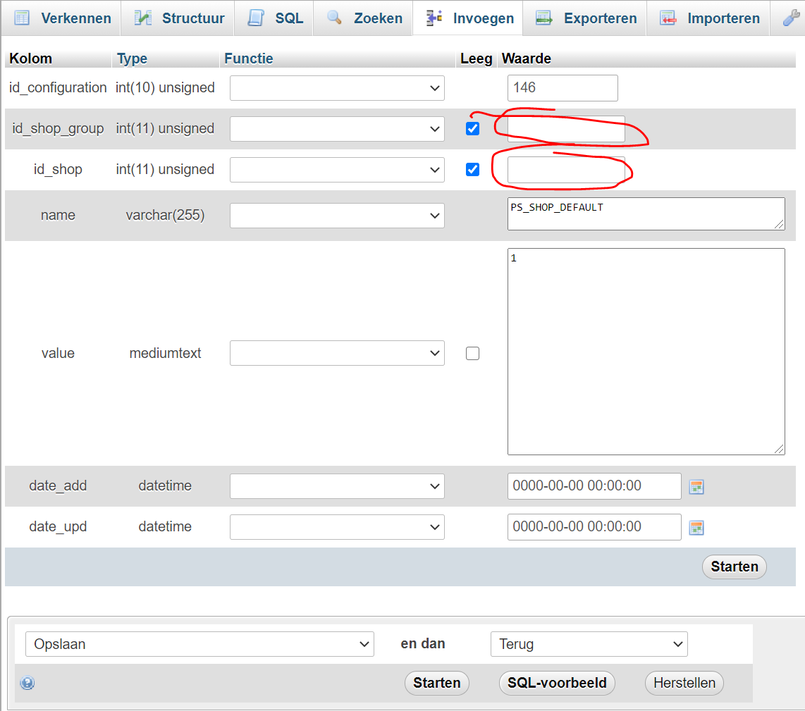

wzzly Posted April 15, 2021 Author Share Posted April 15, 2021 Is it normal these values are empty? Link to comment Share on other sites More sharing options...
musicmaster Posted April 15, 2021 Share Posted April 15, 2021 2 hours ago, wzzly said: Is it normal these values are empty? Yes, that is normal. Link to comment Share on other sites More sharing options...
musicmaster Posted April 15, 2021 Share Posted April 15, 2021 5 hours ago, wzzly said: This is the line (897) from the /classes/Link.php //Use the matching shop if present, or fallback on the default one if (null !== $idShop) { $shop = new Shop($idShop); } else { $shop = new Shop(Configuration::get('PS_SHOP_DEFAULT')); } is it not able to find the shop ID or something? 138 times is a lot. It suggests that you have a multishop and that it is set for all shops. Prestasshop isn't handling the situation very nice. So you might consider opening an issue on their Github. For the rest I suggest that you install on the same server a fresh installation of the same Prestashop version. Then you can compare and see whether your values are really unusual for your situation. Link to comment Share on other sites More sharing options...
wzzly Posted April 21, 2021 Author Share Posted April 21, 2021 @musicmaster I did and there they say it's normal as there are probably 138 links in the BO (menu) that need to be loaded. Anybody have any idea what is being called by initHeader on the BO? This takes up the most loading time. I already tried unhooking as much as possible from displayAdminHeader Link to comment Share on other sites More sharing options...

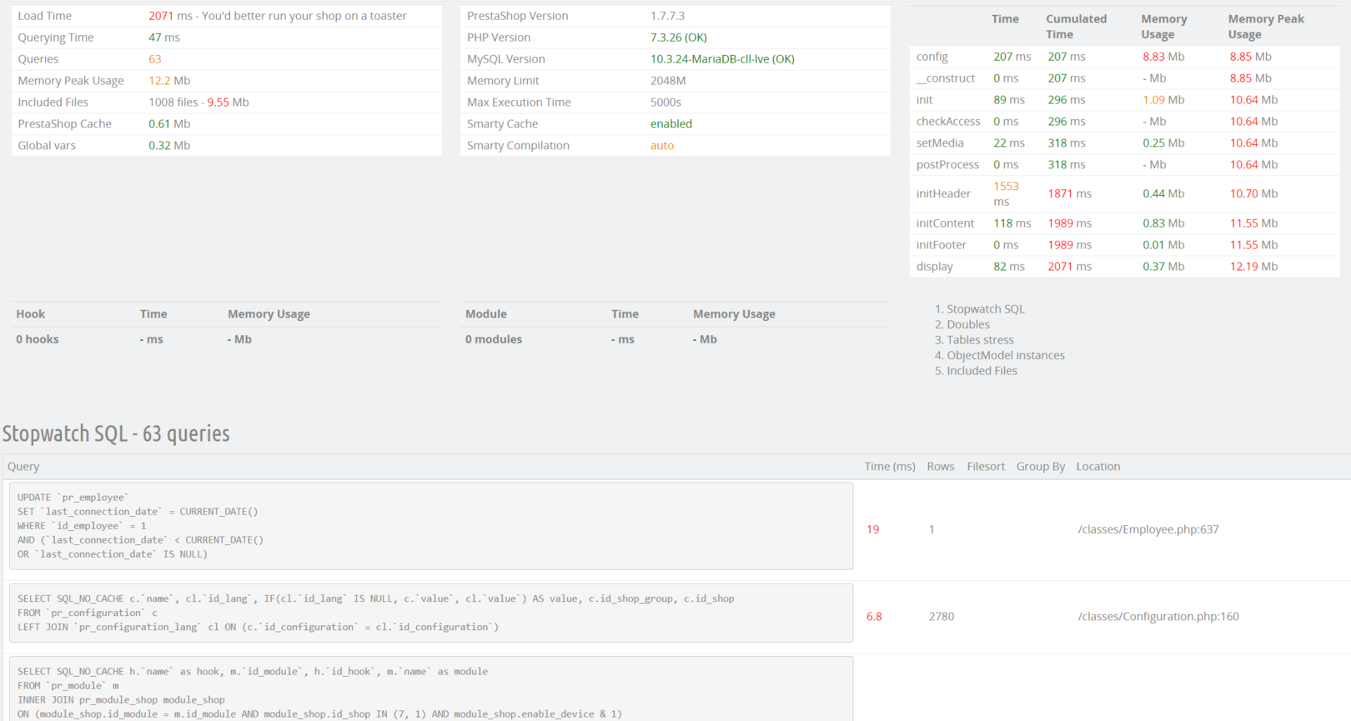

musicmaster Posted April 23, 2021 Share Posted April 23, 2021 Did you also look at the table that lists both Load Time and Querying time? It may very well be that the database is not the most timeconsuming. Link to comment Share on other sites More sharing options...
wzzly Posted April 24, 2021 Author Share Posted April 24, 2021 @musicmaster which table do you mean? Link to comment Share on other sites More sharing options...
musicmaster Posted April 24, 2021 Share Posted April 24, 2021 The first Link to comment Share on other sites More sharing options...

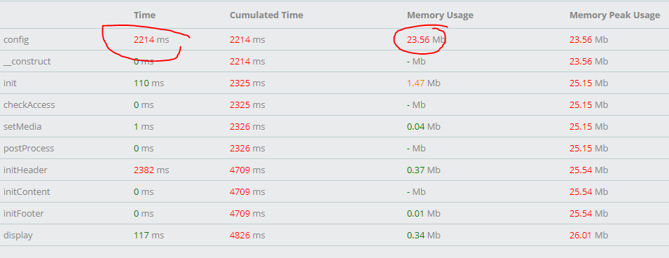

wzzly Posted May 6, 2021 Author Share Posted May 6, 2021 @musicmaster Yes did it on different competitors aswell. In the BO I also notice that when visiting the orders page, the loading of config takes up alot of memory and time. What does that mean? Link to comment Share on other sites More sharing options...
musicmaster Posted May 6, 2021 Share Posted May 6, 2021 8 minutes ago, wzzly said: @musicmaster Yes did it on different competitors aswell. In the BO I also notice that when visiting the orders page, the loading of config takes up alot of memory and time. What does that mean? I have no idea. My suggestion was to look at Network in the Browser console. Did you do that? Link to comment Share on other sites More sharing options...

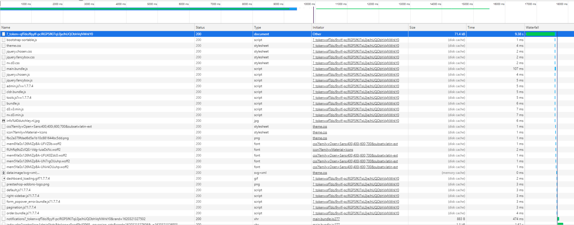

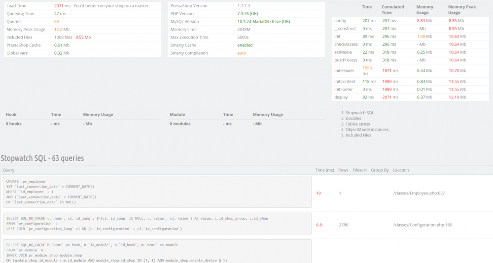

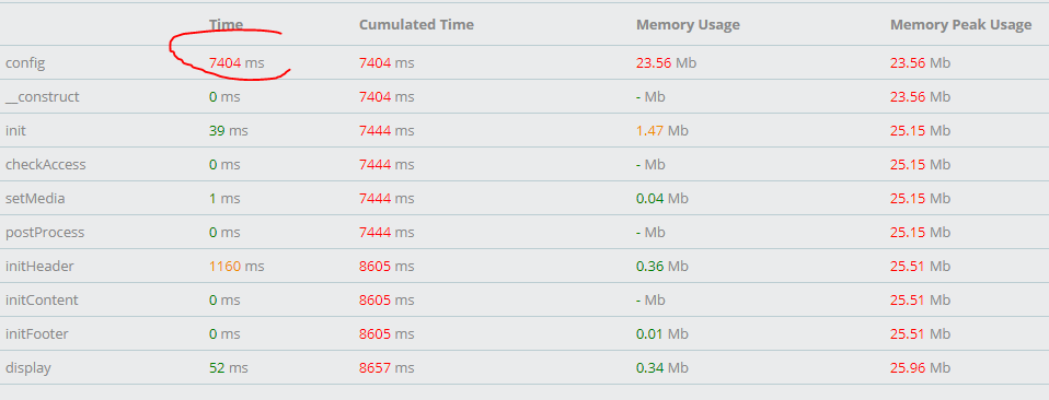

wzzly Posted May 6, 2021 Author Share Posted May 6, 2021 @musicmaster Yes that also shows TTFB of 9 seconds... Can I get more info on this? The profiler has these timings: Link to comment Share on other sites More sharing options...

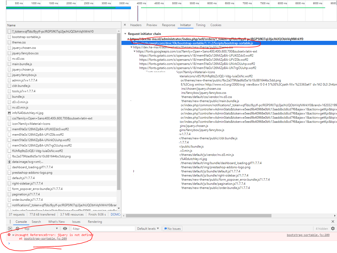

wzzly Posted May 6, 2021 Author Share Posted May 6, 2021 @musicmaster maybe I found something? When I look in DevTools on the BO order page, I see this error in my console. And when I check the Network tab, I see that this file: bootstrap-sortable.js is the first thing called.... is that coincidence? Link to comment Share on other sites More sharing options...
musicmaster Posted May 6, 2021 Share Posted May 6, 2021 I don't know how to solve this. Some final suggestions: - have a look at the Waterfall in GTMetrix - what puzzles me with the bootstrap-sortable.js the most is that it comes from an external site. Is that some module you installed? - jQuery errors are unfortunately quite common. In this case one has too wonder whether jquery just isn't loaded yet. Link to comment Share on other sites More sharing options...
wzzly Posted May 6, 2021 Author Share Posted May 6, 2021 @musicmaster Found out that bootstrap-sortable.js is part of the profiler... wierd https://github.com/PrestaShop/PrestaShop-1.6/blob/master/tools/profiling/Controller.php <script type="text/javascript" src="https://cdn.rawgit.com/drvic10k/bootstrap-sortable/1.11.2/Scripts/bootstrap-sortable.js"></script>'; Link to comment Share on other sites More sharing options...
