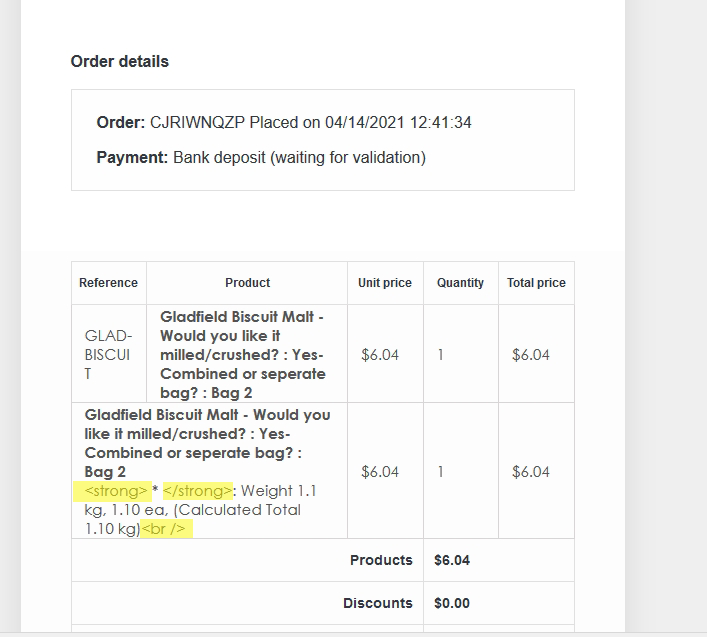

inspectaclueso Posted April 14, 2021 Share Posted April 14, 2021 (edited) Hi, I have just installed PS 1.7.7.3 and I'm completing the setup and test of the site. I have an issue where HTML code is being displayed in the order confirmation email sent after an order is placed. Image attached. At present the only paid module I have installed is: Linear / Perimeter / Surface (Area) / Volume / Weight Calculation Module v5.3.6 - by MEG Venture A tool to calculate quantity in linear, perimeter, surface (area), volume or weight units. If I disable this module, the product customization info is not shown so no HTML tags are shown. I have contacted the author of that module however they have said their module does not alter the mails in any way and the text displayed in that area is using standard Prestashop product customization info. Can someone please confirm this is a bug with Prestashop and where/how to look and correct this issue. Thank you Edited April 15, 2021 by inspectaclueso (see edit history) Link to comment Share on other sites More sharing options...

inspectaclueso Posted January 11, 2022 Author Share Posted January 11, 2022 Hi there, In my particular situation the solution was this... Please open the below file mails/_partials/order_conf_product_list.tpl Find instances of below {$customization['customization_text']} And replace them with below {$customization['customization_text'] nofilter} Hope it helps. Link to comment Share on other sites More sharing options...
Adam E Posted January 12, 2022 Share Posted January 12, 2022 Hello, Thank you very much for your response! I changed the .tpl and it works very good now, the HTML tags are no longer visible. Best regards, Adam E 1 Link to comment Share on other sites More sharing options...
