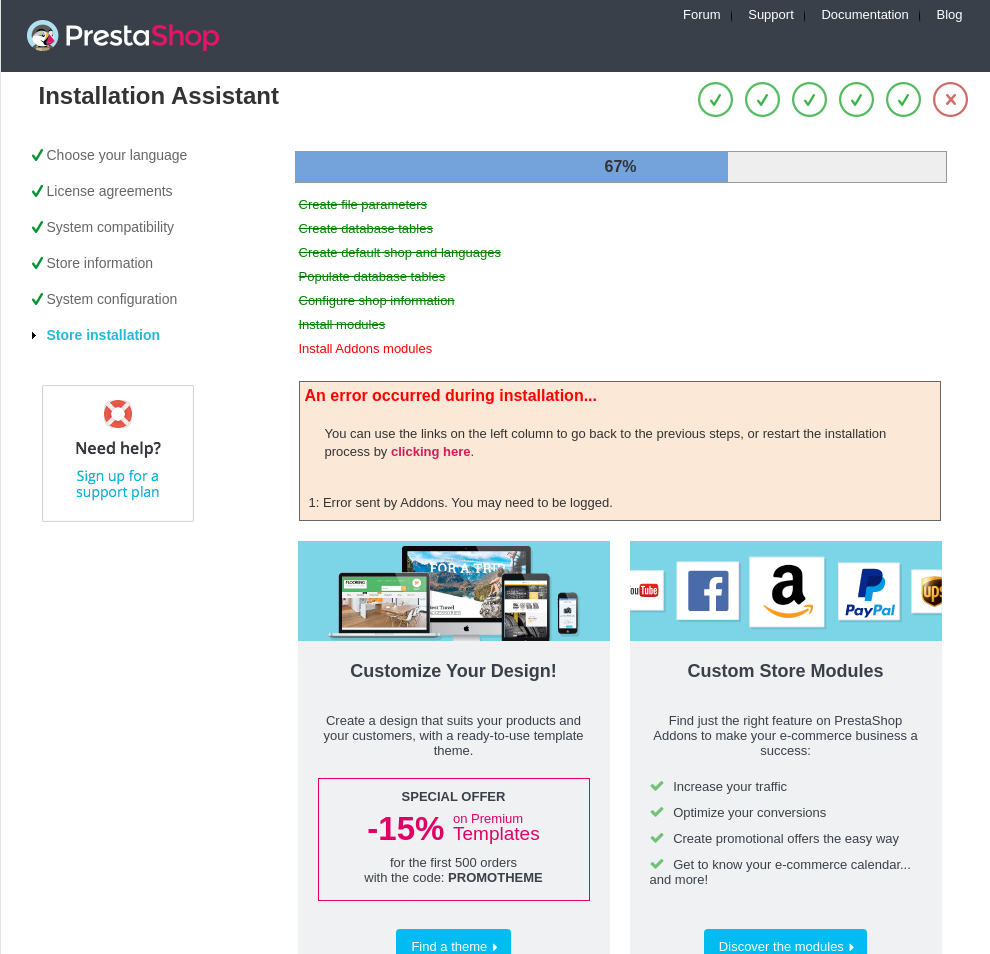

oliver139 Posted April 11, 2021 Share Posted April 11, 2021 This is my first time meet this erro in my new Linux laptop, I did not meet this in my previous laptop.. Is there any installation log I can take for reference? btw I am installing on local 127.0.0.1, which the server is installed by XAMPP Link to comment Share on other sites More sharing options...
endriu107 Posted April 11, 2021 Share Posted April 11, 2021 Check your php version, for PrestaShop 1.7.7 is php 7.3 max, and you probably have php8. Link to comment Share on other sites More sharing options...
oliver139 Posted April 11, 2021 Author Share Posted April 11, 2021 8 minutes ago, endriu107 said: Check your php version, for PrestaShop 1.7.7 is php 7.3 max, and you probably have php8. Thanks for your reply However, I know this and mine is php 7.2.. I have checked my php error log and found this: [11-Apr-2021 16:25:51 Europe/Berlin] PHP Warning: file_put_contents(/opt/lampp/htdocs/test1769/var/cache/prod/cacert.pem): failed to open stream: No such file or directory in /opt/lampp/htdocs/test1769/classes/Tools.php on line 2118 [11-Apr-2021 22:43:37 Asia/Hong_Kong] PHP Notice: Undefined offset: 0 in /opt/lampp/htdocs/lab1773/src/Adapter/Image/ImageRetriever.php on line 285 [11-Apr-2021 22:43:37 Asia/Hong_Kong] PHP Notice: Undefined index: in /opt/lampp/htdocs/lab1773/src/Adapter/Image/ImageRetriever.php on line 285 [11-Apr-2021 22:43:37 Asia/Hong_Kong] PHP Notice: Undefined offset: 0 in /opt/lampp/htdocs/lab1773/src/Adapter/Image/ImageRetriever.php on line 287 [11-Apr-2021 22:43:37 Asia/Hong_Kong] PHP Notice: Undefined index: in /opt/lampp/htdocs/lab1773/src/Adapter/Image/ImageRetriever.php on line 287 Permission is set to folder 755 and file 644 before installation Any more ideas? Link to comment Share on other sites More sharing options...
oliver139 Posted April 22, 2021 Author Share Posted April 22, 2021 5 hours ago, Harry Mat said: Hello, I think you are facing because of the php version. I will recommend you to upgrade it and then try again. I think your problem will be solved. Thanks. Regards Thanks for your suggestions. But as I said that I am installing PrestaShop 1.7.6.9 with php7.2, which is already the recommended php version stated in the PrestaShop Document.. So I think this should not be the problem Link to comment Share on other sites More sharing options...
