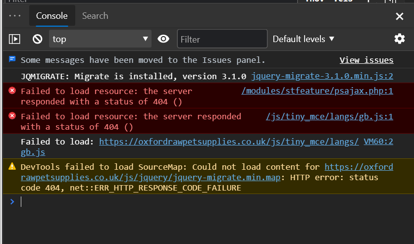

BeckyW1984 Posted April 19, 2021 Author Share Posted April 19, 2021 On 4/19/2021 at 4:57 PM, musicmaster said: Type F12 or Fn-F12 in your browser. At the top half of the page a window (the console tab) will open that shows javascript errors. Expand Is this what you mean? I can see there are errors, one related to the language which I think may be the cause? Link to comment Share on other sites More sharing options...

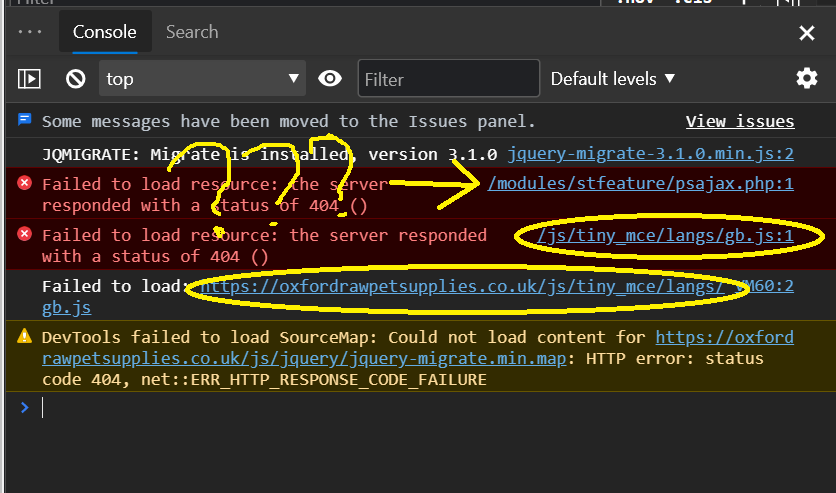

musicmaster Posted April 19, 2021 Share Posted April 19, 2021 It looks like it failed to load some files. See my annotated picture. TinyMce is the software that powers these editing windows. As you see it fails to download the gb.js language. My suggestion is to copy en.js in that directory to create gb.js. The other 404 problem, with the stfeature module is less clear to me. It might be a deleted file. Otherwise you might ask its provider. Anyway, fixing the language file might solve your present problem. Link to comment Share on other sites More sharing options...
BeckyW1984 Posted April 19, 2021 Author Share Posted April 19, 2021 Thanks @musicmaster you are an absolute LEGEND!!!!!! Thank you so so so much 🙂 that seems to have sorted the issue. Link to comment Share on other sites More sharing options...
