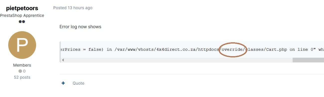

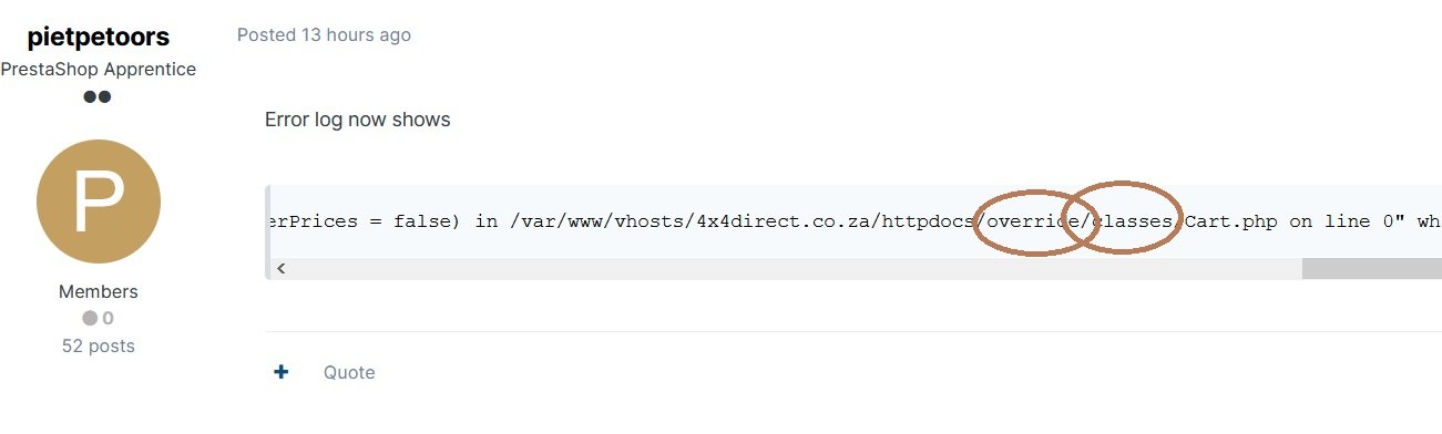

pietpetoors Posted April 4, 2021 Author Share Posted April 4, 2021 Don't know what all of these mena but in Presta debug mode and my server log there are complaints about the cart. No idea what it is about. Presta Debug mde log: Quote LevelChannelMessage DEBUG 15:01:49doctrineSELECT name FROM ps_module WHERE active = 1 INFO 15:01:49requestMatched route "admin_themes_index". DEBUG 15:01:49securityRead existing security token from the session. DEBUG 15:01:49securityUser was reloaded from a user provider. INFO 15:01:49phpUser Deprecated: Creating Doctrine\ORM\Mapping\UnderscoreNamingStrategy without making it number aware is deprecated and will be removed in Doctrine ORM 3.0. INFO 15:01:50phpUser Deprecated: Implementing "Symfony\Component\HttpKernel\DataCollector\DataCollectorInterface" without the "reset()" method is deprecated since Symfony 3.4 and will be unsupported in 4.0 for class "Csa\Bundle\GuzzleBundle\DataCollector\GuzzleCollector". CRITICAL 15:01:50phpUncaught Warning: Declaration of Cart::getProducts($refresh = false, $id_product = false, $id_country = NULL, $fullInfos = true) should be compatible with CartCore::getProducts($refresh = false, $id_product = false, $id_country = NULL, $fullInfos = true, bool $keepOrderPrices = false) CRITICAL 15:01:50requestUncaught PHP Exception Symfony\Component\Debug\Exception\ContextErrorException: "Warning: Declaration of Cart::getProducts($refresh = false, $id_product = false, $id_country = NULL, $fullInfos = true) should be compatible with CartCore::getProducts($refresh = false, $id_product = false, $id_country = NULL, $fullInfos = true, bool $keepOrderPrices = false)" at /var/www/vhosts/4x4direct.co.za/httpdocs/override/classes/Cart.php line 0 Expand Server error log Quote 11301#0: *955208 FastCGI sent in stderr: "PHP message: PHP Warning: Declaration of Cart::getProducts($refresh = false, $id_product = false, $id_country = NULL, $fullInfos = true) should be compatible with CartCore::getProducts($refresh = false, $id_product = false, $id_country = NULL, $fullInfos = true, bool $keepOrderPrices = false) in /var/www/vhosts/4x4direct.co.za/httpdocs/override/classes/Cart.php on line 0" while reading response header from upstream Expand Link to comment Share on other sites More sharing options...
pietpetoors Posted April 4, 2021 Author Share Posted April 4, 2021 I also keep on getting this in the server error log Quote 11301#0: *967341 FastCGI sent in stderr: "Primary script unknown" while reading response header from upstream Expand Link to comment Share on other sites More sharing options...

musicmaster Posted April 4, 2021 Share Posted April 4, 2021 On 4/4/2021 at 1:17 PM, pietpetoors said: I have no idea, I uninstalled custom theme and disabled all modules. The custom theme did have plenty of modules that came with it, I am going to uninstall those now Expand Did you notice that the override is still there? Link to comment Share on other sites More sharing options...

pietpetoors Posted April 4, 2021 Author Share Posted April 4, 2021 Yes I notice the overide is still there. I installed Prestools and I also installed the prestoolssuite-module am busy figuring it out now Link to comment Share on other sites More sharing options...
pietpetoors Posted April 4, 2021 Author Share Posted April 4, 2021 attributewizardpro is the one with the overrides but it has been deactivated. I now uninstalled it and still get this Quote 11301#0: *967420 FastCGI sent in stderr: "PHP message: PHP Fatal error: Uncaught Symfony\Component\Debug\Exception\ContextErrorException: Warning: Declaration of Cart::getProducts($refresh = false, $id_product = false, $id_country = NULL, $fullInfos = true) should be compatible with CartCore::getProducts($refresh = false, $id_product = false, $id_country = NULL, $fullInfos = true, bool $keepOrderPrices = false) in /var/www/vhosts/4x4direct.co.za/httpdocs/override/classes/Cart.php:0 Stack trace: #0 /var/www/vhosts/4x4direct.co.za/httpdocs/classes/PrestaShopAutoload.php(152): Symfony\Component\Debug\ErrorHandler->handleError(2, 'Declaration of ...', '/var/www/vhosts...', 0, Array) #1 /var/www/vhosts/4x4direct.co.za/httpdocs/classes/PrestaShopAutoload.php(152): require_once() #2 [internal function]: PrestaShopAutoload->load('Cart') #3 /var/www/vhosts/4x4direct.co.za/httpdocs/src/PrestaShopBundle/Install/Upgrade.php(316): spl_autoload_call('Cart') #4 /var/www/vhosts/4x4direct.co.za/httpdocs/src/PrestaShopBundle/Install/Upgrade.php(814): Pres" while reading response header from upstream Expand Link to comment Share on other sites More sharing options...

musicmaster Posted April 4, 2021 Share Posted April 4, 2021 - You can delete modules inside Prestashop too. That would have been the better approach. - Deleting those modules will do nothing for the overrides. They are still under the override directory. You should delete those files. And after that you should do a clean cache in the Prestashop backoffice. Link to comment Share on other sites More sharing options...

musicmaster Posted April 4, 2021 Share Posted April 4, 2021 On 4/4/2021 at 2:29 PM, pietpetoors said: So can I just delete the 3 folders in the overrides folder? Classes Controllers Modules Expand No, it is better to delete the files Link to comment Share on other sites More sharing options...
pietpetoors Posted April 4, 2021 Author Share Posted April 4, 2021 Under modules is only /contactform Under controllers are admin and front Under classes are a very long list Link to comment Share on other sites More sharing options...

pietpetoors Posted April 4, 2021 Author Share Posted April 4, 2021 Deleted the overide files and ran upgrade again. Getting worse now, cannot log into my admin panel, the following is displayed on the login page and there is no block for username and pw. Quote Deprecated: array_key_exists(): Using array_key_exists() on objects is deprecated. Use isset() or property_exists() instead in /var/www/vhosts/4x4direct.co.za/httpdocs/src/Adapter/EntityMapper.php on line 99 Expand Link to comment Share on other sites More sharing options...
pietpetoors Posted April 4, 2021 Author Share Posted April 4, 2021 Error log shows nothing besides: Quote 1191#0: *987725 FastCGI sent in stderr: "Primary script unknown" while reading response header from upstream Expand Link to comment Share on other sites More sharing options...
musicmaster Posted April 4, 2021 Share Posted April 4, 2021 On 4/4/2021 at 2:31 PM, pietpetoors said: Under modules is only /contactform Under controllers are admin and front Under classes are a very long list Expand You know from your error messages which ones gave the problem and are related to AWP. Just delete them. Go to PHP version 1.7.3. 1.7.4 is not officially supported. Link to comment Share on other sites More sharing options...
musicmaster Posted April 4, 2021 Share Posted April 4, 2021 The "array_key_exists" error is likely due to the PHP version. Did you manage to empty the cache in the backoffice? If not do it in Prestools: under Cleanup. Link to comment Share on other sites More sharing options...
