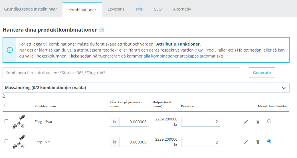

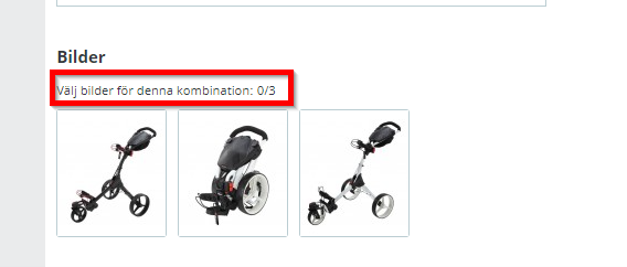

patrik1972 Posted March 21, 2021 Share Posted March 21, 2021 Hi All, I would really need some help with a problem that occurred after a migration. After the migration there are very many products with combinations that are missing the connection to the correct picture. Is it possible to fix this with some easier way than do it manually? Link to comment Share on other sites More sharing options...

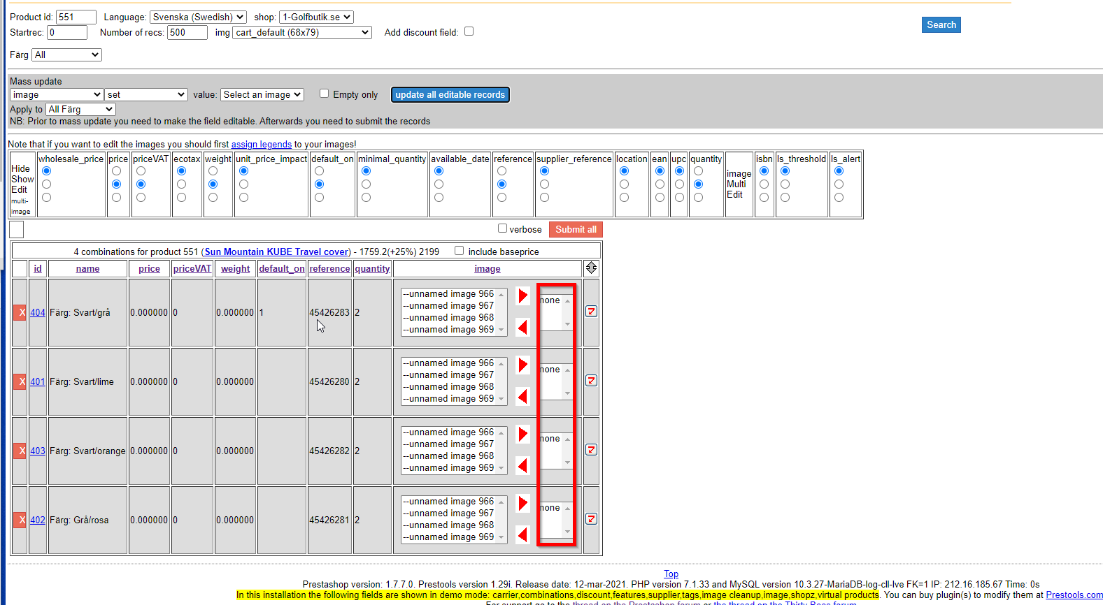

musicmaster Posted March 21, 2021 Share Posted March 21, 2021 Combi-edit: Link to comment Share on other sites More sharing options...
patrik1972 Posted March 21, 2021 Author Share Posted March 21, 2021 10 minutes ago, musicmaster said: Combi-edit: But I still need to do product by product, one at the time? Link to comment Share on other sites More sharing options...
musicmaster Posted March 21, 2021 Share Posted March 21, 2021 4 minutes ago, patrik1972 said: But I still need to do product by product, one at the time? What kind of mass assignment do you want to do? Link to comment Share on other sites More sharing options...
patrik1972 Posted March 21, 2021 Author Share Posted March 21, 2021 Just now, musicmaster said: What kind of mass assignment do you want to do? I have probably over 500 products that don't have connected image to combination after migration. They have it it the old store....the migration faild this Link to comment Share on other sites More sharing options...
musicmaster Posted March 21, 2021 Share Posted March 21, 2021 1 hour ago, patrik1972 said: I have probably over 500 products that don't have connected image to combination after migration. They have it it the old store....the migration faild this Note that if you don't know the id's you should assign legends to the images first. The only thing that could make this faster is a wysiwyg application where you drag-and-drop the images. But I don't know an application that can do that. Link to comment Share on other sites More sharing options...
patrik1972 Posted March 21, 2021 Author Share Posted March 21, 2021 1 minute ago, musicmaster said: Note that if you don't know the id's you should assign legends to the images first. The only thing that could make this faster is a wysiwyg application where you drag-and-drop the images. But I don't know an application that can do that. Thanks for your help. Link to comment Share on other sites More sharing options...
musicmaster Posted March 22, 2021 Share Posted March 22, 2021 15 hours ago, patrik1972 said: Thanks for your help. I found some space for improvement: a preview. combi-edit.php Link to comment Share on other sites More sharing options...
