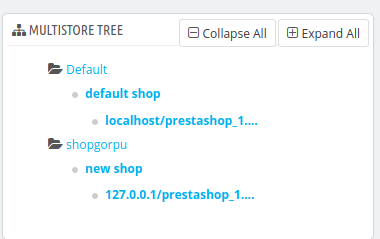

Hi,
you can try by creating different shop and map with domain as you mention ,
As per the shop url table structure it should be possible by making some changes
Create 2 Shop Group
one with domain having 92.168.0.10
other with  subdomain.example.com
then both url will work and resources are shared so behave same.
Please see my attached screenshots might be that help to you .
