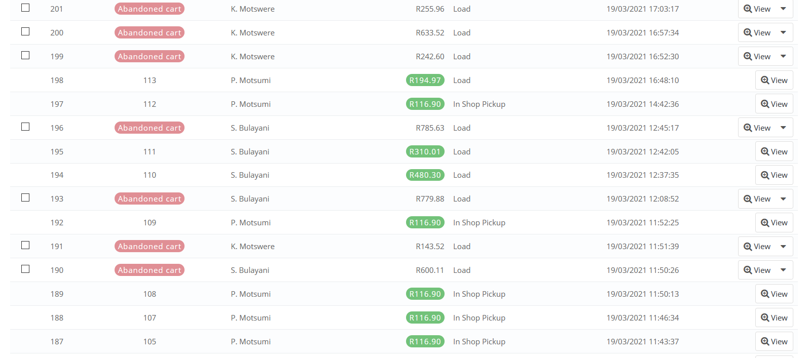

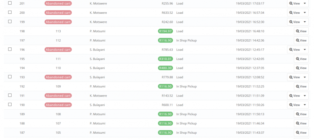

pat.motsumi Posted March 15, 2021 Share Posted March 15, 2021 I am constantly getting this error "Cart cannot be placed" after payment has been made. Which means its failing to convert the cart to order. I have observed in the database that more than 1 can be assigned the same cart_id, which means when the last order is placed it will fail since the first one has been placed using that cart Id. Kindly assist where i can fix because the error pops up regardless of the method of payment chosen Link to comment Share on other sites More sharing options...

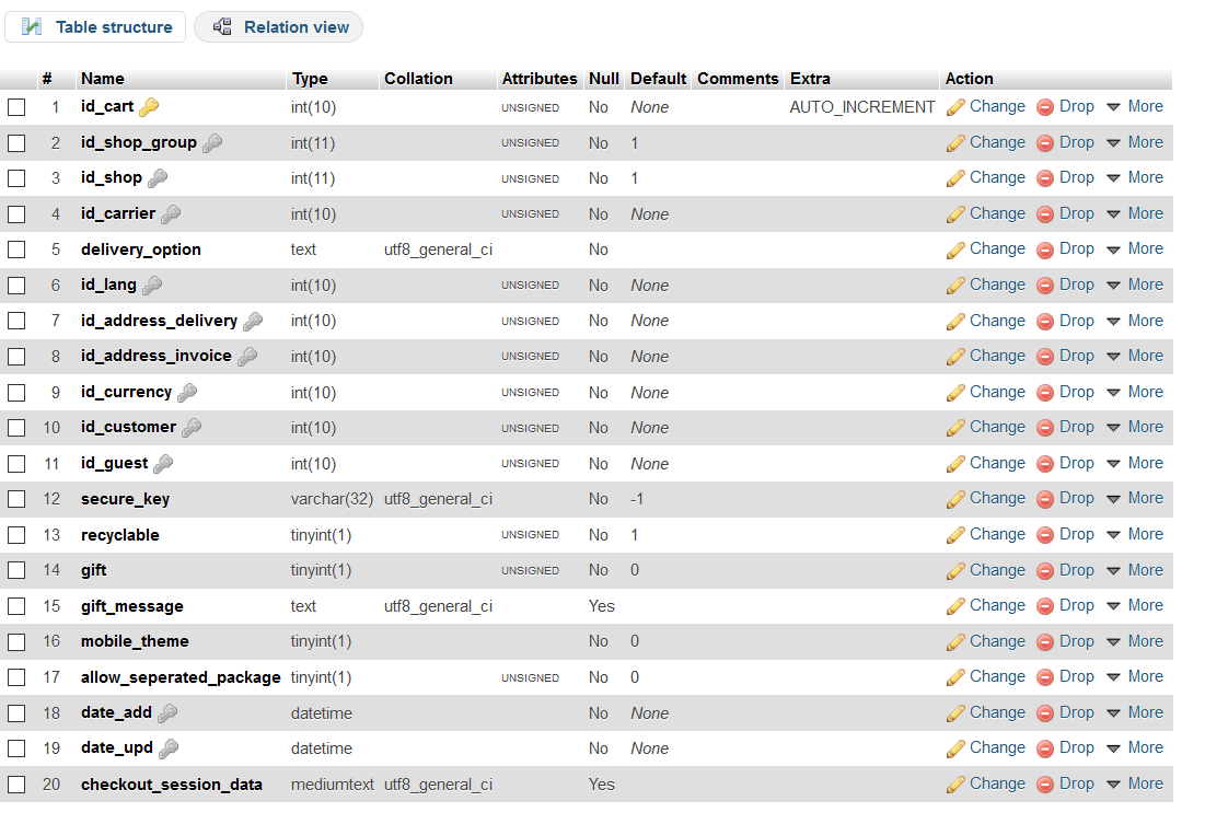

pat.motsumi Posted March 15, 2021 Author Share Posted March 15, 2021 4 minutes ago, musicmaster said: This is database work. So phpmyadmin. yes i have access to phpM yadmin . find the structure of the cart table attached Link to comment Share on other sites More sharing options...

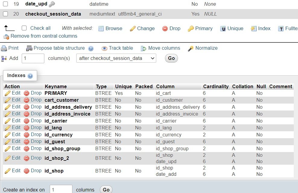

musicmaster Posted March 15, 2021 Share Posted March 15, 2021 id_cart has auto_increment so that is ok. For the keys you need to scroll down: Link to comment Share on other sites More sharing options...
pat.motsumi Posted March 15, 2021 Author Share Posted March 15, 2021 1 hour ago, musicmaster said: id_cart has auto_increment so that is ok. For the keys you need to scroll down: Link to comment Share on other sites More sharing options...
musicmaster Posted March 15, 2021 Share Posted March 15, 2021 41 minutes ago, pat.motsumi said: Ok, so the problem isn't there. I have some problem with your "Cart cannot be placed" text. I cannot find it anywhere in the PS 1.7.7.1 sourcecode. Yet finding where this comes from is important for solving the problem. Is it some module in your shop? Link to comment Share on other sites More sharing options...

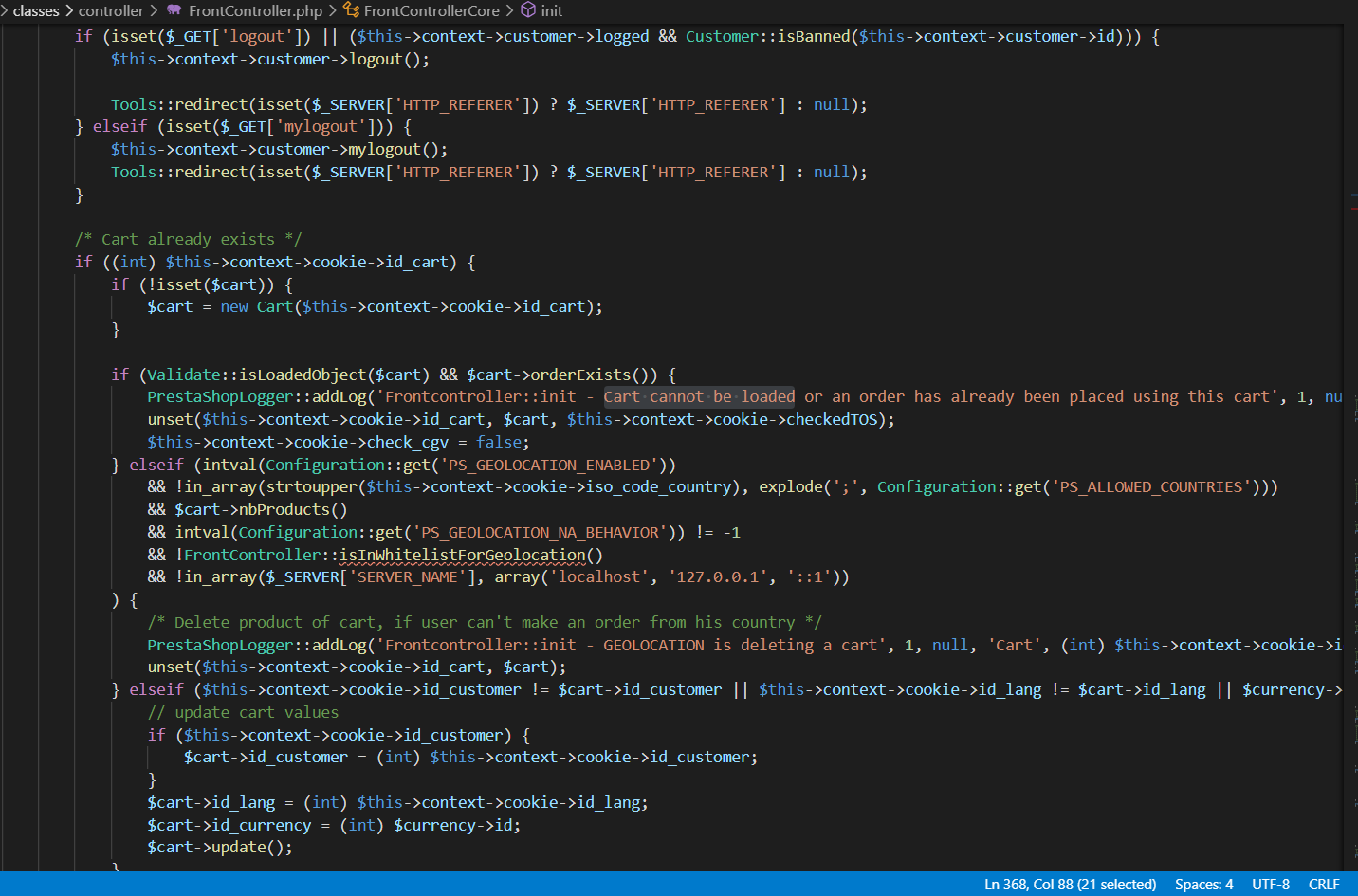

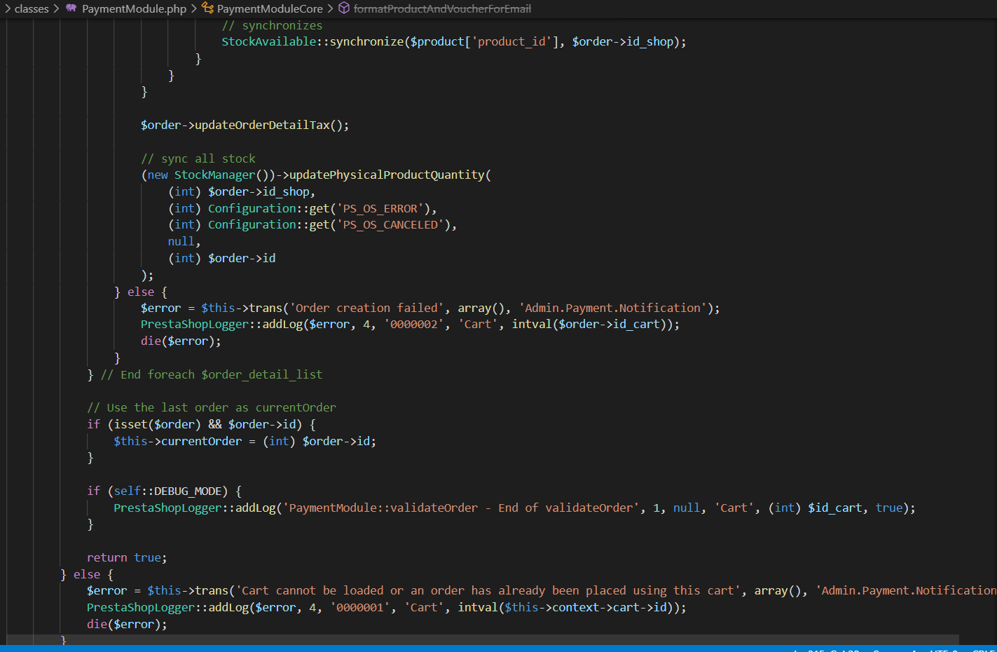

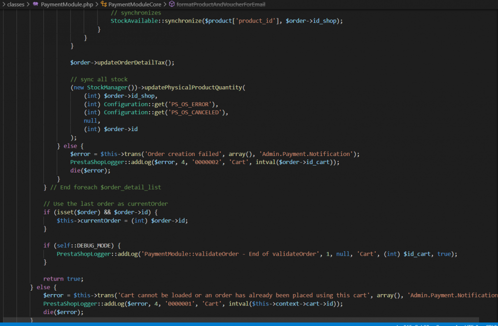

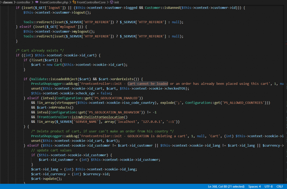

pat.motsumi Posted March 15, 2021 Author Share Posted March 15, 2021 1 minute ago, musicmaster said: Ok, so the problem isn't there. I have some problem with your "Cart cannot be placed" text. I cannot find it anywhere in the PS 1.7.7.1 source code. Yet finding where this comes from is important for solving the problem. Is it some module in your shop? It comes from the FrontInitcontroller and paymentmodule Link to comment Share on other sites More sharing options...
musicmaster Posted March 15, 2021 Share Posted March 15, 2021 1 hour ago, pat.motsumi said: It comes from the FrontInitcontroller and paymentmodule Can you provide screendumps? Link to comment Share on other sites More sharing options...
pat.motsumi Posted March 15, 2021 Author Share Posted March 15, 2021 1 hour ago, musicmaster said: Can you provide screendumps? PaymentModule class frontController Link to comment Share on other sites More sharing options...
musicmaster Posted March 15, 2021 Share Posted March 15, 2021 1 hour ago, pat.motsumi said: PaymentModule class frontController I meant screendumps of the error message Link to comment Share on other sites More sharing options...
pat.motsumi Posted March 16, 2021 Author Share Posted March 16, 2021 21 hours ago, musicmaster said: I meant screendumps of the error message Link to comment Share on other sites More sharing options...
musicmaster Posted March 16, 2021 Share Posted March 16, 2021 16 minutes ago, pat.motsumi said: Please provide next time an exact copy of the error message. With your summary "cart cannot be placed" you wasted both my and your time. What is the "rave" module doing? Link to comment Share on other sites More sharing options...

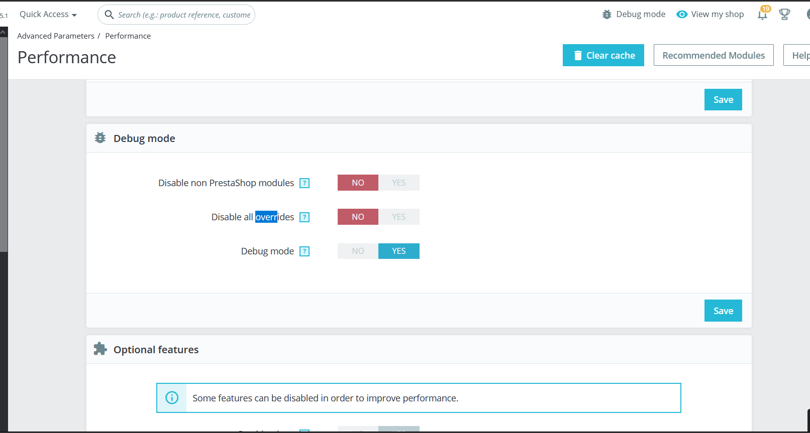

musicmaster Posted March 18, 2021 Share Posted March 18, 2021 Can you check whether any overrides are active? Prestools has a function for that and you can also look directly under the override directory. Link to comment Share on other sites More sharing options...
pat.motsumi Posted March 18, 2021 Author Share Posted March 18, 2021 4 hours ago, musicmaster said: Can you check whether any overrides are active? Prestools has a function for that and you can also look directly under the override directory. Link to comment Share on other sites More sharing options...
musicmaster Posted March 18, 2021 Share Posted March 18, 2021 59 minutes ago, pat.motsumi said: That doesn't answer my question. Link to comment Share on other sites More sharing options...
pat.motsumi Posted March 18, 2021 Author Share Posted March 18, 2021 How do i check if overrides are enabled. the only screen i came across was under performance. so i screenshoted so that you can guide where to look to Link to comment Share on other sites More sharing options...
musicmaster Posted March 18, 2021 Share Posted March 18, 2021 As I said: you cannot do that with the Prestashop backoffice. You should either to use Prestools or you can have a look yourself. This is hard work. You need to make a real effort. Link to comment Share on other sites More sharing options...

musicmaster Posted March 20, 2021 Share Posted March 20, 2021 On 3/19/2021 at 12:19 PM, pat.motsumi said: yes i did. But i still have mutliple Cart assigned to 1 cartId I also need more details. you write that "I am constantly getting this error "Cart cannot be placed" after payment has been made. Which means its failing to convert the cart to order. I have observed in the database that more than 1 can be assigned the same cart_id" That is very puzzling. Given that the index is there you should never see the same id more than once - at least not in the ps_cart table. So this could also be some problem with cookies. But to know more you should describe the problem in much more detail. Link to comment Share on other sites More sharing options...
pat.motsumi Posted March 21, 2021 Author Share Posted March 21, 2021 23 hours ago, musicmaster said: I also need more details. you write that "I am constantly getting this error "Cart cannot be placed" after payment has been made. Which means its failing to convert the cart to order. I have observed in the database that more than 1 can be assigned the same cart_id" That is very puzzling. Given that the index is there you should never see the same id more than once - at least not in the ps_cart table. So this could also be some problem with cookies. But to know more you should describe the problem in much more detail. Let me try explain it more. So when a user add products to cart a cartID is assigned. e.g 86.. When another user adds to cart also he can be assigned 86. So this behavior i have observed it in the admin panel under shopping carts. Then if 1 of the 2 customers process the order it will go through.Then when the second one process an order it will fail because already that cart ID has been used with the previous order.Then it will write cart cannot be placed. In the database everything is Ok and it doesnt allow 2 orders to be submitted with the same ID. Like u said i suspect that its an issue with cookies. The picture attached are all the orders that failed, the status was non ordered after sometime the status turn to abandoned cart. Issue 2: The shop doesnt re-display cart on login.Rather when the user logs out it automatically treat the cart as abandoned cart.When next time when the user order it will issue a new cartID Link to comment Share on other sites More sharing options...
