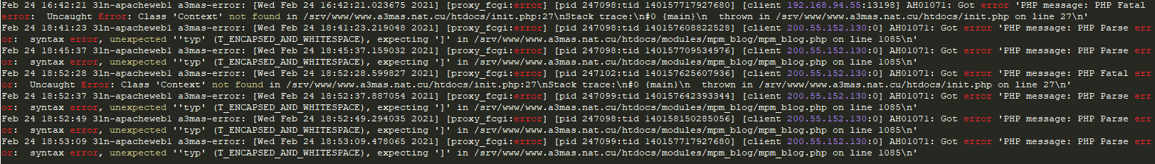

a3mascuba Posted February 25, 2021 Share Posted February 25, 2021 Hello, I have developed a prestashop 1.7 shop locally and it was working perfectly, when I uploaded it to the server I started to receive errors like this: can anyone help? Thanks in advance Link to comment Share on other sites More sharing options...
ecommerce16 Posted February 26, 2021 Share Posted February 26, 2021 something is not going right with your blog module. Turn it off and see if it works then. After that you can work at that module to fix it. Link to comment Share on other sites More sharing options...
a3mascuba Posted February 26, 2021 Author Share Posted February 26, 2021 2 hours ago, ecommerce16 said: something is not going right with your blog module. Turn it off and see if it works then. After that you can work at that module to fix it. thank you very much, in fact there were a couple of folders to be uploaded in the module you mention, but the website is still not responding. Any extra tips? Thanks again! Link to comment Share on other sites More sharing options...
