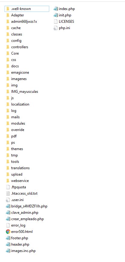

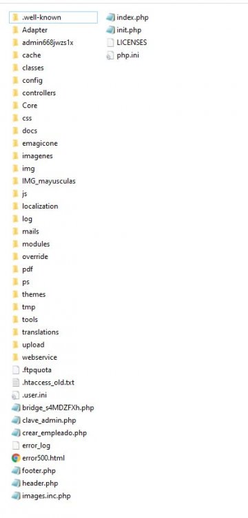

White_Rabit Posted February 24, 2021 Author Share Posted February 24, 2021 4 minutes ago, White_Rabit said: the version of prestashop is 1.6.1.23, and the person who build this site changed it from virtuemart and is a chaos because did no deleted some files of older shop. mi work now is put some orden to this chaos, i sorry but there no is a admin folder and there is some index.php files, and i dont know which of them is correct. this picture contains the root folder of the web. Link to comment Share on other sites More sharing options...
morktadela Posted February 24, 2021 Share Posted February 24, 2021 1 minute ago, White_Rabit said: this picture contains the root folder of the web. look the image. folder is admin668jwzs1x then /admin668jwzs1x/index.php?controller=AdminLogin&token=3234ba950ca6aa78584555cxf7ad90344 to: /admin668jwzs1x/ after you login Link to comment Share on other sites More sharing options...
White_Rabit Posted February 24, 2021 Author Share Posted February 24, 2021 3 minutes ago, morktadela said: look the image. folder is admin668jwzs1x then /admin668jwzs1x/index.php?controller=AdminLogin&token=3234ba950ca6aa78584555cxf7ad90344 to: /admin668jwzs1x/ after you login I don't understand what I should do, you say to delete the index.php file? Link to comment Share on other sites More sharing options...

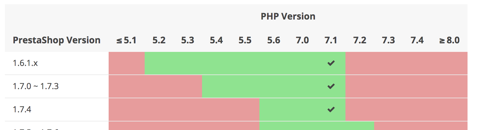

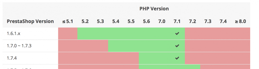

musicmaster Posted February 24, 2021 Share Posted February 24, 2021 PS 1.6.1.23 is not compatible with PHP 7.1 Link to comment Share on other sites More sharing options...
morktadela Posted February 24, 2021 Share Posted February 24, 2021 12 minutes ago, musicmaster said: PS 1.6.1.23 is not compatible with PHP 7.1 it is compatible: https://devdocs.prestashop.com/1.7/basics/installation/system-requirements/#php-compatibility-chart Link to comment Share on other sites More sharing options...
