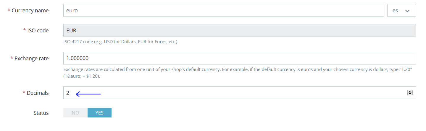

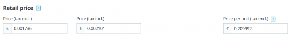

I'm trying to solve a problem with my website, without much success. Some prices of some products are 0.004€ for example. Or the unit price is 0.30€.
What happens is that having prestashop configured with 2 decimals, it does not show the prices of products with 3 decimals. I also think that as it can't show the retail price properly, it doesn't show the unit price properly either.
Options I have tried:

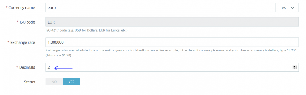

  •     I have tried changing the currency precision both in prestashop and directly in the database (ps_currency).
  •     Go to the CLDR folder and in main--xx-XX--numbers change the precision values of "accounting" and "standard" to show 3 decimal places, without success.
  •     Tweak the Formatter.php file as indicated at the end of this thread -> PS Forum
  •     Change the currency precision, with success as the price is displayed but with errors when processing the payment.
  •     I also changed the currency precision and then checked the Paypal module files, specifically paypal.php looking for "ps_round". But I didn't get anything either.
The intention of this change is to show the price correctly (3 decimals) although internally it works with 2 decimals so that modules like Paypal do not give errors.
Thank you very much in advance!
