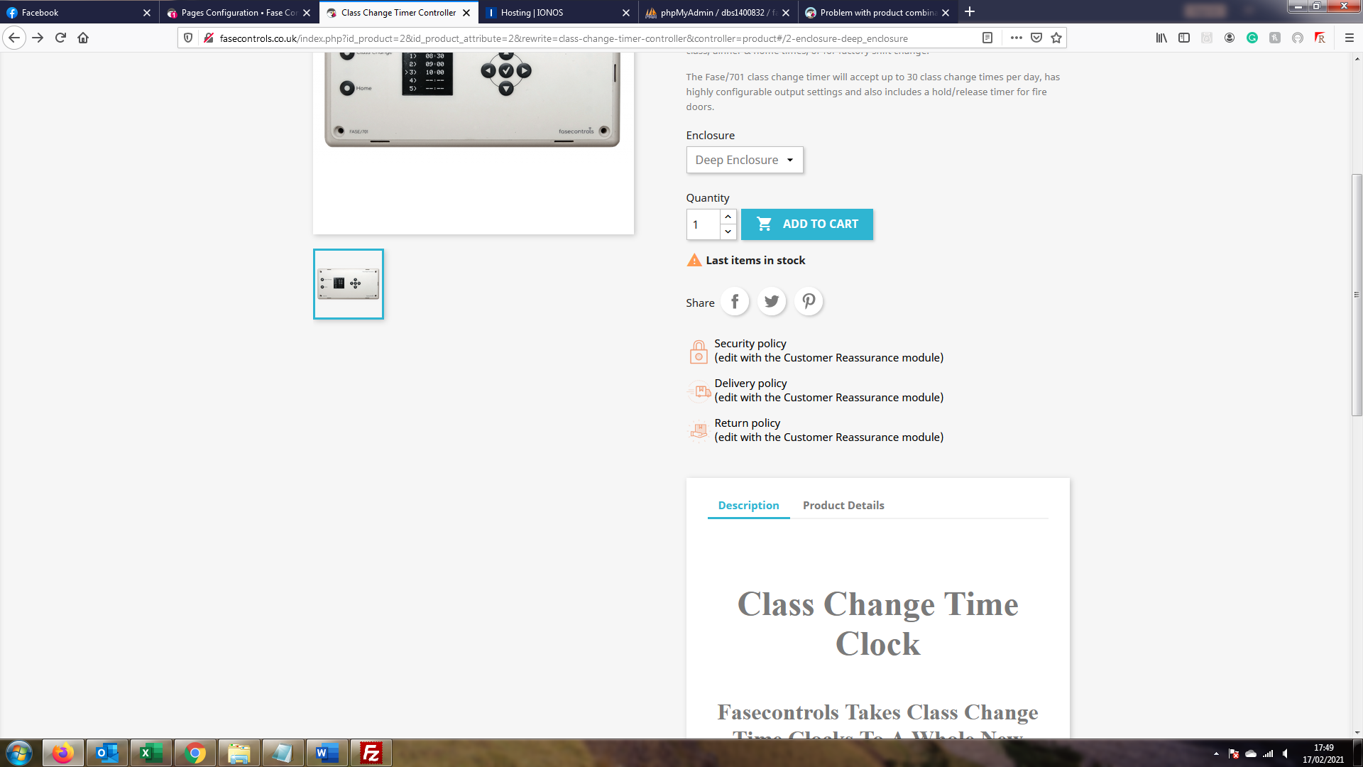

ianditch Posted February 16, 2021 Share Posted February 16, 2021 I'm really struggling with this! When i add a combination then this shows as it should on the product page. However, if i then add a second combination then this does not show and only the 1st combination is displayed. No matter what i do, i cant display the 2nd combination and deleting the 1st combo will then show the 2nd but not both together. I hope that makes sense? Is this something i'm doing wrong? I originally thought this was due to a template issue (im using the ps_apparel theme) but the default theme is doing the same and not showing the 2nd combo. Also, I can see the 1st combo group in the page source but not the 2nd combo group. Can anybody cast any light on this for me? Ian Link to comment Share on other sites More sharing options...

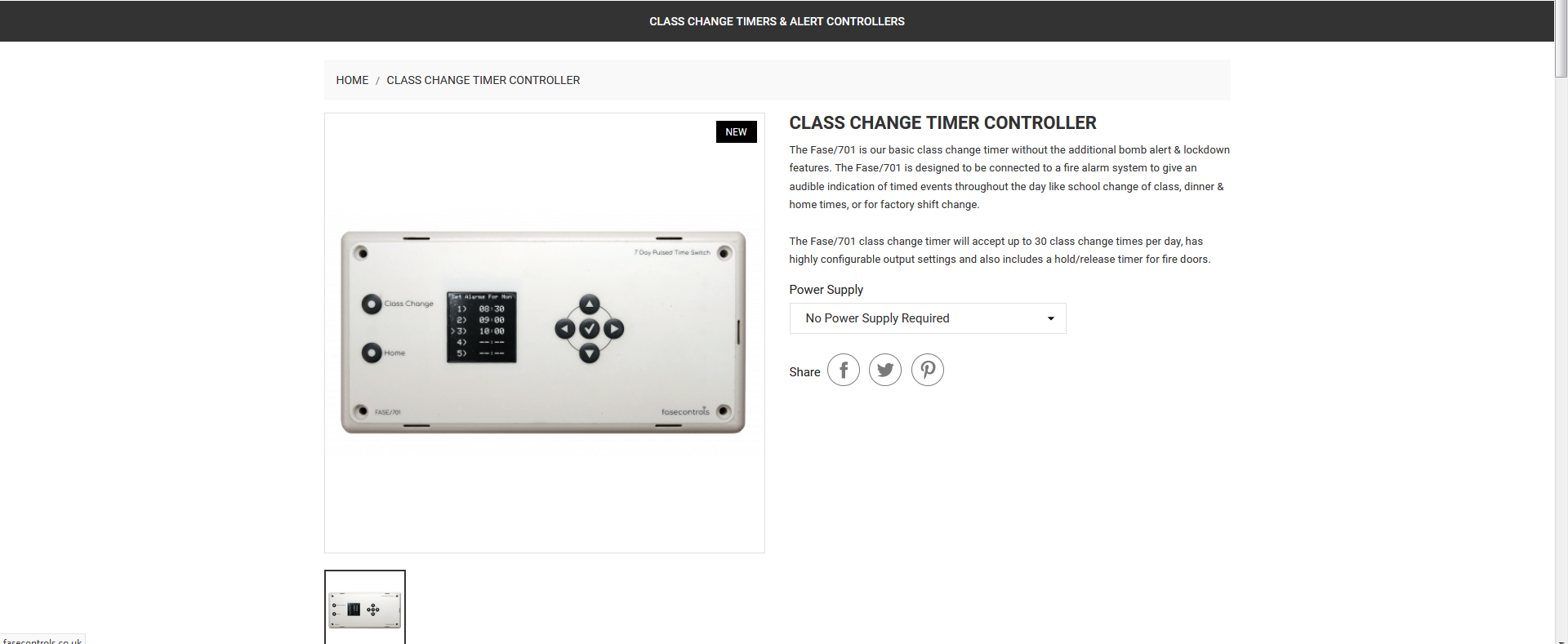

ianditch Posted February 17, 2021 Author Share Posted February 17, 2021 So, I've deleted my original installation and reinstalled. I've not added any additonal themes or altered any settings but the combinations are exactly the same on the new install with the default theme??? The theme is showing in 2 columns as shown in the picture. Is this correct? Link to comment Share on other sites More sharing options...

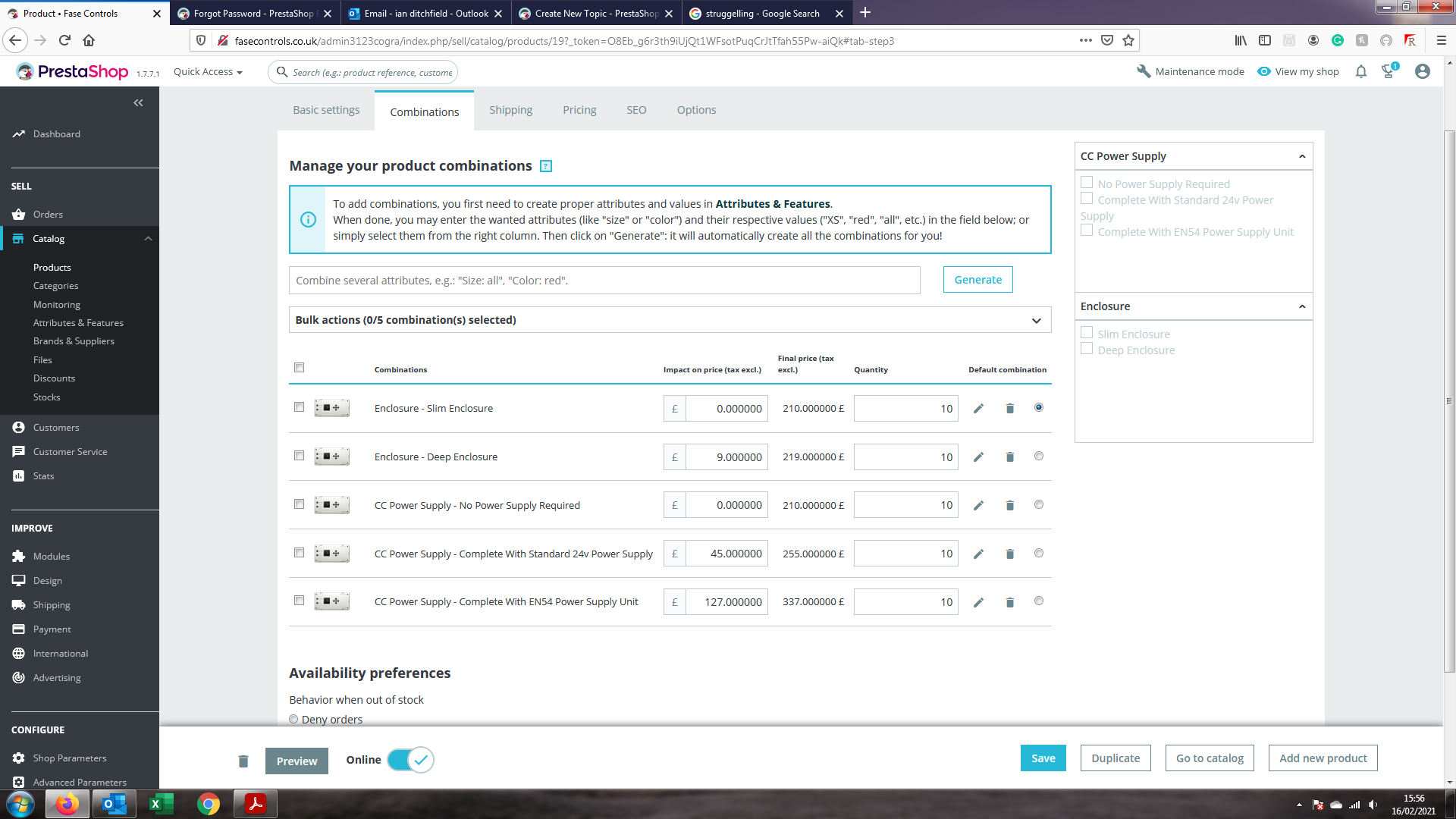

ianditch Posted February 20, 2021 Author Share Posted February 20, 2021 Thanks for your help musicmaster. I did finally suss this in the end.... You HAVE to add all combinations in 'one shot'. I was adding my enclosure type and then adding my power supply type and generating each time. This does not work and gives the effect as i have detailed above on the front store. If you select all required options and then hit generate it works. 1 Link to comment Share on other sites More sharing options...
