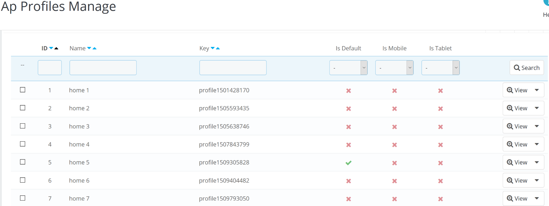

Francisterni Posted February 11, 2021 Share Posted February 11, 2021 Hello everyone, I am quite new to Prestashop, I did a search around but I could not find an answer and I hope not to make one too trivial I have Prestashop 1.7, with a purchased theme module (at_elise Version 3.0.8), through the Ap Page Builder page I have seen that you have different home page solutions (as per attached image1.png), and my default is home5, what I don't understand is because if I change the home page 5 and preview I see my changes correct, while if I do View My Shop I don't see the changes I made, the strange thing is that when I preview I see https: //mysite/it/home-5.html while when I do Preview only https: // mysite / it / it is as if "the link" to the two things is missing. Thanks in advance to anyone who can help me Link to comment Share on other sites More sharing options...
Prestachamps Posted February 11, 2021 Share Posted February 11, 2021 Hi, you should enable debug mode and check if there are any errors on the page. Also you should check if the module appagebuilder is enabled. Another option is to disable the overrides and check the site that way. Let me know what happens in these cases. Kind regards, Leo Link to comment Share on other sites More sharing options...
