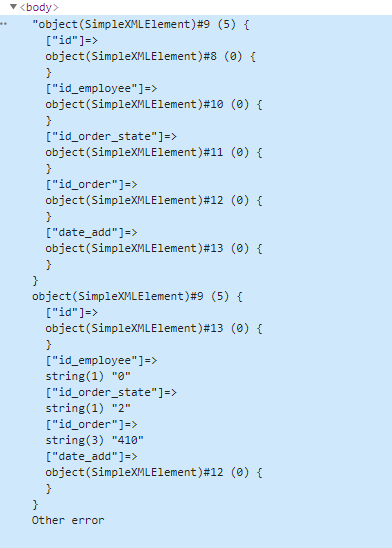

I have been trying for a long time to update the status of an order from php with the prestashop webService library.
First I have tried to download the order, modify the "current_state" attribute and upload it via edit, without positive result, I always get the error message "other error"
Now I have seen that you can add an entry in "order_histories" but I am also unable to make it work:
 $estadoID = (int)$_POST['estadosSelect'];
    $idPedido = $_GET['id'];
    $tienda = $_GET['tienda'];
    $webService = $this->webServiceTienda($tienda);
     try{
            $opt = [
                'resource' => 'order_histories?schema=blank'
            $xml = $webService->get($opt);
            $resources = $xml->children()->children();
			var_dump( $resources );
            $resources->id_order = intval($idPedido);
            $resources->id_employee = 1;
            $resources->id_order_state = intval($estadoID);
            $opt = [
                'resource' => 'order_histories',
                'postXml' => $xml->asXML()
            $createdXml = $webService->add($opt);
            var_dump( $createdXml );
     }catch (PrestaShopWebserviceException $e){
         $this->controlErrores($e);
var_dumps:

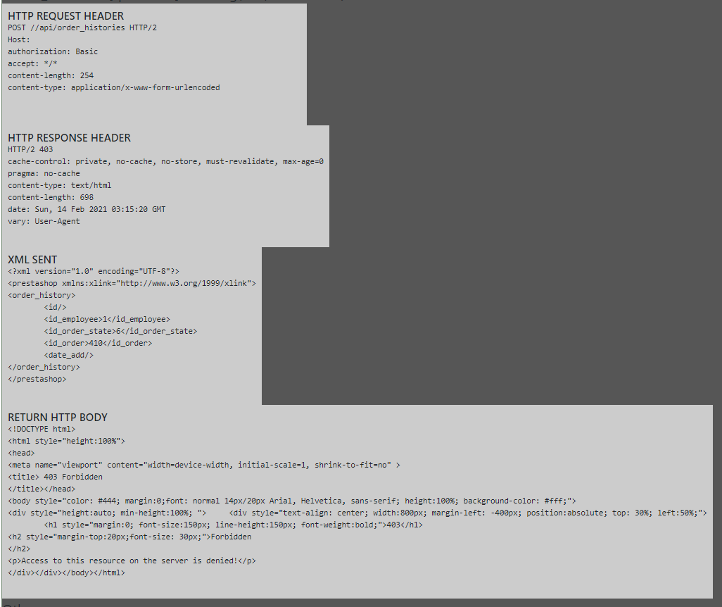

I have 3 stores connected in the program and two of them throw me the error 403
Is it supposed to be a server problem? Does the hosting have to fix it?
The funny thing is that two of these websites are on the same hosting, different server but same hosting.
HTTP / 1.1 403 Forbidden
<p> Access to this resource on the server is denied! </p>
EDIT:
I have spoken with my host and the problem was with the PHP security module.
They have added some rule and now it works perfect
