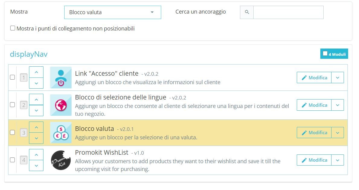

Roberto Remondini Posted February 5, 2021 Author Share Posted February 5, 2021 I'm not sure if is the correct way to check it, but in positions I found this. Link to comment Share on other sites More sharing options...
