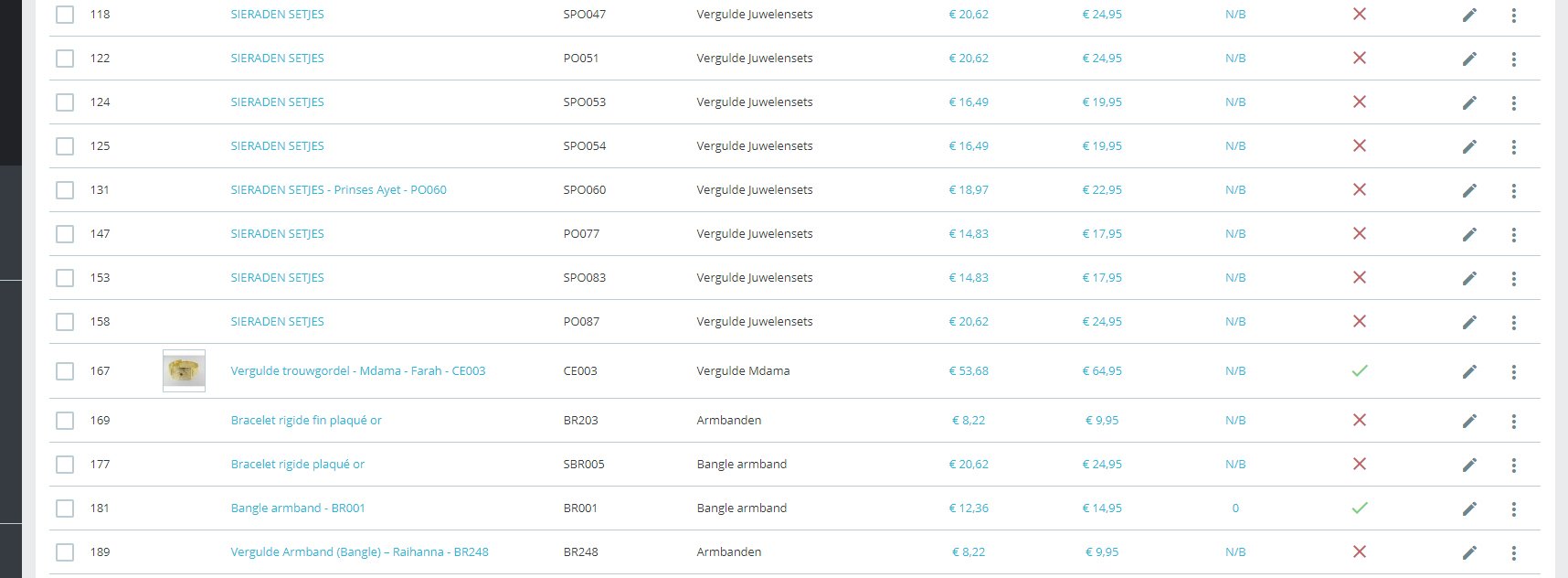

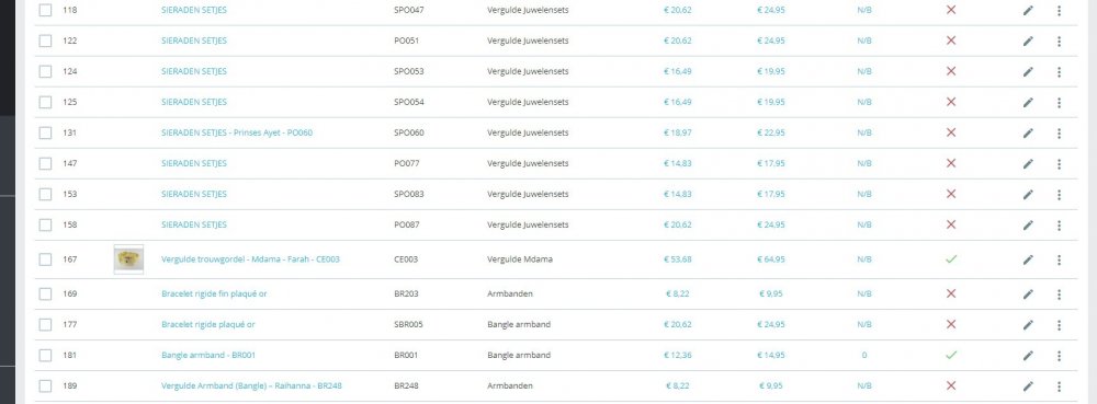

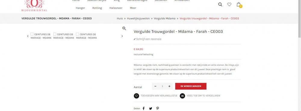

Prestafreek Posted February 3, 2021 Author Share Posted February 3, 2021 (edited) Hi, First I installed new 1.7.7.1 default theme, then I uploaded new theme and migrated everything manually from old database. Almost everything works fine except for the product images that are not visible. (not even in admin) Where did I go wrong.? Edited February 3, 2021 by Prestafreek (see edit history) Link to comment Share on other sites More sharing options...
musicmaster Posted February 3, 2021 Share Posted February 3, 2021 42 minutes ago, Prestafreek said: First I installed new 1.7.7.1 default theme, then I uploaded new theme and migrated everything manually from old database. Almost everything works fine except for the product images that are not visible. (not even in admin) Where did I go wrong.? Images are not visible, but the product text is there? You talk about migration. So this is a new installation? In that case: did you copy the /img directory? Link to comment Share on other sites More sharing options...

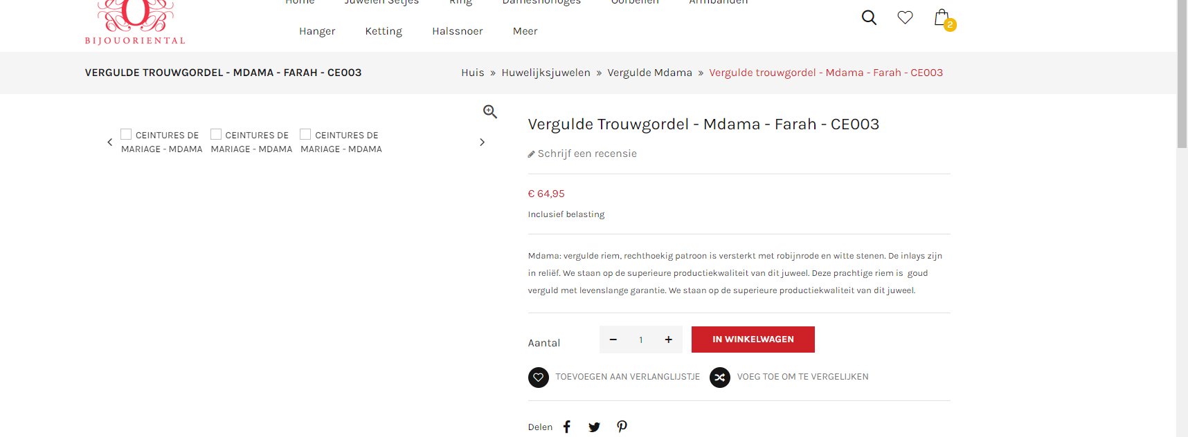

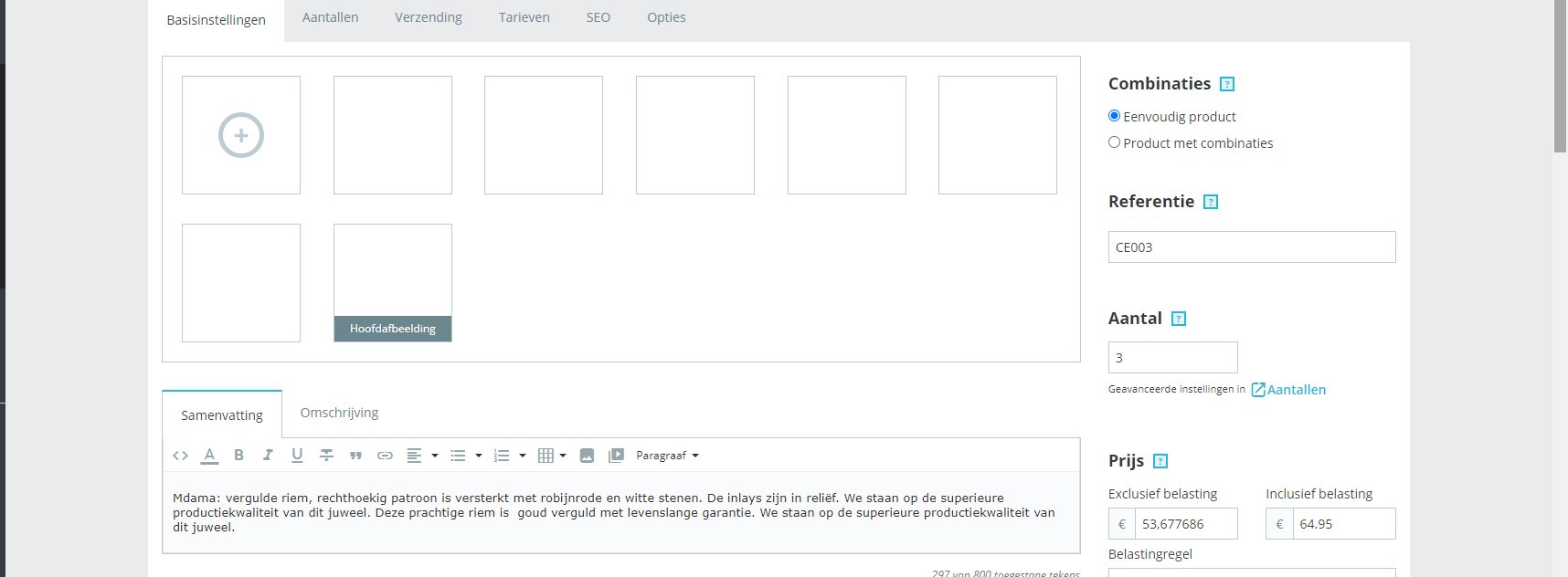

Prestafreek Posted February 4, 2021 Author Share Posted February 4, 2021 Yes i did copy img directory. I added 3 images manually. (+4 migrated)So total of 7 images They are visible in admin products but not in admin products detail. They are visible in frontend when i click on zoom-in otherwise not visible link to product/images i added https://www.quickzi.eu/test5/nl/vergulde-mdama/167-vergulde-trouwgordel-mdama-farah-ce003.html Link to comment Share on other sites More sharing options...

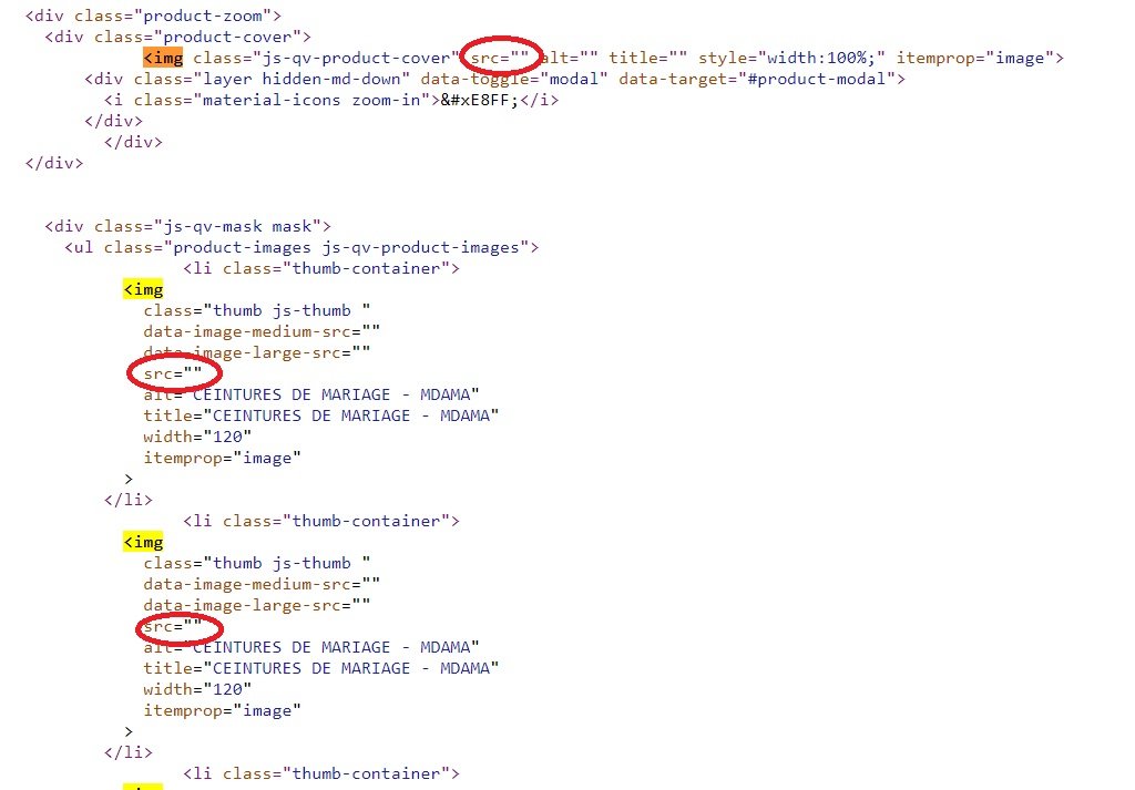

musicmaster Posted February 4, 2021 Share Posted February 4, 2021 When I look at the source code of the page in the browser I see that the images are not defined (see attached image). So there is something wrong with the coding. But to know what would require knowledge of the code. And answer to the question whether you made any changes. BTW when i look at the link you sent I don't see any image. Link to comment Share on other sites More sharing options...

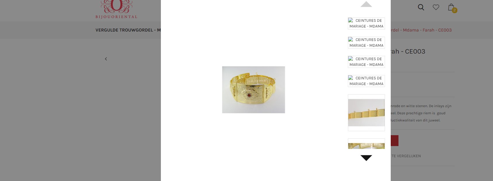

Prestafreek Posted February 4, 2021 Author Share Posted February 4, 2021 Yes i have seen that but there were no changes made in the code. Did you click the zoom button? (magnifying glass) Then the 3 images i added manually are visible. The others i migrated from the old website should be somewhere in the img/c or img/s ...... folder but i can't find them Another example https://www.quickzi.eu/test5/nl/oorbellen/2302-vergulde-hangende-oorringen-anya-bo294.html Click on the magnifying glass and the images i added manually are there, the migrated are not <img class="js-modal-product-cover product-cover-modal" width="1000" src="https://www.quickzi.eu/test5/13475-thickbox/vergulde-hangende-oorringen-anya-bo294.jpg" alt="" title="" itemprop="image"> How can i solve this? Link to comment Share on other sites More sharing options...
musicmaster Posted February 5, 2021 Share Posted February 5, 2021 Product images are under the /img/p directory (c is for categories) So you have two problems: - Most image files aren't there (with an exception for the newly entered) - There is something broken in your code that makes that you don't see even the newly entered images This is not Prestashop's fault. Nearly certain you did things wrong. Try removing .htaccess. That way you will be able to see how the file system is organized. For example https://www.quickzi.eu/test5/13475-thickbox/vergulde-hangende-oorringen-anya-bo294.jpg can be found at https://www.quickzi.eu/test5/img/p/1/3/4/7/5/13475.jpg Link to comment Share on other sites More sharing options...
