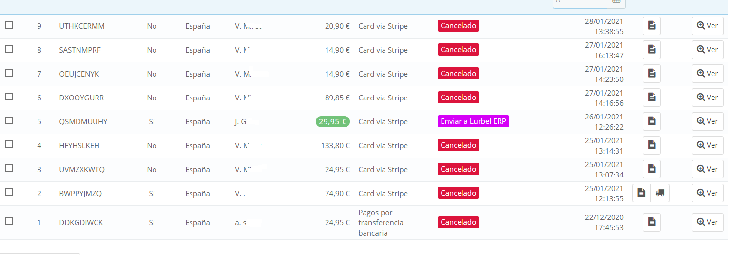

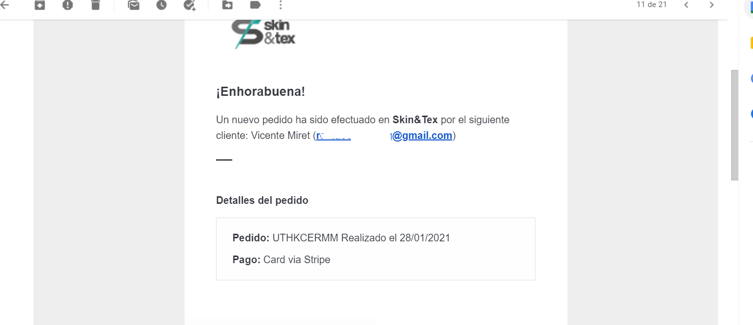

crash_999 Posted January 28, 2021 Share Posted January 28, 2021 Hi, I am having issues to find the name that shows in the invoices for Stripe. In al the places shows as payment/ Payment method: Card via Stripe and I cannot find this translation or the file to change it. Does anyone knows where to find it? Thanks! Link to comment Share on other sites More sharing options...

xemin Posted June 5, 2021 Share Posted June 5, 2021 @crash_999 Just found the solution. Word "Card" is on file : prestashop/modules/stripe_official/stripe_official.php line 172. Second part "via Stripe" is on: prestashop/modules/stripe_official/classes/actions/ValidationOrderActions.php line 316. You may set your description on stripe_official.php and on the second file you can remove the other part and leave it blank. After updating these two files try to make a test order and you will see at order's payment description is your custom name. Link to comment Share on other sites More sharing options...
