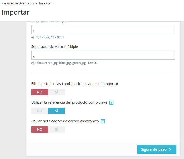

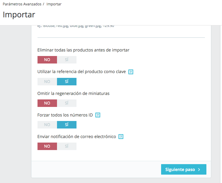

Looking for solutions I found your questions.
Yes you have to import products first. Use your own reference as ID and Force ID
When you upload combinations you have to use your reference you already know as ID
I write in english as I came from spanish forum. You can use Google translator.
Thanks mate, it's a good solution, and I found also the parameter "Utilizar la referencia del producto como clave" ("Utiliser la référence du produit comme clé" pour les français)
which is very useful and this way we keep consistency with the ids :)
