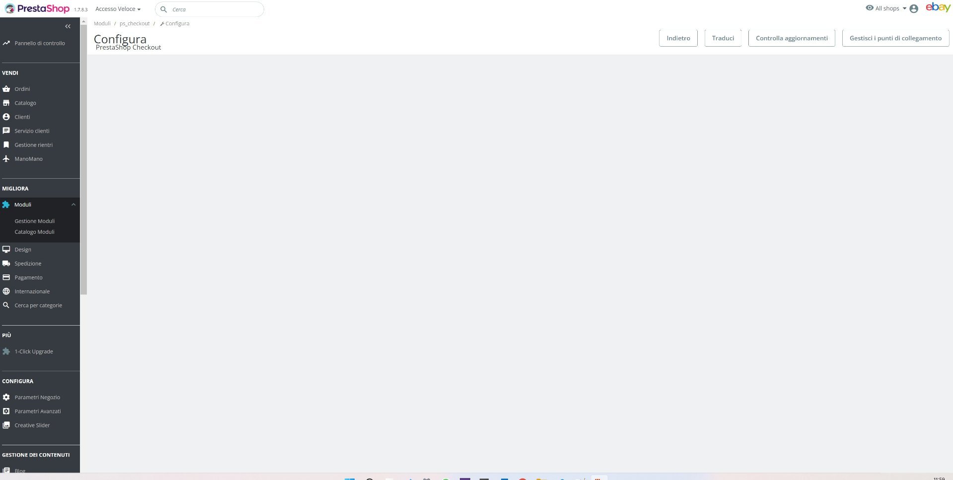

PietroWeb Posted January 22, 2021 Share Posted January 22, 2021 Hello, I've a problem with Prestashop Checkout 2.3.0+ module. After install if I click on the configure button an empty page is showed and is not possible to configure the module. This with prestashop v1.7.7.0 and checkout v2.3.0 at first. Then I've tried various module upgrade (2.4.0, 2.5.0, 2.5.1) but the problem persists. In attachment a screenshot of the configuration page. It is more then a week I've this problem. I've contacted Prestashop Support and they say have forwarded the problem to their development team and let me know. But I've received no answer after that. So I've send other two mail to the support, asking for news/updates to this problem, always no answer. Is there anyone having this problem too and/or has a solution for this? Ufortunately we are stopped at this, and customer begin to stress, because he need to be live at the end of the month. Thank you in advance. Regards Pietro Link to comment Share on other sites More sharing options...

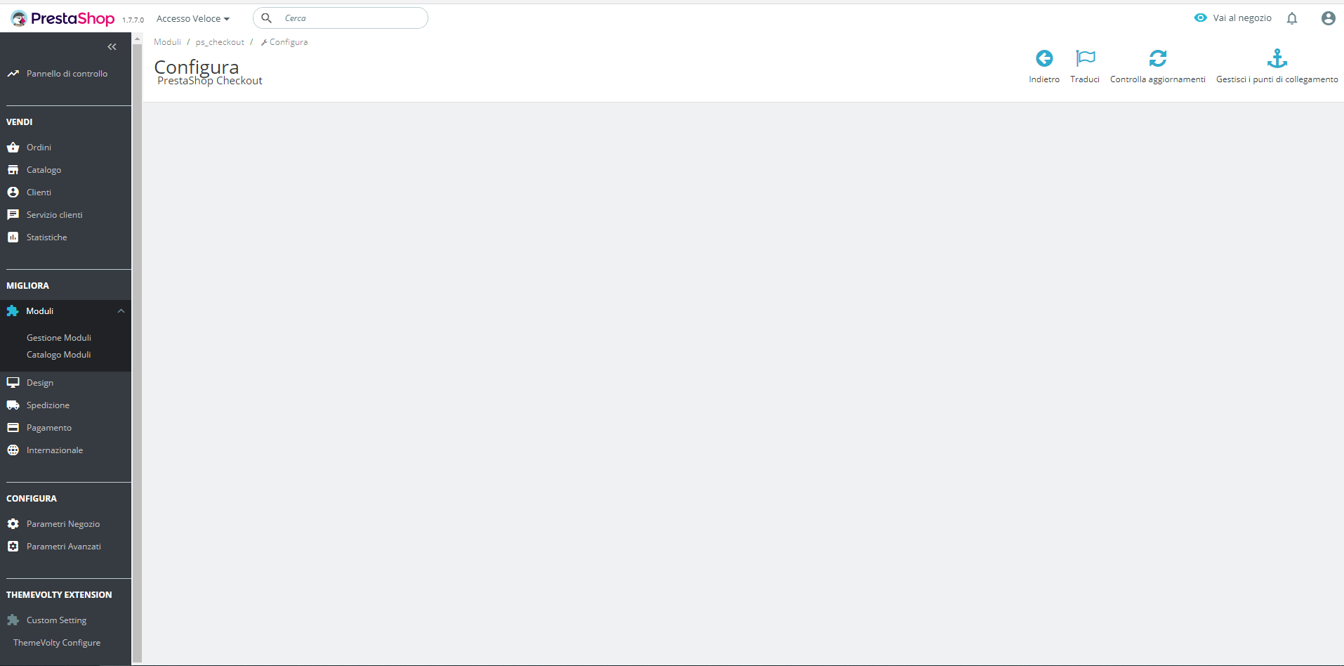

ceca19 Posted January 25, 2021 Share Posted January 25, 2021 Hello, I have the same problem. I followed these steps: - I have installed and reinstalled the ps_checkout module several times - I cleared the caches bo and manually - I checked the page's html to look for app.js but the problem persists. Please how can I solve? I am very disheartened and I don't know what to do anymore I use PS 1.7.7 Linux Server Information # 1 SMP Fri Mar 13 09:20:40 EDT 2020 x86_64 Server software version: Apache PHP Version: 7.3.23 Memory limit: 512M Maximum execution time: 300 Max. Size of files to upload: 128M Thanks in advance for the help Link to comment Share on other sites More sharing options...

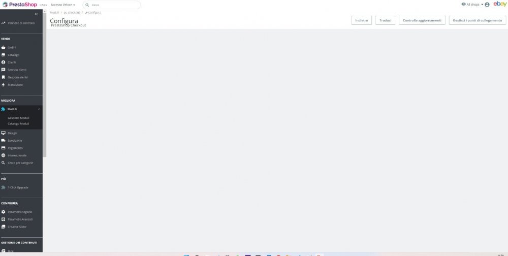

dideccoavo Posted January 30, 2022 Share Posted January 30, 2022 Good morning, i have the same problem with the Prestashop Checkout module. When I click on configure nothing appears. I have installed all versions of PS Checkout up to 2.16 but it doesn't work. I contacted the developers of the module but they didn't answer me. If you have a solution, please help me. Link to comment Share on other sites More sharing options...

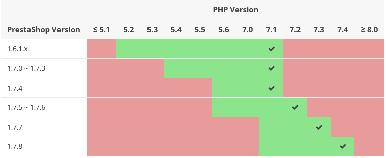

dideccoavo Posted January 30, 2022 Share Posted January 30, 2022 The prestashop version is 1.7.8.3 The PHP version is 7.3.33 I deleted the contents of var / cache / I reinstalled the module, but nothing. Attached is what appears when I click on configure. Link to comment Share on other sites More sharing options...
ComGrafPL Posted January 30, 2022 Share Posted January 30, 2022 Php for 1.7.8.3 must / should be 7.4 1 Link to comment Share on other sites More sharing options...
Janett Posted January 30, 2022 Share Posted January 30, 2022 Maybe you have a module named tvcmscustomsetting from ThemeVolty Team This module is known to break PrestaShop Checkout configuration page. Link to comment Share on other sites More sharing options...
dideccoavo Posted January 30, 2022 Share Posted January 30, 2022 I had the ThemeVolty theme, but I uninstalled it, and I uninstalled all the connected modules by deleting them from the modules folder. I realized it was a bad theme with a lot of bugs. But I think it didn't depend on this because now I have another theme the ps checkout module doesn't work anyway. Link to comment Share on other sites More sharing options...
dideccoavo Posted January 30, 2022 Share Posted January 30, 2022 (edited) I'm running prestasho on PHP 7.4.27 but nothing changes. Prestashop checkout is not working. Edited January 30, 2022 by dideccoavo (see edit history) Link to comment Share on other sites More sharing options...
Nickz Posted January 30, 2022 Share Posted January 30, 2022 1 hour ago, dideccoavo said: I'm running prestasho on PHP 7.4.27 but nothing changes. try php 7.3 php versions most of the times depend on the modules. Your core can run on 7.4 but if one module won't follow issues arise. Link to comment Share on other sites More sharing options...
dideccoavo Posted January 30, 2022 Share Posted January 30, 2022 My prestashop runs on PHP 7.3. I switched to PHP 7.4 on the advice of ComGrafPL. But prestashop checkout doesn't work on PHP 7.3 or PHP 7.4 either Link to comment Share on other sites More sharing options...
