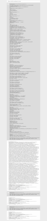

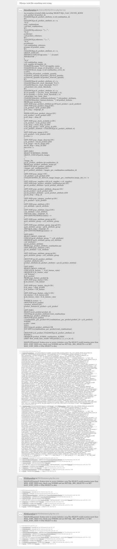

DanielaPetkova Posted January 25, 2021 Author Share Posted January 25, 2021 Even if i rename the .php file nothing has changed in back office. MysqliConnection.php or DbMySQLi.php. Everything is working normal in the BO even without both files. So they are not in use or there is some cache that i don't know. Continue searchin what is going on. Here is a screenshot of the error i'm fighting with. Usually it happens after i added new product eve thow they are not a lot. After deleting and re-adding is all good but not now. Link to comment Share on other sites More sharing options...
