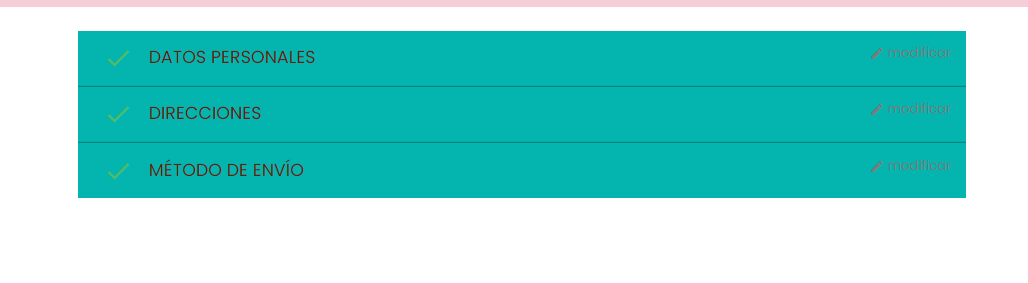

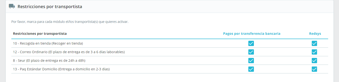

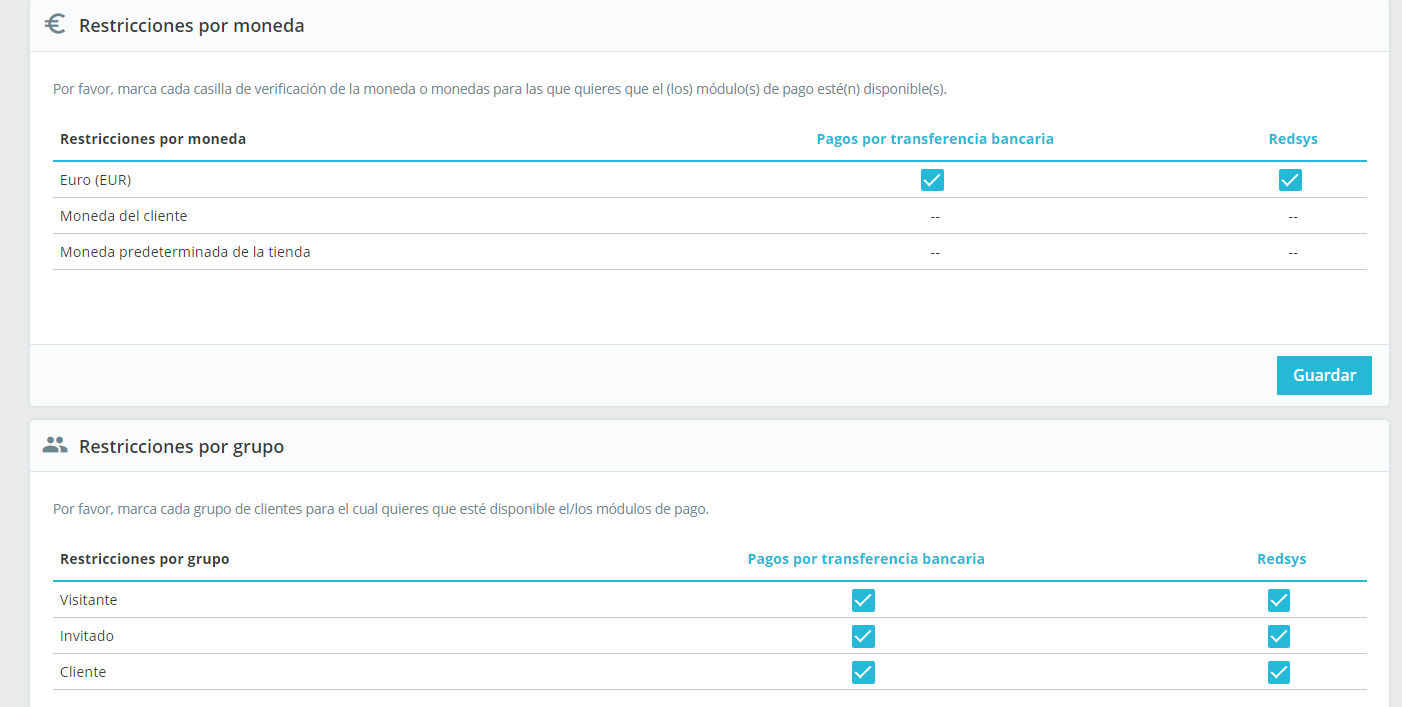

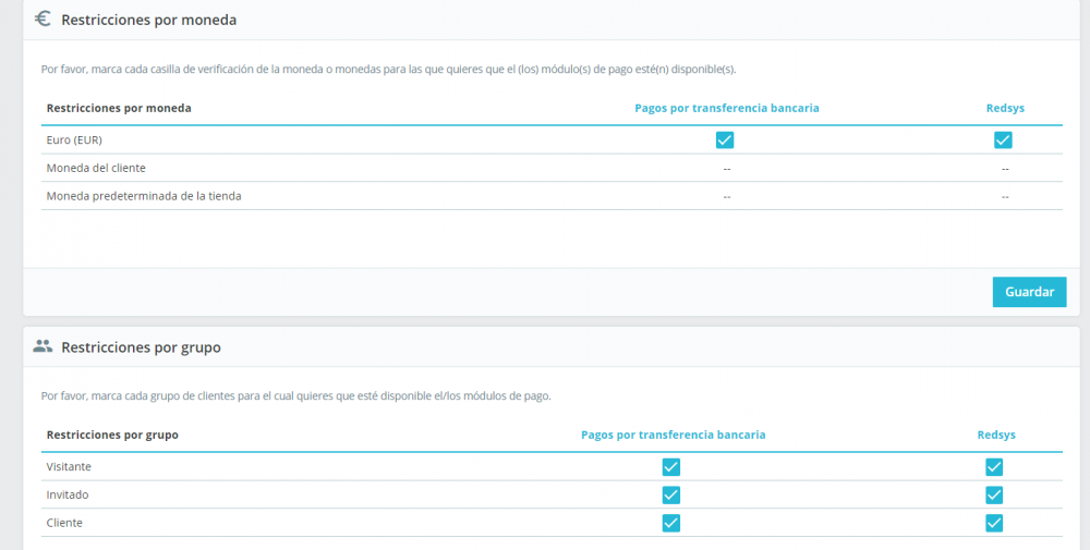

christiaannn Posted January 18, 2021 Share Posted January 18, 2021 Hello, After the last update the payment part does not appear. The payment methods should appear. I have checked inside the payment configuration and it looks like this: The module is by Redsys. URL page: https://lapapeleriadelola.com/ Could you helpme please. Thanks. Link to comment Share on other sites More sharing options...
