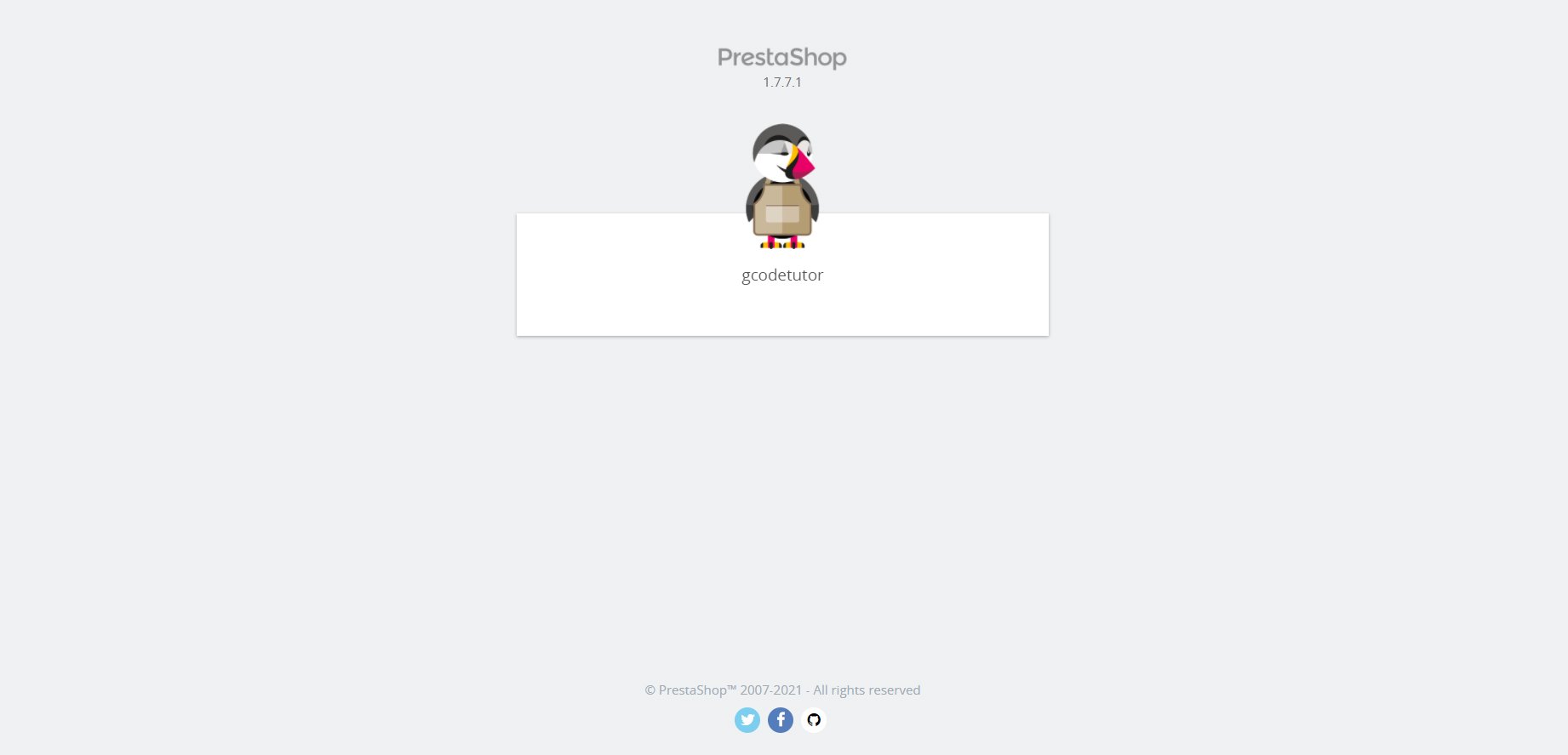

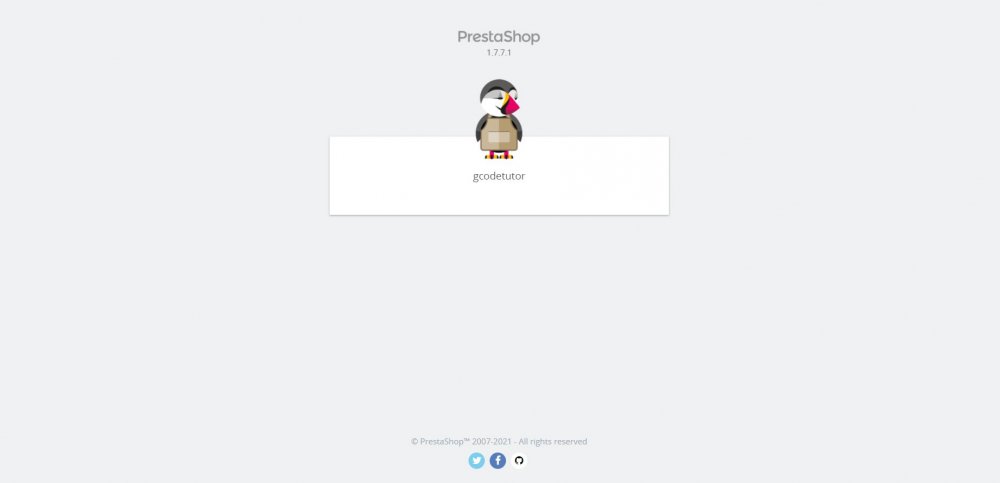

GCodeTutor Posted January 18, 2021 Share Posted January 18, 2021 Once I have installed Prestashop 1.7.7.1 , on the login screen, after I type my credentuals the screen hangs as shown in the attached screenshot. I have my php verson set to 7.2, permissions are 0755 for folders and 0644 for files. I am at a loss, any ideas what I can do to fix this issue? I am installing on a sub domain. I installed prestashop using the same setup, on the same server but with a differnet site/subdomain yesterday and had no issues so I dont understand why its not playing ball with me on this subdomain. some more info: with defines.inc.php file error reporting set to true I get this return: Parse error: syntax error, unexpected 'const' (T_CONST), expecting variable (T_VARIABLE) in /home2/gcodetutor/store.gcodetutor.com/classes/Tools.php on line 43 Chrome dev tools returns this error: Failed to load resource: the server responded with a status of 500 (Internal Server Error) Any ideas what else I can try? Thanks in advance Marc Link to comment Share on other sites More sharing options...
