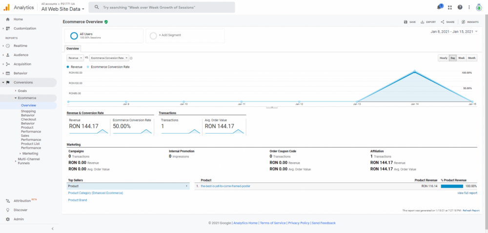

2. Not that my word wouldn't be enough, but here is the screenshot ;)
3. The module version is 4.0.0.
4.Nope- I was using the UA code!
In case you need access to the fresh installed store, let me know. Wouldn't be a problem, just send me an email on PM. I can give you access to the fresh Analytics account as well, but if I could throw a look on your URL would make more sense. Won't you agree? ;)

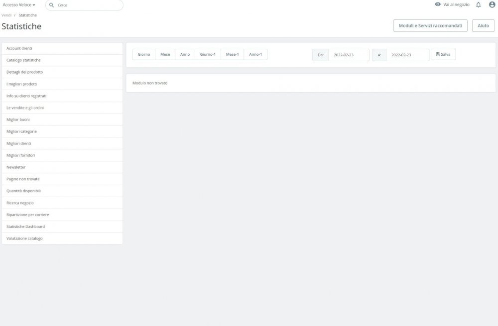

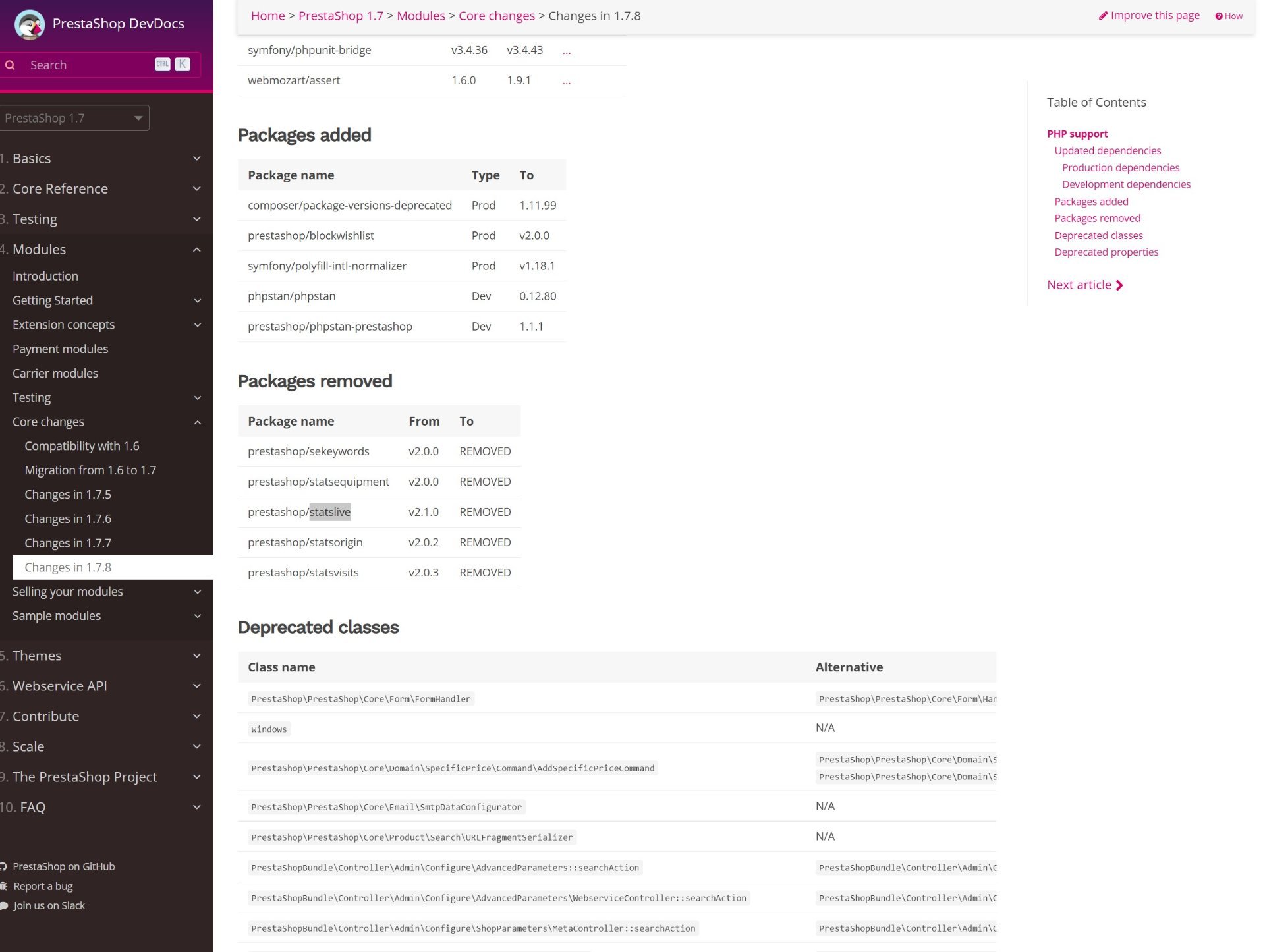

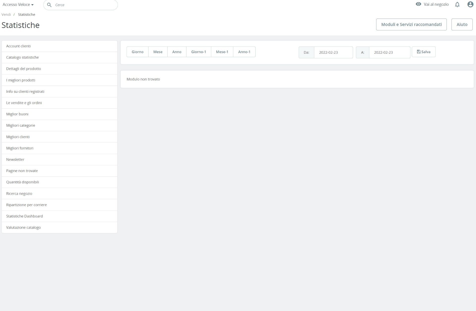

Hello Leo, Paolo here,
I installed the GA module Prestashop (version 4.03) entering my UA ID. I log into the google analytics profile and see all the data correctly.
Unfortunately I don't see the data in the prestashop 1.7.8.3 control panel. Do you have any idea why?
Tks for your time.
Edited by mirkodescalchi (see edit history)
Hi,

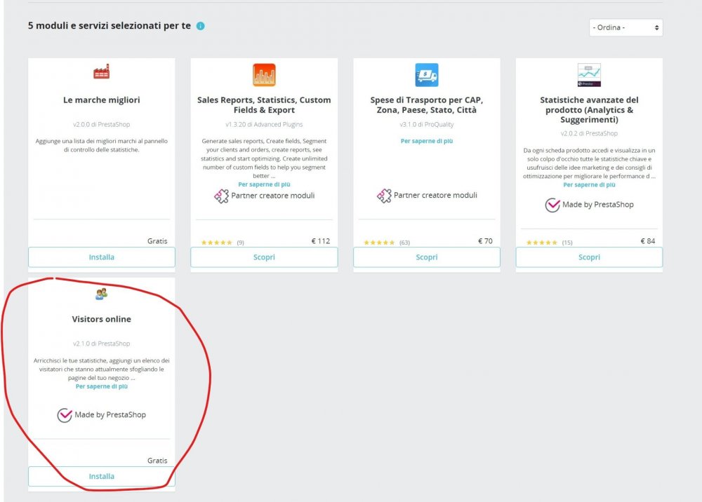

All options you see on the lefthand menu are separate modules. Make sure you install and activate all stat's modules in Prestashop.
Go to the Modules Catalog section - search for stats and add all free PS related modules.
Once those are done it will start populating the data.
Make sure also that the "Data Mining for Statistic " module (Core Prestashop module) is activated as well.
I hope it helps,
Leo
  • Thanks 1
