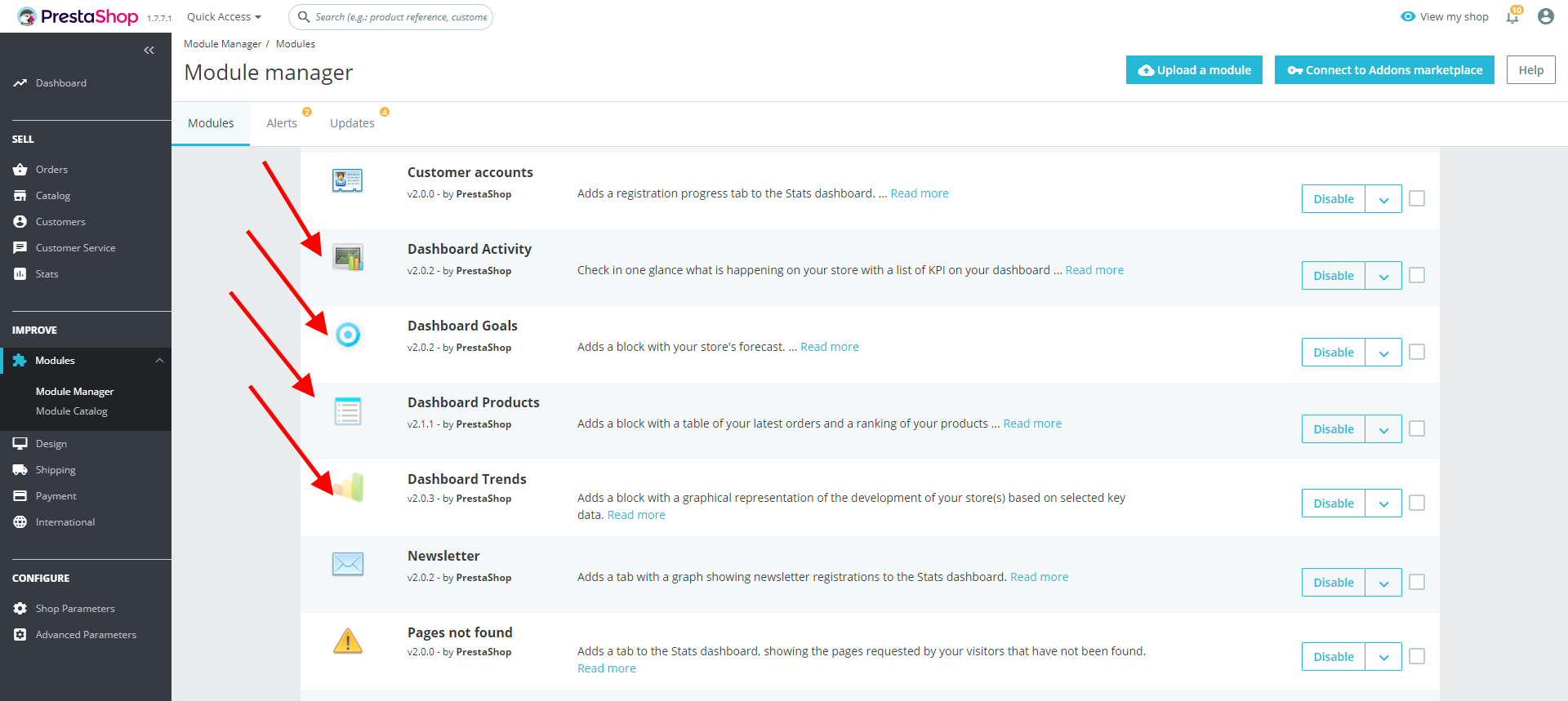

Prestachamps Posted January 14, 2021 Share Posted January 14, 2021 Reset the following ones (see image) and Data mining for statistics 1 2 Link to comment Share on other sites More sharing options...
Marcel van As Posted January 14, 2021 Author Share Posted January 14, 2021 Thank you Leo, this helped me solving the issue. The module for datamining for statistics was no longer enabled after the update. Enabling the module fixed the issue. I also noticed a few more modules that were disabled after the update: newsletter, presta comments, presta metrics were also disabled. Link to comment Share on other sites More sharing options...
