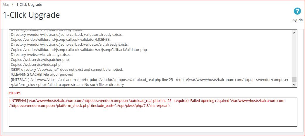

DraganK Posted January 13, 2021 Share Posted January 13, 2021 (edited) Hello! I'm just start to prepare my first Prestashop e-shop, and this upgrade is my first Prestashop upgrade. It's 1.7.7.0 instalation from scratch. No modification. Classic Theme, for the moment... I'm using CentOS 7 with MariaDB 5.5.68 and PHP 7.3.26 After upgrade (with "1-click-upgrade" module ) from 1.7.7.0 to 1.7.7.1, I have recevied following error: [INTERNAL] /var/www/vhosts/bal****.com/httpdocs/vendor/composer/autoload_real.php line 25 - require(): Failed opening required '/var/www/vhosts/bal****.com/httpdocs/vendor/composer/platform_check.php' (include_path='.:/opt/plesk/php/7.3/share/pear') And after Rollback to 1.7.7.0. , I have received sql error for following sql line: CREATE TABLE `ps_access` ( `id_profile` int(10) unsigned NOT NULL, `id_authorization_role` int(10) unsigned NOT NULL, PRIMARY KEY (`id_profile`,`id_authorization_role`) ) ENGINE=InnoDB DEFAULT CHARSET=utf8mb4 - Table 'ps_access' already exists And after sql error, I have received another error: [INTERNAL] /var/www/vhosts/bal****.com/httpdocs/config/config.inc.php line 122 - Error: Call to a member function getName() on null #0 /var/www/vhosts/bal****.com/httpdocs/modules/autoupgrade/classes/UpgradeContainer.php(550): require_once() #1 /var/www/vhosts/bal****.com/httpdocs/modules/autoupgrade/classes/TaskRunner/AbstractTask.php(120): PrestaShop\Module\AutoUpgrade\UpgradeContainer->initPrestaShopCore() #2 /var/www/vhosts/bal****.com/httpdocs/admin030c07uzv/autoupgrade/ajax-upgradetab.php(52): PrestaShop\Module\AutoUpgrade\TaskRunner\AbstractTask->init() #3 {main} Any idea how to solve the problem? Recover server backup? And after that, how to upgrade? Also, I'm little scared... If Prestashop has this kind of problem for minor upgrade, what will happened with next minor or major upgrade after I put the web on production mode? Best regards Edited January 13, 2021 by DraganK (see edit history) Link to comment Share on other sites More sharing options...

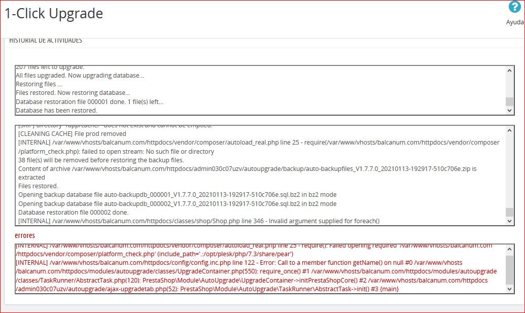

DraganK Posted January 13, 2021 Author Share Posted January 13, 2021 I did recovery of whole server I have tried one more time to do upgrade And result is, more or less, the same First error is the same as the first time Second error is different than first time!!!! Here is the screenshots of upgrade.... And here is the screenshot after ther Rollback: Link to comment Share on other sites More sharing options...
