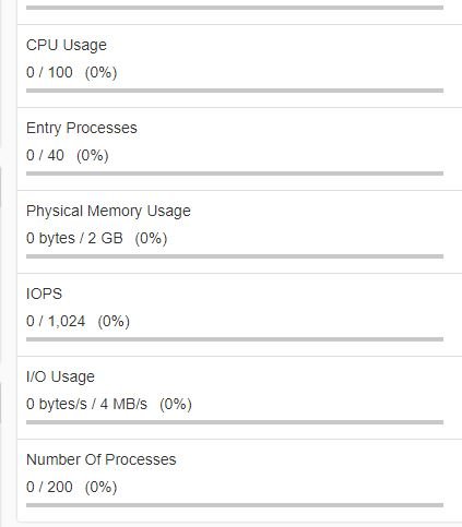

HETPE3B Posted January 11, 2021 Author Share Posted January 11, 2021 But at least it's working with 7.4 without the problems that it had while it was set to 7.3. I was asking my hosting provider about the ICU - I guess the guy in the support didn't have a clue what's it was, so I gave up on that What's this abbreviation stands for? May be I'll be able to explain it better next time to online support. Link to comment Share on other sites More sharing options...
JBW Posted January 12, 2021 Share Posted January 12, 2021 8 hours ago, HETPE3B said: I was asking my hosting provider about the ICU - I guess the guy in the support didn't have a clue what's it was, so I gave up on that What's this abbreviation stands for? May be I'll be able to explain it better next time to online support. http://site.icu-project.org/home 1 Link to comment Share on other sites More sharing options...
