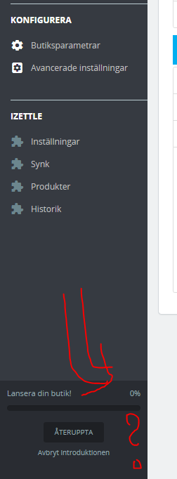

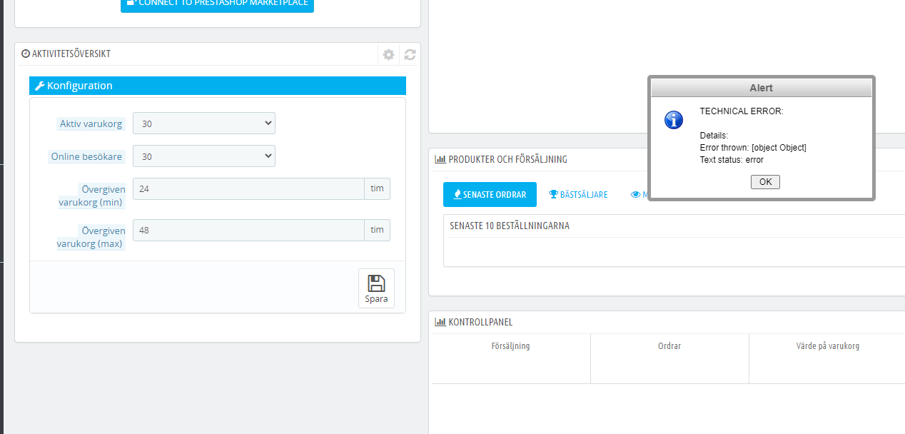

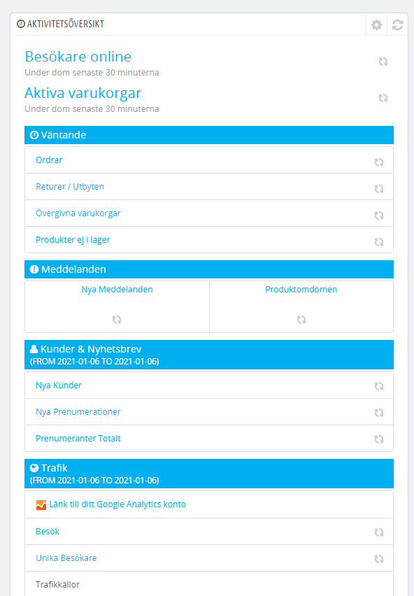

KarlskronaGF Posted January 6, 2021 Share Posted January 6, 2021 I've just installed my first Prestashop. I followed the tip and installed the demo-products. SO - as I understand it, i should have a working web-shop. BUT - I must have done somethong wrong, on not correct enough... When I go to the admin, Control panel, my Activity over view doesn't load... Orders, REturns, cutomers.. they just keep on turning... If I try to change the data - I get an error.... As I understood it - if I installed it with some demo-products the shop schould be up and running? It isn't. I can reach the admin page but not the shop. - "To many redirects..." In the lower left corner I have a progress indicator. In swedish - Lansera din butik, translated: "Launch your shop". It´s on 0%!! Can´t be right... The installation went OK - but whats wrong now?? Link to comment Share on other sites More sharing options...

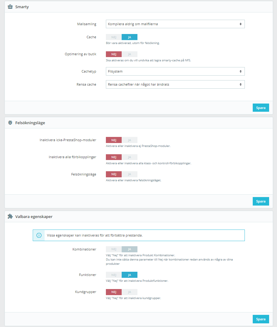

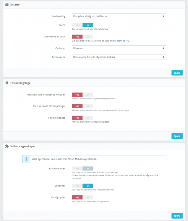

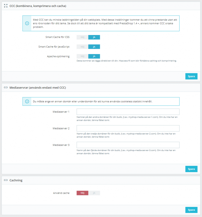

Prestachamps Posted January 6, 2021 Share Posted January 6, 2021 Hi, That's only a module which lead's you through the presentation and usage of PS. IS the frontend working ? Go to advance Parameters and than performance. Send us the screenshot from it. Cheers, Link to comment Share on other sites More sharing options...
KarlskronaGF Posted January 6, 2021 Author Share Posted January 6, 2021 (edited) No - thats the problem... FrontEnd NOT workin... Tried the same setup on on another web-hoster and it worked - but can´t use that host for this shop... /F Edited January 6, 2021 by KarlskronaGF (see edit history) Link to comment Share on other sites More sharing options...
