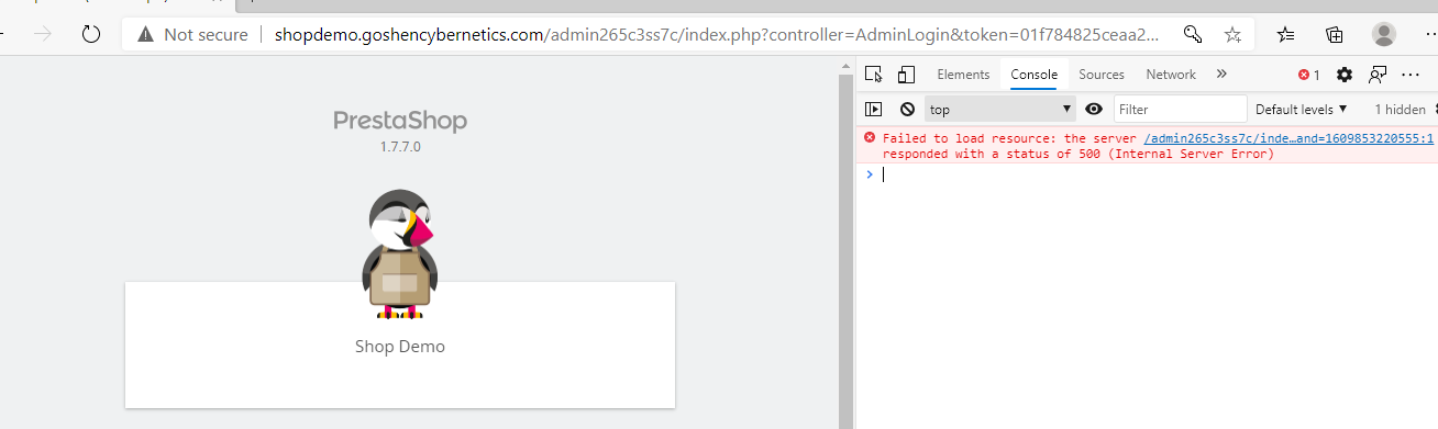

rubincabalida Posted January 5, 2021 Share Posted January 5, 2021 >Type error: idn_to_utf8() expects parameter 3 to be integer, string given</p> <p class="mb-0">[Symfony\Component\Debug\Exception\FatalThrowableError 0]</p> </div> when i tried to check the Network above is the error: PHP Version 7.3.25 PrestaShop: 1.7.7.0 I need help please, somebody encountered this error? Link to comment Share on other sites More sharing options...
JBW Posted January 6, 2021 Share Posted January 6, 2021 Check your ICU version and update if lower than 4.6. https://github.com/PrestaShop/PrestaShop/issues/22300 Link to comment Share on other sites More sharing options...
