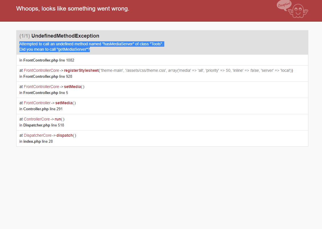

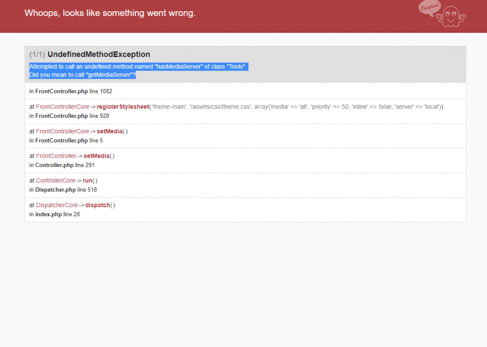

Jose Lorenzini Posted October 21, 2021 Share Posted October 21, 2021 I still having this issue Attempted to call an undefined method named "hasMediaServer" of class "Tools". Did you mean to call "getMediaServer"? can someone please help me!! thanks Link to comment Share on other sites More sharing options...
JBW Posted October 24, 2021 Share Posted October 24, 2021 After upgrade can have to adjust/upgrade the theme, modules and overrides to be compatible with the new version Link to comment Share on other sites More sharing options...
Jose Lorenzini Posted October 25, 2021 Share Posted October 25, 2021 9 hours ago, JBW said: After upgrade can have to adjust/upgrade the theme, modules and overrides to be compatible with the new version Hi , thanks for your answer, the problem is i dont know where should i start , could you please give me a cloue? thanks :) Link to comment Share on other sites More sharing options...
JBW Posted October 25, 2021 Share Posted October 25, 2021 3 hours ago, Jose Lorenzini said: Hi , thanks for your answer, the problem is i dont know where should i start , could you please give me a cloue? First check with your theme developer if they have a new version - if yes download and install. Then check your override folder. If there are files open them to see if they originate from a module - then upgrade the module or contact the developer. Check all modules for upgrades. If it doesn't help, deactivate them and re-activate 1 by 1 to find the gulty one. Before doing any of these always do a full backup of store and database. And never ever do any Presta upgrade directly on your live shop, always test it on a clone before. 1 Link to comment Share on other sites More sharing options...
Jose Lorenzini Posted October 25, 2021 Share Posted October 25, 2021 hi jb Thank you very much for your recommendations, this is our mirror site luckily, I am going to start doing them now and I will tell you how I am doing, we are using a template from a developer https://prestabuilder.com, we tried to contact him several times but he never contacted us he seems be inactive, I will try what you recommend and i will let you know how i am going with this, thank you Link to comment Share on other sites More sharing options...
