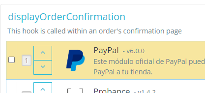

litzer Posted July 21, 2023 Share Posted July 21, 2023 (edited) Same here. It seems that this is not going to be fixed: https://github.com/202ecommerce/paypal/issues/154 You can try: https://stackoverflow.com/a/60399611/9632384 Edited July 21, 2023 by litzer (see edit history) Link to comment Share on other sites More sharing options...
litzer Posted July 21, 2023 Share Posted July 21, 2023 OK, this worked for me: ensure you have PayPal at the top of displayOrderConfirmation's hook. Link to comment Share on other sites More sharing options...
Track Posted August 7, 2024 Share Posted August 7, 2024 @litzer thread revival! Where exactly would I find these settings please? Link to comment Share on other sites More sharing options...
litzer Posted August 7, 2024 Share Posted August 7, 2024 On 8/7/2024 at 9:01 AM, Track said: @litzer thread revival! Where exactly would I find these settings please? Expand Is hook management panel at Design > Positions Link to comment Share on other sites More sharing options...
Track Posted August 7, 2024 Share Posted August 7, 2024 Thanks for that! I've done as you said. Hopefully this fixes things. Link to comment Share on other sites More sharing options...
