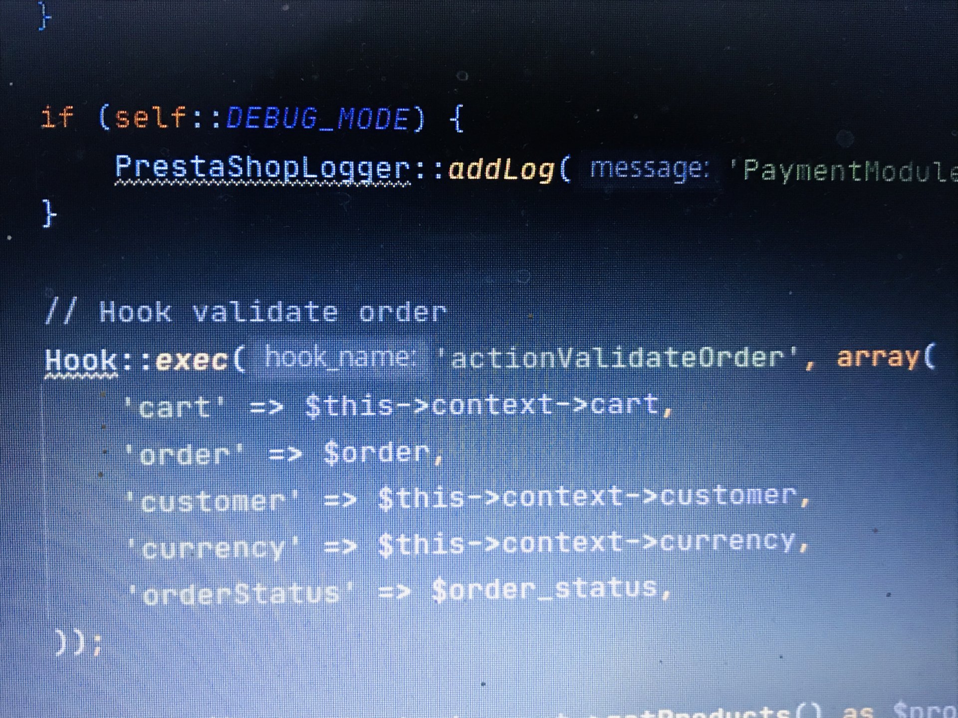

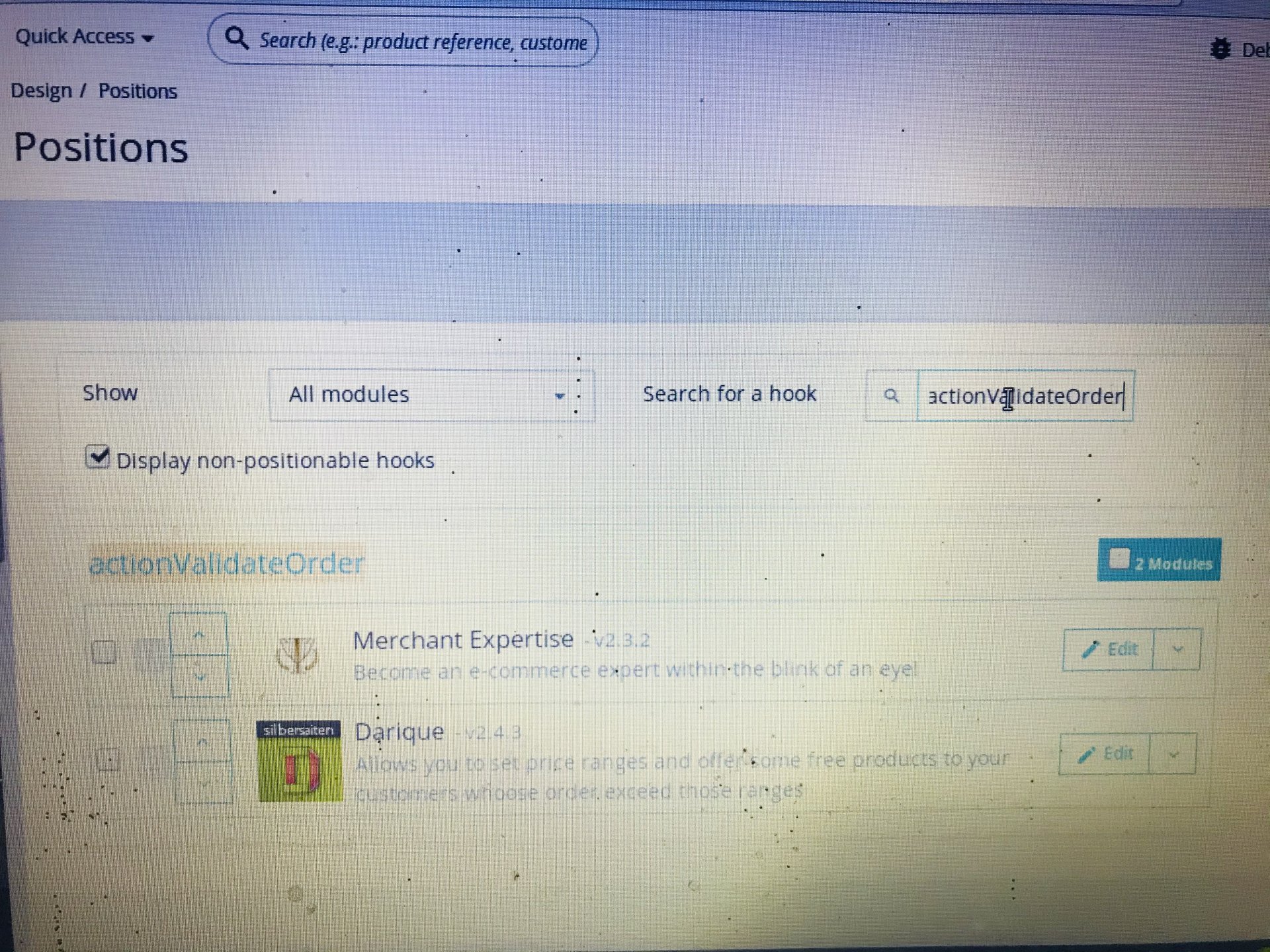

Web Engg. Posted December 14, 2020 Share Posted December 14, 2020 Hi you can follow below steps to debug that 1) verify hook was Registered properly from back office in Design > Positions tab when you search the hook you registered by checking display non positionable hooks, it will show your module in list and order too see screenshot 1 2) Rather than making die make a log and see that data, the data at hook contains cart ,order ,customer , currency and status data as in screenshot 2 3) enable debug mode Link to comment Share on other sites More sharing options...
