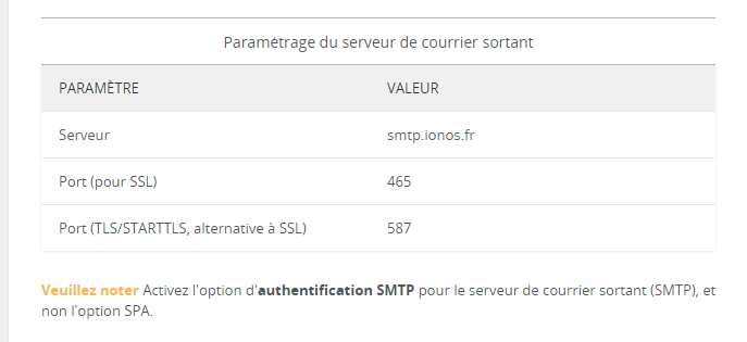

Eolia Posted December 11, 2020 Share Posted December 11, 2020 Euh.... quelle doc ??? https://www.ionos.fr/assistance/email/sujets-generaux/parametres-pour-les-programmes-de-messagerie/ Link to comment Share on other sites More sharing options...

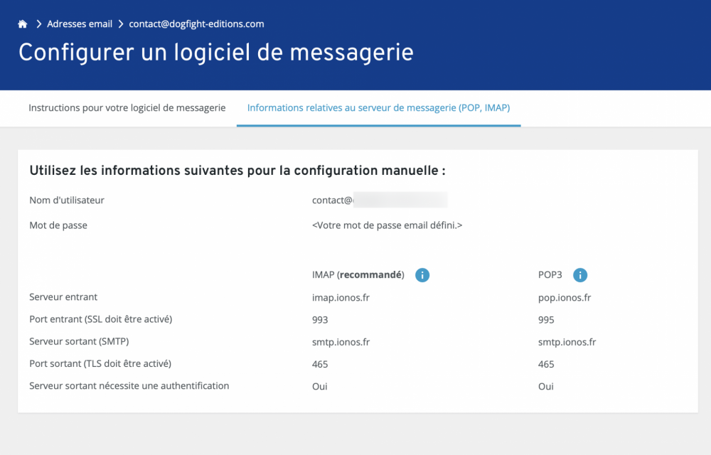

RVBCocardes Posted December 11, 2020 Author Share Posted December 11, 2020 Link to comment Share on other sites More sharing options...
RVBCocardes Posted December 11, 2020 Author Share Posted December 11, 2020 (edited) ils sont très forts chez IONOS !!! 😂 ... et moi aussi 😉 j'ai caché une adresse mail mais pas l'autre ! enfin, c'est fait ! Edited December 11, 2020 by RVBCocardes (see edit history) Link to comment Share on other sites More sharing options...
Eolia Posted December 11, 2020 Share Posted December 11, 2020 Ben en IMAP c'est 993 mais du coup le serveur est imap.ionos.fr^^ Link to comment Share on other sites More sharing options...
doekia Posted December 11, 2020 Share Posted December 11, 2020 smtp !! serveur: smtp.ionos.fr port: 465 tls actif (pas starttls) Vous devez mettre les logins de votre compte email ionos Link to comment Share on other sites More sharing options...
