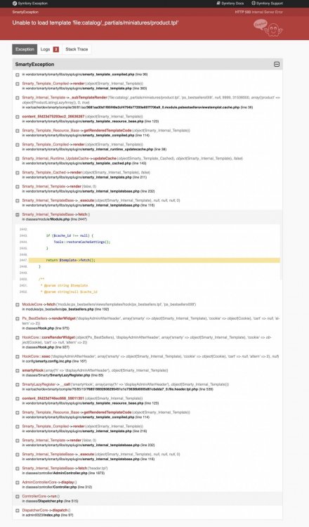

voxlubalin Posted December 10, 2020 Share Posted December 10, 2020 Hi, thank you for any help. I was trying to change something in a module (block "greffer section" I think), and suddenly I get this error , that I meet each time I try to enter the Admin panel : Oops! An Error Occurred The server returned a "500 Internal Server Error". I put debug mode. It was question of a file into owlpageTitle, so I temporary desactivated the module. Ok, but now, the previous message has been replaced by another (worth one...) and I absolutely don't know what to do... Thank for your help & lights Link to comment Share on other sites More sharing options...

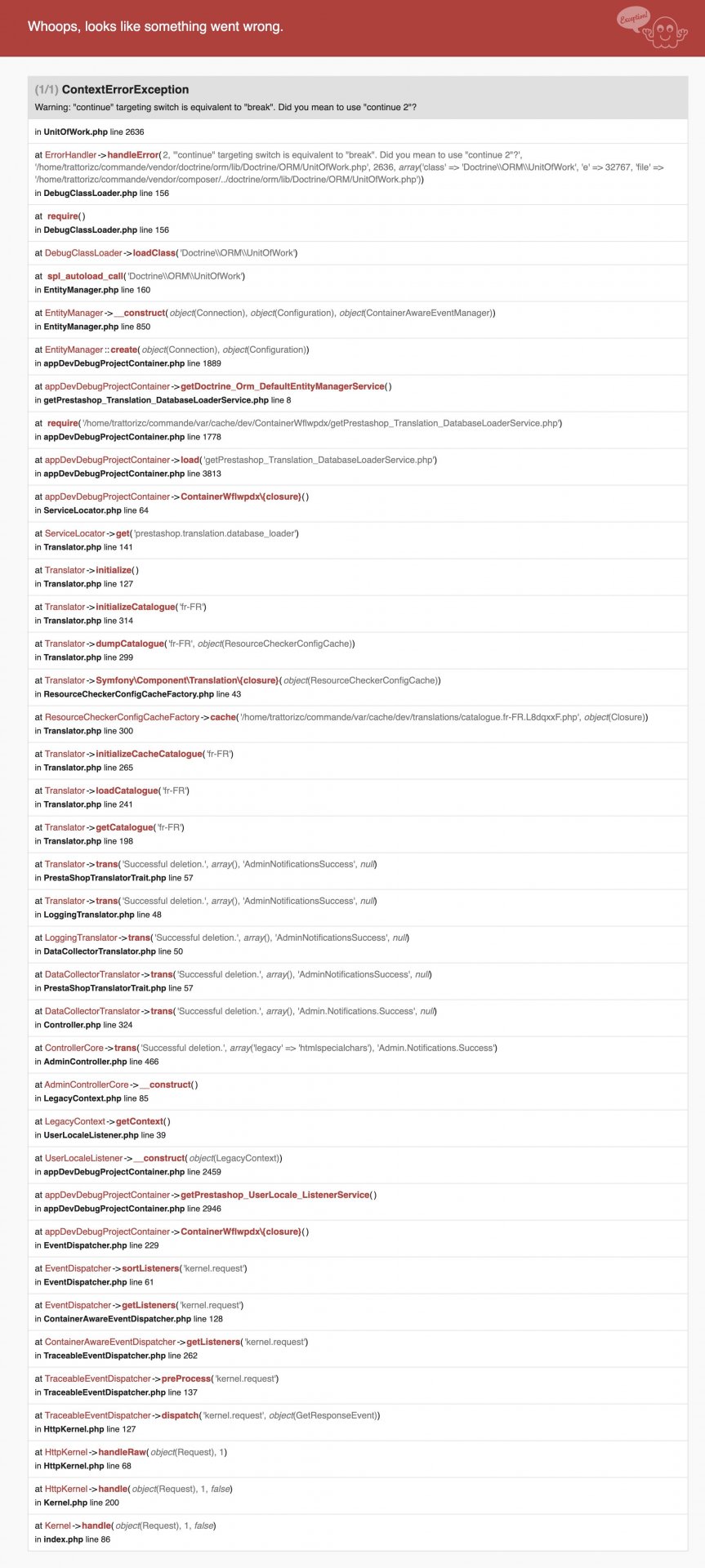

Guest Posted December 10, 2020 Share Posted December 10, 2020 PHP 7.1 or PHP 7.2 and clear cache ( or delete ./var/cache/dev and prod directory) Link to comment Share on other sites More sharing options...
voxlubalin Posted December 10, 2020 Author Share Posted December 10, 2020 Thank you, I did it. Better because I can put my email and password, but after the login, I'm in front of an error message again... Link to comment Share on other sites More sharing options...

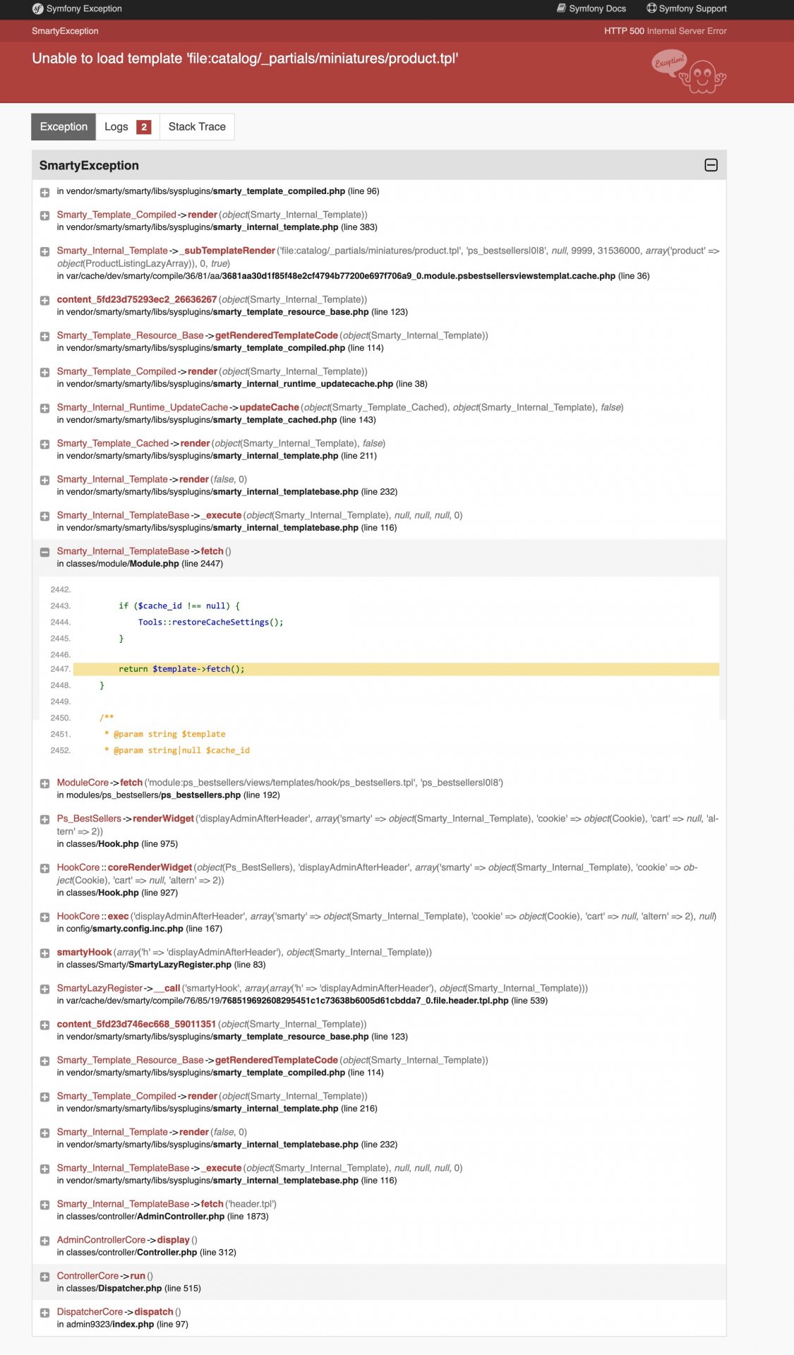

voxlubalin Posted December 10, 2020 Author Share Posted December 10, 2020 I've replaced/erased my directory modules, tried differents things, but now the error message is " Unable to load template 'file:catalog/_partials/miniatures/product.tpl' Although the file is IN the folder... Prestashop seems so complicated and hazardous at the same time 🙄 Link to comment Share on other sites More sharing options...
