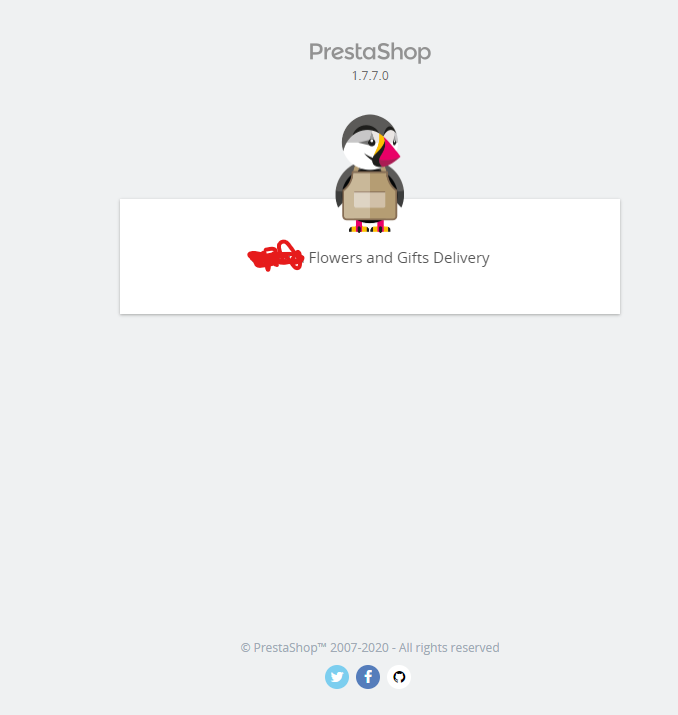

pietpetoors Posted December 7, 2020 Share Posted December 7, 2020 I tried to upgrade from 1.7.6.5 to 1.7.7.0 and as usual it failed. This time I cannot log into admin panel I used 1 click upgrade (which in 6 years never ever worked) Any idea where to start searching for the problem? I just get the friendly page in pic below after I entered my details and click login. Nothing else Link to comment Share on other sites More sharing options...
enio19 Posted December 8, 2020 Share Posted December 8, 2020 same Link to comment Share on other sites More sharing options...
pietpetoors Posted December 8, 2020 Author Share Posted December 8, 2020 I reverted back to the previous version. What happened is I used the 1 click upgrade. 1 Click successfully updated all the files and successfully updated the database. But when I tried to log into admin panel to take site out of maintenance mode I could not log in. Thus 1 Click said everything was successful but it was not. Link to comment Share on other sites More sharing options...

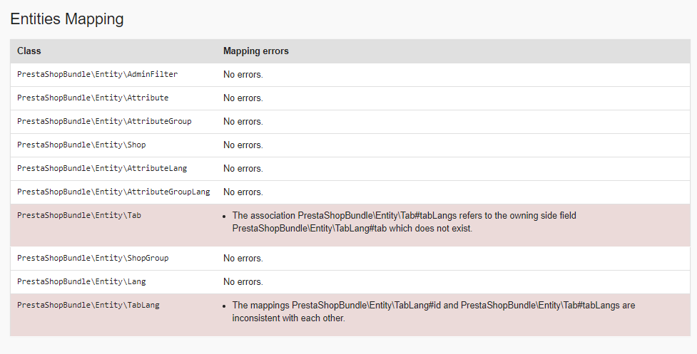

ArnasL Posted December 8, 2020 Share Posted December 8, 2020 Guys I have same problem. I tried to update from 1.7.6.8 to 1.7.7.0 and now I can't access BO and FO. I just keep seeing errors: https://www.dropbox.com/s/eyfbucigek4oq7s/Screenshot 2020-12-08 at 18.26.37.png?dl=0 I have tried previously updates from 1.7.6.2 to .. to 1.7.6.8 and all succeed. Now when I started upgrading I get instant error (3-5s after click Ugprade) that upgrade failed and I was unable to access BO and FO. Please help? Link to comment Share on other sites More sharing options...

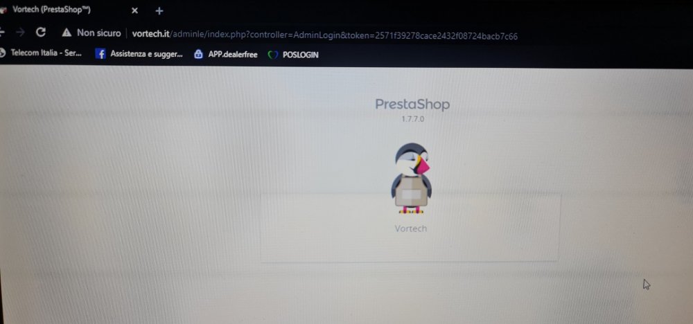

xpprof Posted December 8, 2020 Share Posted December 8, 2020 Hello , i have installed prestashop 1.7.7.0. I' ve the same problem. Help me please Link to comment Share on other sites More sharing options...

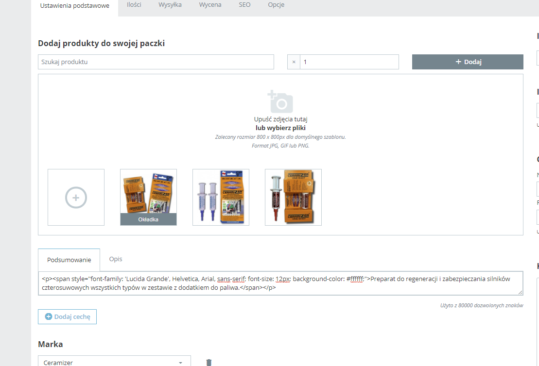

Artur PL Posted December 11, 2020 Share Posted December 11, 2020 I've changed to 7.3 and I could open BO. But it doesn't work well. For example if I want to edit product, I cannot add pictures (add picture button not work - its not active, it blinks but with no reaction), cannot also drug&drop picture, also same problems are with other buttons such as add brand tec. Is it a problem with communication with DB? Maybe upgrading from 1.7.6.5 to 1.7.7.0 with set up 7.2 php and after upgrade switched to 7.3 don't let good communication because somewhere it have coding for php 7.2 and old ICU??? I see products, but cannot edit it. Another example, previous set up description now looks like this: Link to comment Share on other sites More sharing options...
Artur PL Posted December 11, 2020 Share Posted December 11, 2020 I also have such problem frob debug/doctrine. I'm not a specialist to understand what shall I do? Link to comment Share on other sites More sharing options...

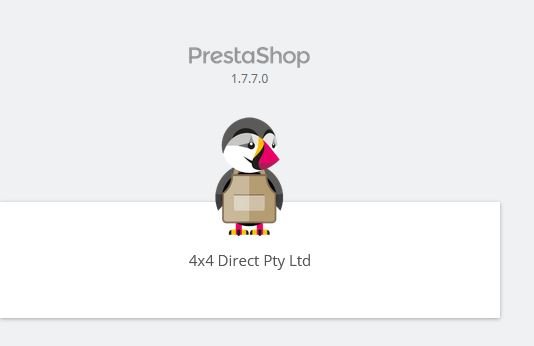

ssekazinga Posted December 31, 2020 Share Posted December 31, 2020 I installed a fresh copy of 1.7.7.0 and got the same issue - BO is not opening just a Prestashop Logo! as below. I tried it with Bluehost and inmotion - tried PHP 7.0 - 7.5 Link to comment Share on other sites More sharing options...
ssekazinga Posted December 31, 2020 Share Posted December 31, 2020 (edited) 18 minutes ago, ssekazinga said: I installed a fresh copy of 1.7.7.0 and got the same issue - BO is not opening just a Prestashop Logo! as below. I tried it with Bluehost and inmotion - tried PHP 7.0 Changing to PHP 7.4 from PHP 7.3 resolved the issue - i can access the BO after switching to PHP 7.4 Edited December 31, 2020 by ssekazinga (see edit history) Link to comment Share on other sites More sharing options...
