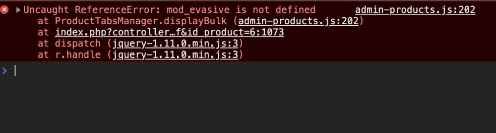

lakeup Posted November 26, 2020 Author Share Posted November 26, 2020 oui les caches navigateurs et prestashop vidés, erreur ci jointes Link to comment Share on other sites More sharing options...
Eolia Posted November 26, 2020 Share Posted November 26, 2020 Ah merde... j'avais corrigé le fichier mais pas le zip^^ admin-products.js Link to comment Share on other sites More sharing options...
lakeup Posted November 26, 2020 Author Share Posted November 26, 2020 (edited) Tu as bien fait de conserver ce fichier 😁 Ça fonctionne nikel, merci ! Edited November 27, 2020 by lakeup (see edit history) Link to comment Share on other sites More sharing options...
