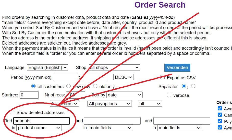

musicmaster Posted December 15, 2020 Share Posted December 15, 2020 Prestools can do such searches. SO you can just look how it does it. Link to comment Share on other sites More sharing options...
madpugger Posted December 18, 2020 Author Share Posted December 18, 2020 On 12/15/2020 at 8:44 PM, musicmaster said: Prestools can do such searches. SO you can just look how it does it. I’ve had a look at the demo and can’t see a way of finding this? Link to comment Share on other sites More sharing options...
musicmaster Posted December 19, 2020 Share Posted December 19, 2020 Order Search, where else? If you enable Verbose you will see the query. Link to comment Share on other sites More sharing options...
madpugger Posted December 19, 2020 Author Share Posted December 19, 2020 3 hours ago, musicmaster said: Order Search, where else? If you enable Verbose you will see the query. The demo version on their website doesn’t have this I don’t think! It’s on a very old version of presta. thanks. Link to comment Share on other sites More sharing options...

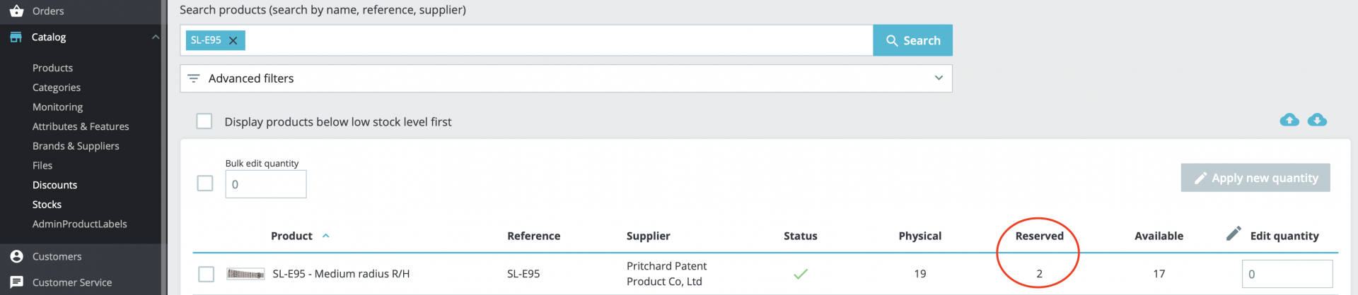

madpugger Posted December 20, 2020 Author Share Posted December 20, 2020 Hi, thanks. Perhaps this will make it clearer: I need to know which order numbers these two reserved items belong to. This item was at: Physical: 0 Reserved: 2 Available: -2 Then some stock came in from the supplier, so I add 19 so it then shows as per the image: Physical: 19 Reserved: 2 Available: 17 It may have been months - or years in our industry since these orders were made, so I need to be able to find who ordered these items easily. I hope this helps to understand! Link to comment Share on other sites More sharing options...

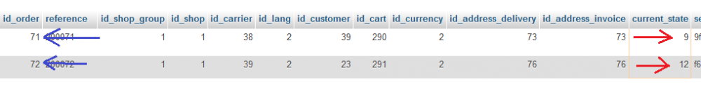

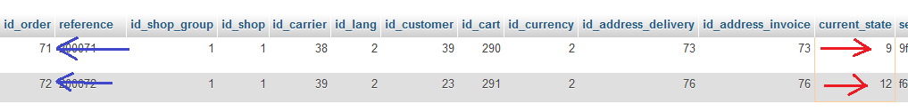

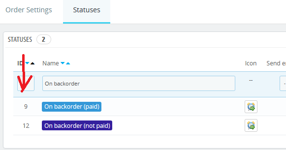

Guest Posted December 20, 2020 Share Posted December 20, 2020 Admin -> Orders Admin -> Order settings -> Statuses So you can find out all orders with status id 9 and id 12 in the database accordingly. For example: SELECT * FROM `ps_orders` WHERE `current_state` IN (9,12); Result: Now you know which orders have the status on the backorder. And now it is no longer a problem to find out which products are not in stock. SELECT a.`id_order`, b.`product_id`, b.`product_attribute_id`, b.`product_name`, b.`product_quantity` FROM `ps_orders` a LEFT JOIN `ps_order_detail` b ON (a.`id_order` = b.`id_order`) WHERE a.`current_state` IN (9,12) AND b.`product_quantity_in_stock` < 1; Result: And that's about all I can advise you. Link to comment Share on other sites More sharing options...
