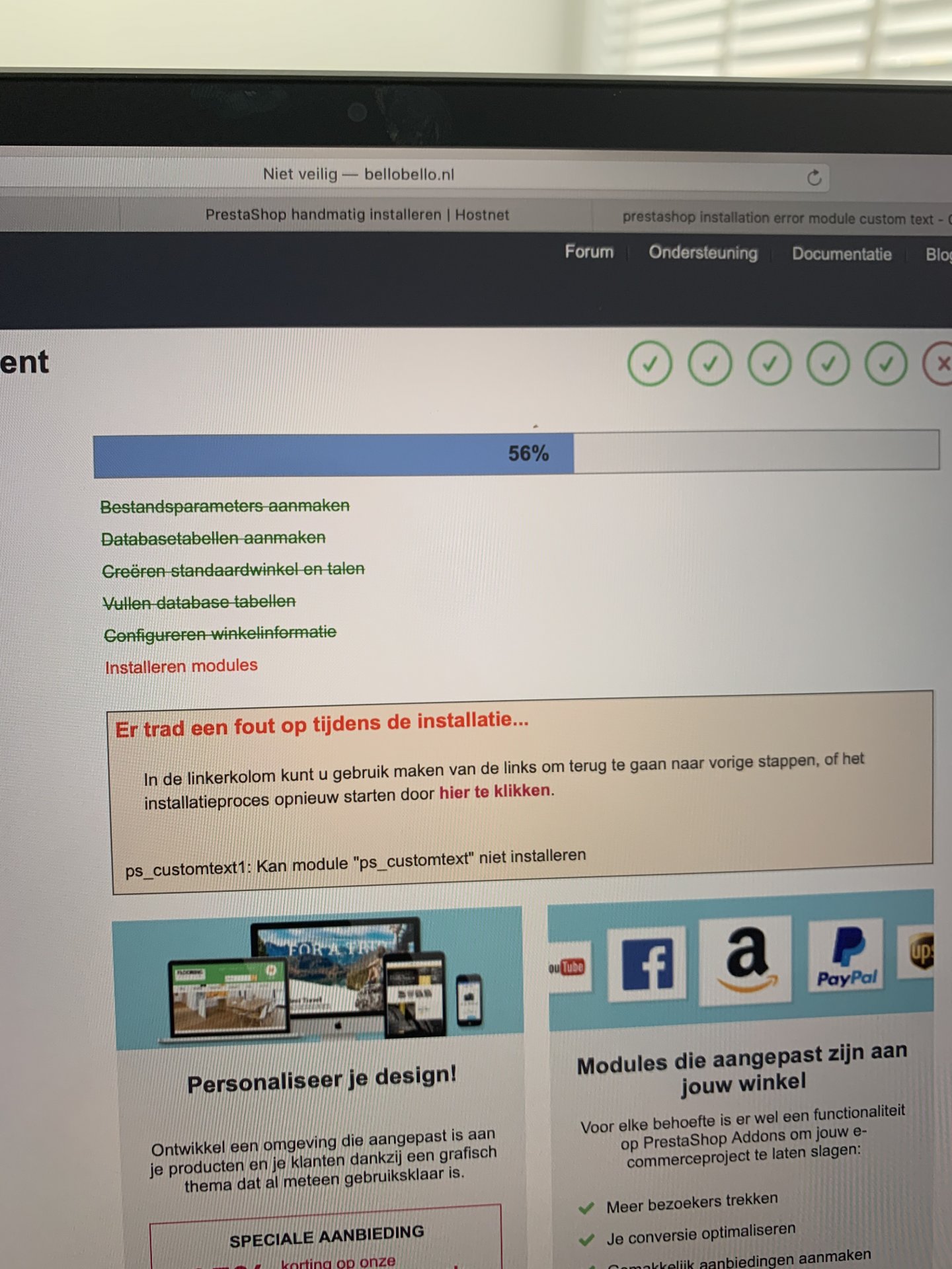

Meryemeloo Posted November 12, 2020 Share Posted November 12, 2020 Hi, I have installed prestashop manually a couple of times and it never gives any problems. now I am getting en error when prestashop is installing at 56% I have tried a couple of new databases and I have also tried a couple of prestashop versions. prestashop 1.6 did install correctly. But 3 versions of prestashop 1.7 give the exact same problem. I have also asked my hosting (hostnet) but they say that they can not see anything wrong. can someone please help me out? Thank you Link to comment Share on other sites More sharing options...
Naaishop Wincy Posted November 27, 2020 Share Posted November 27, 2020 I have the exact same issue... Judging by the screenshot, you're also Dutch or Belgian. I'm also running the installer in Dutch (though I don't think that should be the source of the problem). Link to comment Share on other sites More sharing options...
