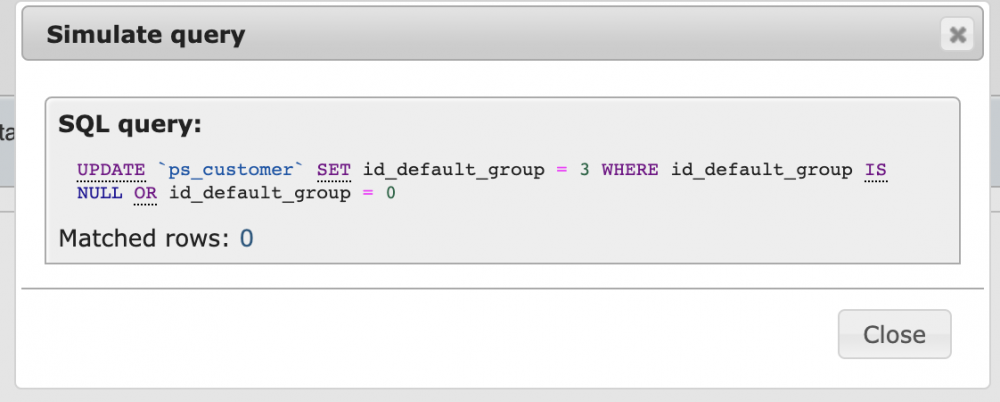

cogeanumarius Posted November 9, 2020 Author Share Posted November 9, 2020 44 minutes ago, Knowband Plugins said: Through admin, Its not possible. If you want to update the group id to all the customers in the DB, then simply run the following query in the DB. UPDATE `ps_customer` SET id_default_group = 3; OR RUN the below query to update the group of the those customers which is not having the default group UPDATE `ps_customer` SET id_default_group = 3 WHERE id_default_group IS NULL OR id_default_group = 0 ; first query worked like a charm, and I have verified a couple of the clients, it really worked, the second query may need some adjustments, I simulated the query and found no records Link to comment Share on other sites More sharing options...

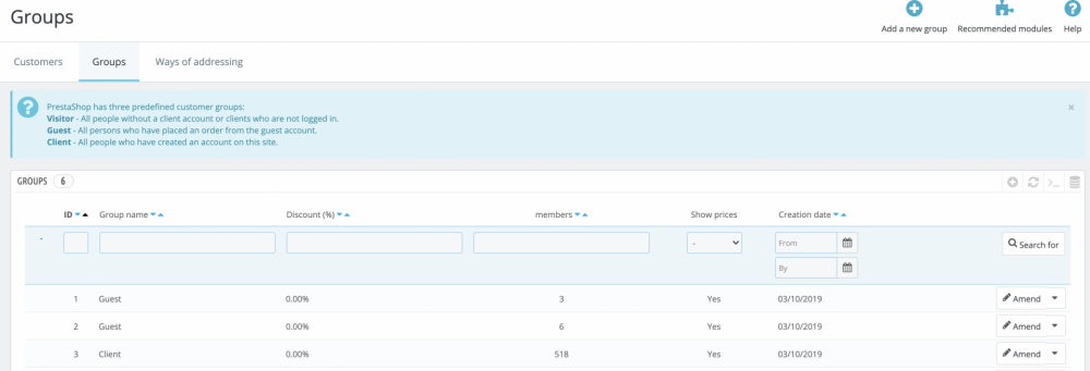

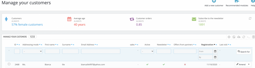

cogeanumarius Posted November 16, 2020 Author Share Posted November 16, 2020 (edited) Thank you for all your help, but looks like out of 1233 clients only 518 are in the default Access Group Clients as can be seen in the attached images is there a way to fix this situation and to have all 1233 in the group Client. yours, Marius Edited November 16, 2020 by cogeanumarius (see edit history) Link to comment Share on other sites More sharing options...
