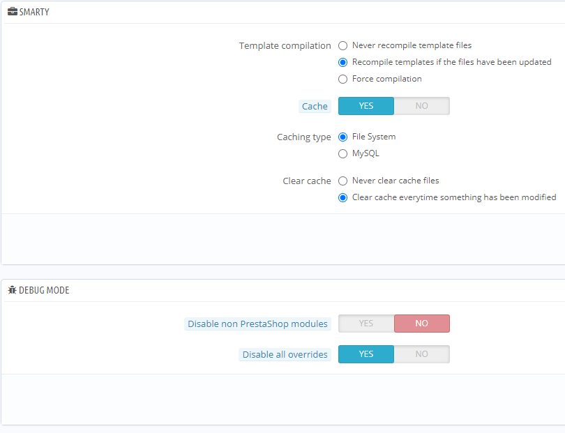

kavenaghi Posted November 3, 2020 Author Share Posted November 3, 2020 I enabled the debug mode and then trying to disable the overrides but found that they are disabled. The screenshot shows how I find the overrides option in BO. At the moment debug mode is active so I hope you will have time to look again. Link to comment Share on other sites More sharing options...
MichaelEZ Posted November 3, 2020 Share Posted November 3, 2020 (edited) Hmm, its rly hard to tell whats wrong like this, i see no changes. Classic checkout is doin same thing (5 step)? When did it stop working? I woud try upload default templet file for opc or address im not sur im not using opc (leaving from work-gona check from home) (i didnt see post with Knowband module - this will be cuilprit imho - unsitall it ) Edited November 4, 2020 by MichaelEZ (see edit history) Link to comment Share on other sites More sharing options...
